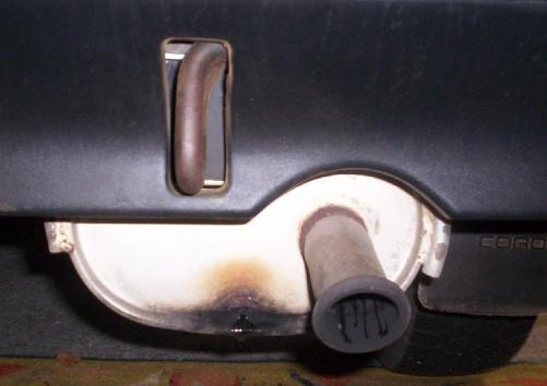

hey i don't really know too much about exhausts/mufflers and i was just wondering if this tiny hole in the muffler is supposed to be there? ive seen another ae82 with the exact same hole so idk. my mate and i were thinking just a small tac weld to cover it up?
anyway just thort id ask to see if anyone has any idea..

Nope, its rooted. As soon as you try to weld it you'll most likely make a bigger hole as the metal will be very thin due to the rust.
Quite a common occurence, condensation builds up overnight inside the exhaust and then pools up in your muffler, rusting it out.
Well, the hole is only gunna get bigger so replace it once you can hear a noticeable difference. Its only a 15 minute job for any exhaust shop, most expensive part is going to be the replacement muffler.
Or, you can whack one of those shiny ones from Autobarn on there cos they're cheap, but people will probably laugh at you :P
