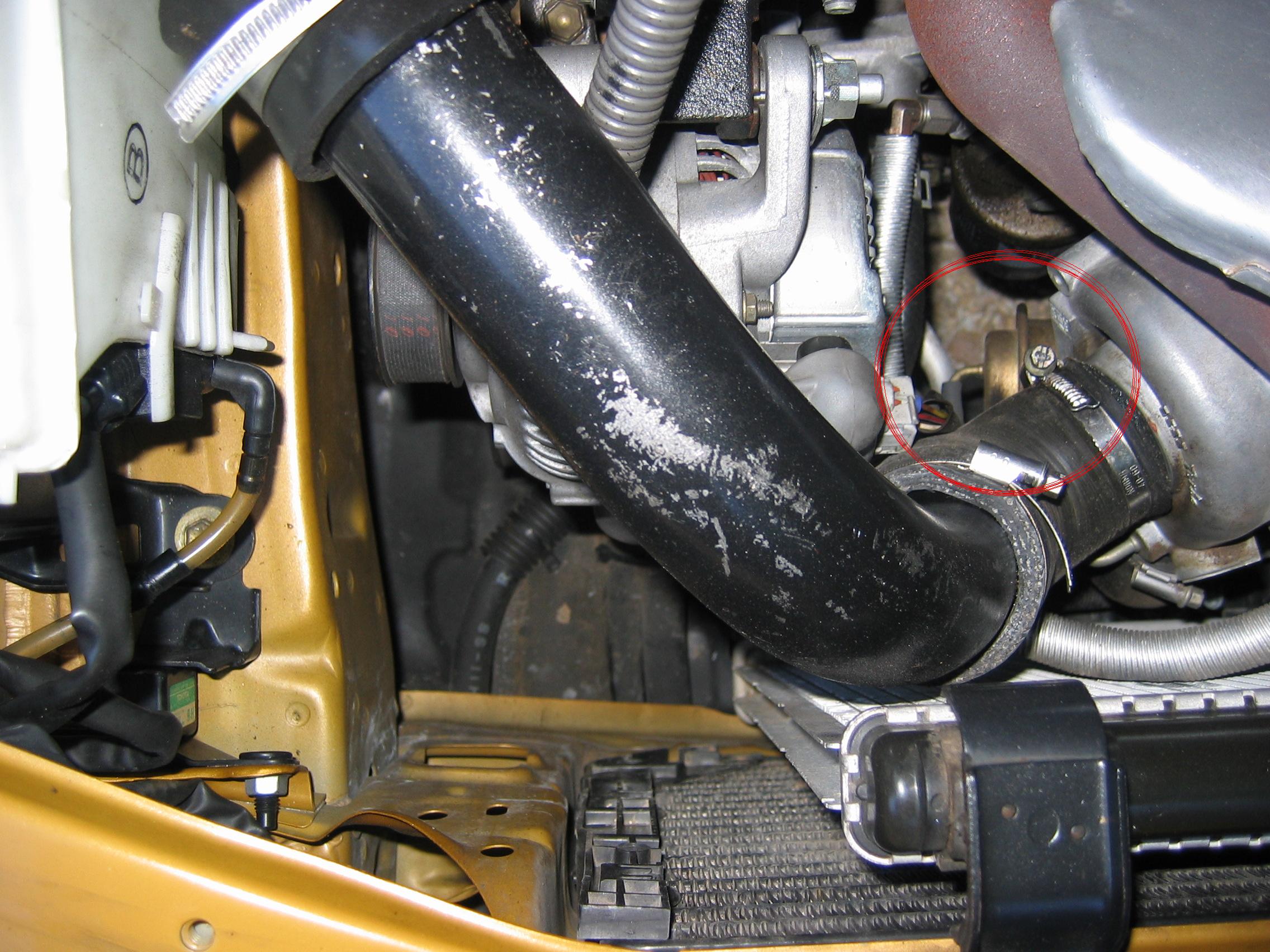

Trev Posted June 19, 2007 Report Posted June 19, 2007 Check to see if the wastegate actuator is still connected on the turbo, I had 1 of my turbo's shit itself and it wouldnt do anything until around 4,000 rpm, Is yours not making any boost at all? Quote
SoulSearcher Posted June 19, 2007 Author Report Posted June 19, 2007 none boost at all, I revved it up to 4000 rpm and nothing... Ok, now just so you know, I'm a chick and I don't know what the wastegate actuator is.... what's it look like? Lesley :jamie: Quote
Trev Posted June 19, 2007 Report Posted June 19, 2007 It sits on the side of the turbo, Did you drive it to check for boost as a turbo will only be efficient when under load. Quote
SoulSearcher Posted June 19, 2007 Author Report Posted June 19, 2007 I drove it, I could't hear the turbo spooling up, and the engine sounded quieter, the exhaust sounded quieter, it was weird, like you're driving with headphones on and you can only just hear ... when I put my foot down the engine was REALLY unresponsive...NO power!!! Usually I zip all over the place, now it feels like I'm going at a snails pace... also, I don't think I have one of those, the only thing near my turbo is the air intake pipe (which was cold - weird). I'm taking it to Toyota this morning - hopefully it's something simple.... Lesley Quote
ancullen Posted June 19, 2007 Report Posted June 19, 2007 Here is the wastegate actuator, hidden away down there: Quote
ancullen Posted June 20, 2007 Report Posted June 20, 2007 It's easy when you know what you're looking for and approximately where it should be. Quote
