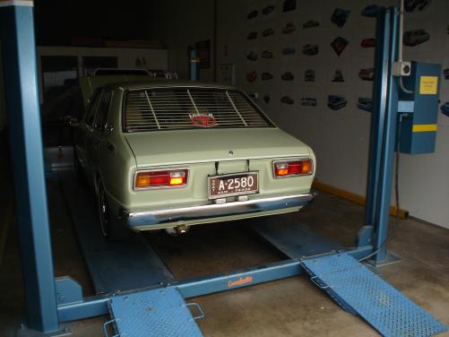

cuzzo Posted August 1, 2007 Report Posted August 1, 2007 hey mr mick. which engineer did you use? I'm looking for a good one. Quote
dookie Posted August 1, 2007 Report Posted August 1, 2007 sex on wheels! good job mate! got the whole car pics, post em up if ya don't mind what he said^^ Quote
radrollaz Posted August 11, 2007 Author Report Posted August 11, 2007 hey mr mick. which engineer did you use? I'm looking for a good one. hi mate i used john from consulmotive engineering in peakhurst sydney, he is an rta prefered signitory. He was very helpful and all up i paid $800.I was suprised how easy it was , i guess i didnt really give him anything to pick on as he's by the book. Quote

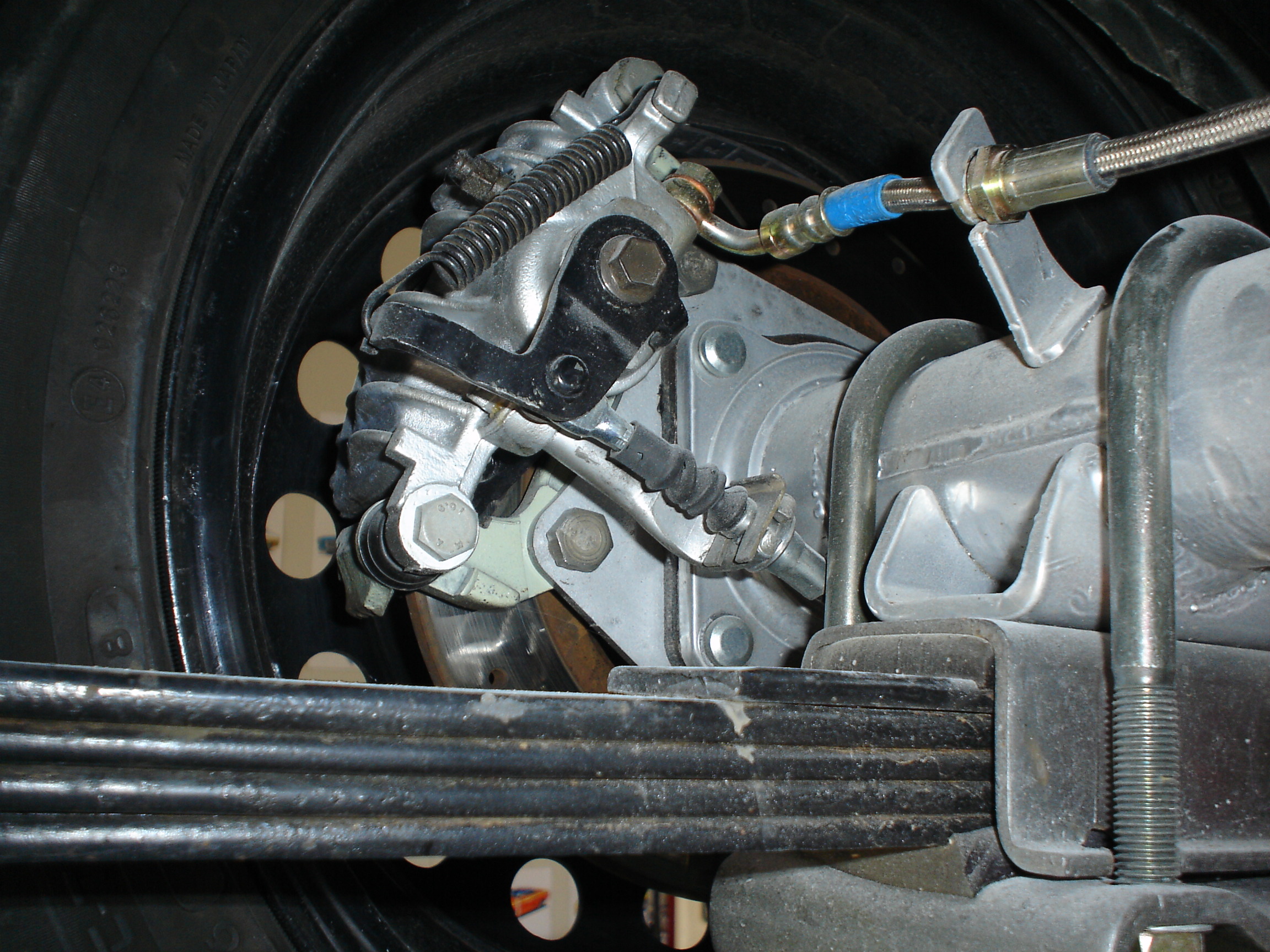

ca18rolla Posted August 24, 2007 Report Posted August 24, 2007 what did you do for the handbrake cables i have the same set up diff and brakes looks like i just need to change the end on the cable. keen 2 see what u did Quote
radrollaz Posted August 26, 2007 Author Report Posted August 26, 2007 what did you do for the handbrake cables i have the same set up diff and brakes looks like i just need to change the end on the cable. keen 2 see what u did Hi mate , i took 1 set of r31 cables and 1 set of ke30 cables too a guy in sydney who does custom cables, he told me to meassure the difference in cables when in the car. if you put the r31 cables against the originals you can then see the difference in length try and mesure properly as if you don't they might be to long and wont work properly. Mine don't fit properly and the hand brake only just works. sorry i couldnt be more help Quote

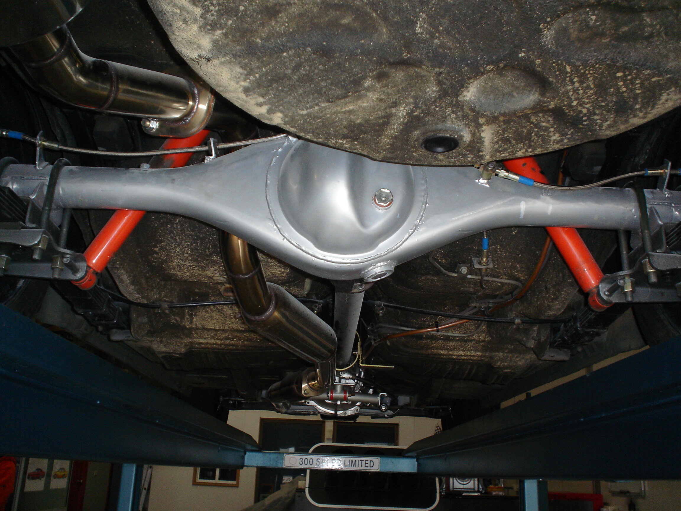

Badger Posted August 27, 2007 Report Posted August 27, 2007 lookin good man how much did the diff and brake set up set ya back? lookin at doin the same in my 2 door. Quote
ca18rolla Posted August 29, 2007 Report Posted August 29, 2007 (edited) Mine cost as per the following though you can run a open face or locker and save $990, I choose not to run a hilux lsd as the sell for $600 and are shit! rn10-13 diff tube and axles $300 Hilux centre $300 Detroit lsd centre $990 R31 disc brake conversion $250 Adding rolla spring mounts $135 bearings/rebuild $250 Total $2,225 Edited August 29, 2007 by ca18rolla Quote

radrollaz Posted August 31, 2007 Author Report Posted August 31, 2007 lookin good man how much did the diff and brake set up set ya back? lookin at doin the same in my 2 door. Hi mate , i was lucky and got the diff already cut down to suit corolla all i did was disc brake conversion which was about $500 because i got new gold series rotors and got brakes recod. To do it properly at least $2000 if not more depending what you get done. craft differentials in granville sydney can help with prices. Quote
