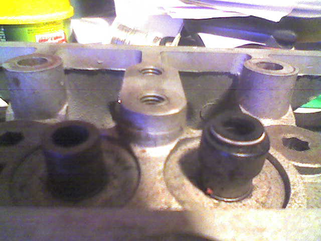

camerondownunder88 Posted June 6, 2007 Author Report Posted June 6, 2007 So if you can confirm Felix below is the valve stem on the left an old style and on the right a new style? Or is the one on the left a new style just minus the rubber top and spring? As the one on the left is more of a straight shaft with a rounded in part to say it the best section near the top of the stem while the other right one is a straight shaft with a larger diameter top section and no rounded in section. Cheers Cameron Quote
Felix Posted June 6, 2007 Report Posted June 6, 2007 Your pic is not real clear. Looks to me like the later style guides, which have a groove to which the valve stem seal clips on. On the left the valve stem seal has been removed. The valve stem seal is still present on the right. Quote
