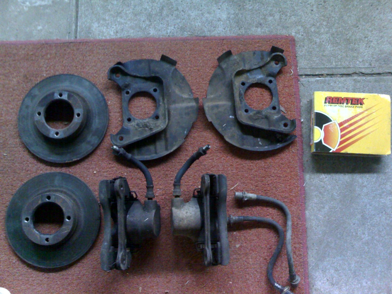

camerondownunder88 Posted June 5, 2007 Report Posted June 5, 2007 JC807 KE15 disc's are the same as KE20 from what I can see comparing my KE15 brakes to a KE20 brakes. Also KE55 brakes wont fit on a 12 inch rim you will need 13 inch rims des. Cheers Cameron Quote
Des Posted June 6, 2007 Author Report Posted June 6, 2007 Brakes arrived today, Did a test fit but i need to get new bolts for the calipers and hubs. Quote

Des Posted June 6, 2007 Author Report Posted June 6, 2007 *Slaps 7shades* Just need to get the rotors machined, Get new wheel bearings, Lancer master cylinder and put it all together and i will be happy with the braking side of things. Going to replace the rear bearings too. Then its on to the suspension. I'm thinking of just going with KYB excel G dampers to suit Ke30 struts and using the spacer as shown in this thread. Ke20/30/55 inserts to ke10 struts. And Custom king springs, Because i want the car to be really low i will probably need a much higher spring rate spring than the stock springs to stop it bottoming out. For the rear i was thinking of Flipping the top spring and inverting the mounting eyes and adding 1 more leaf to get some more stiffness out of it. Again with KYB excel G dampers. Will be replacing all bushes and ball joints as well. Suggestions on suspension from people who have had some experience are welcomed ? Quote

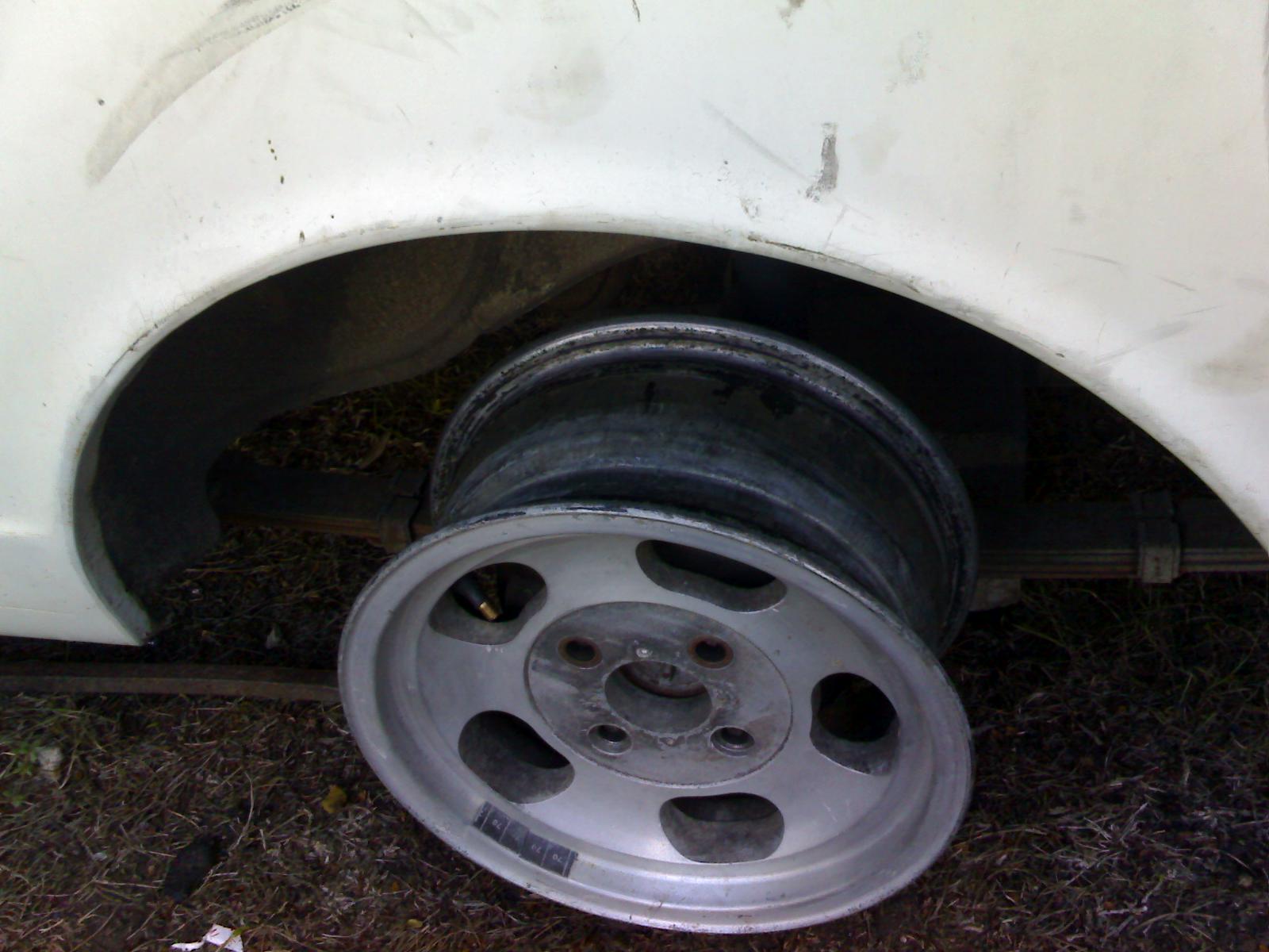

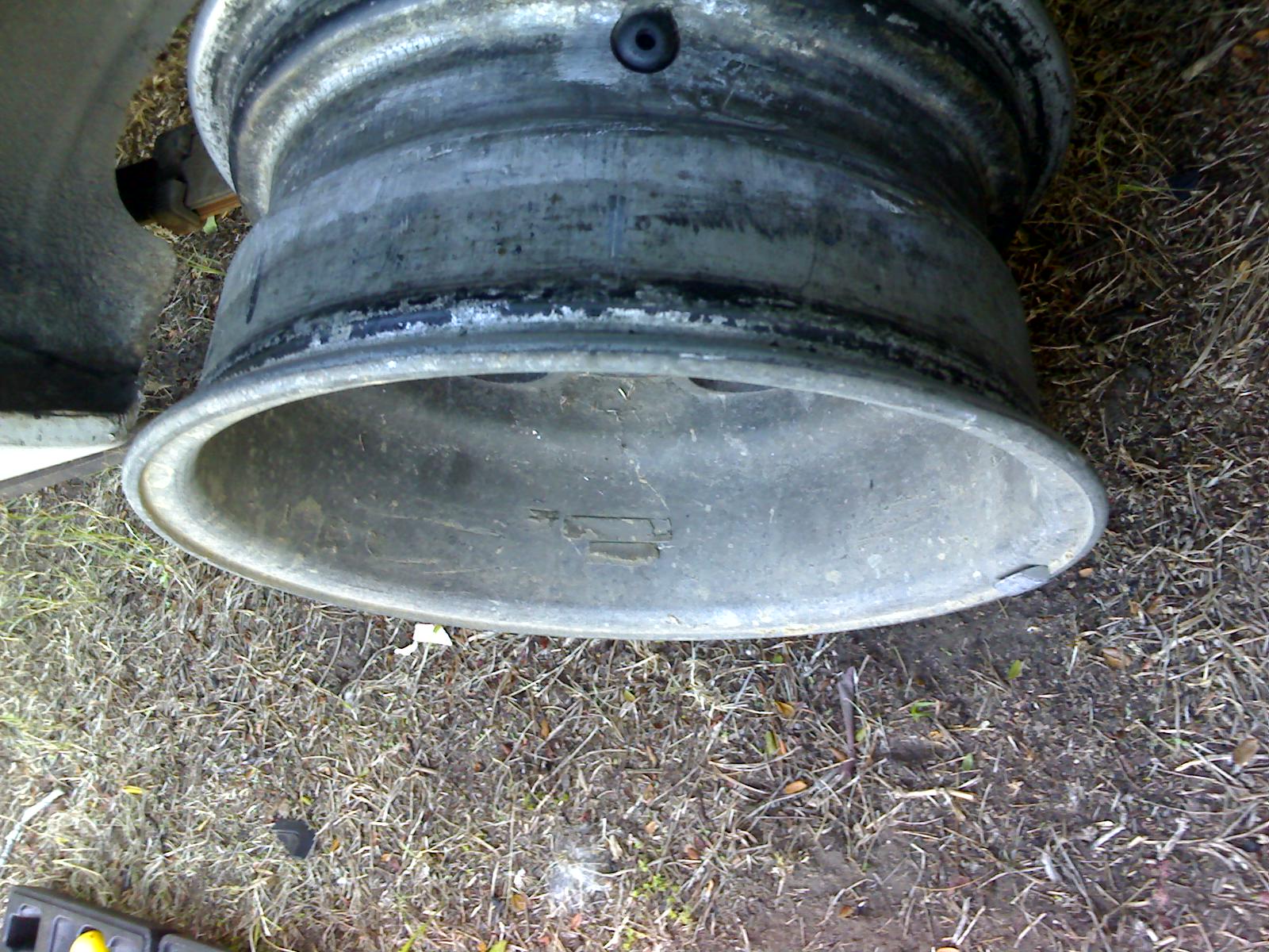

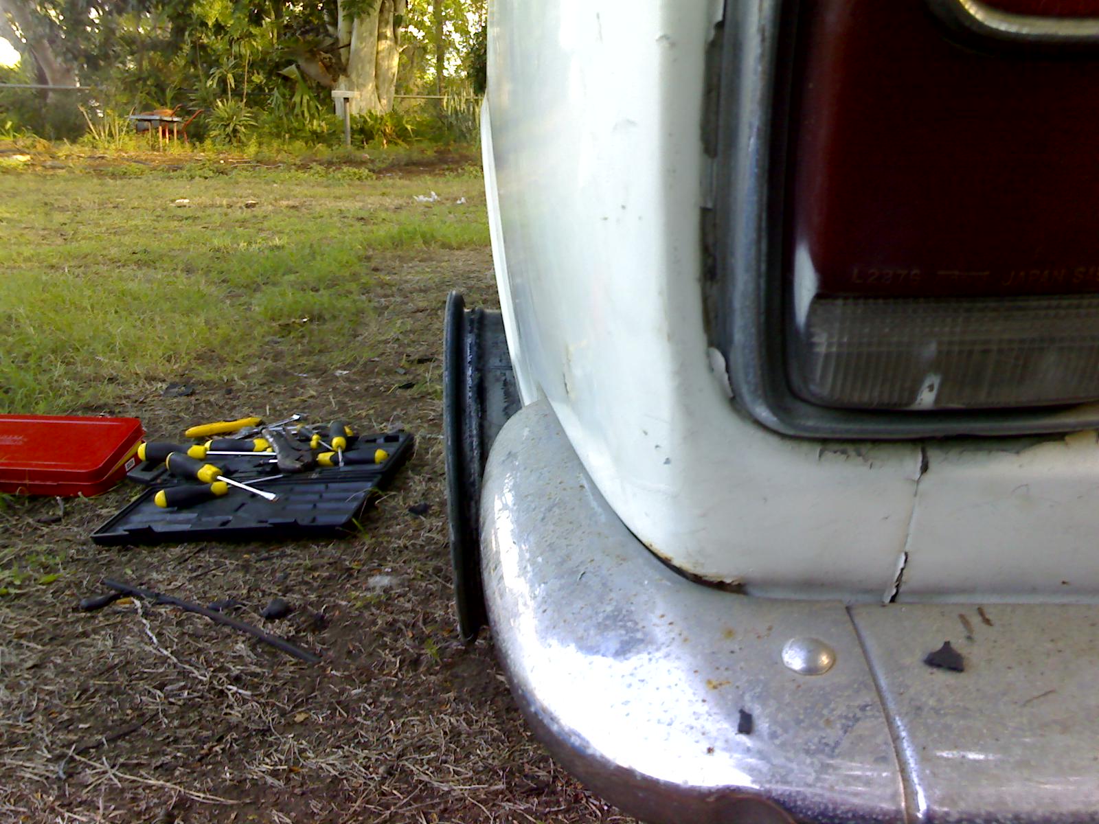

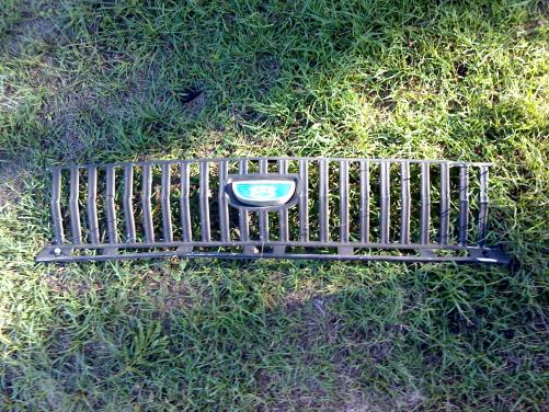

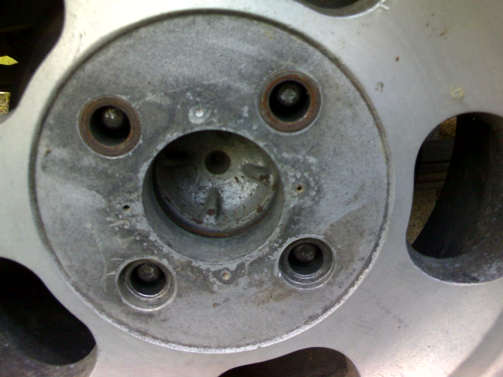

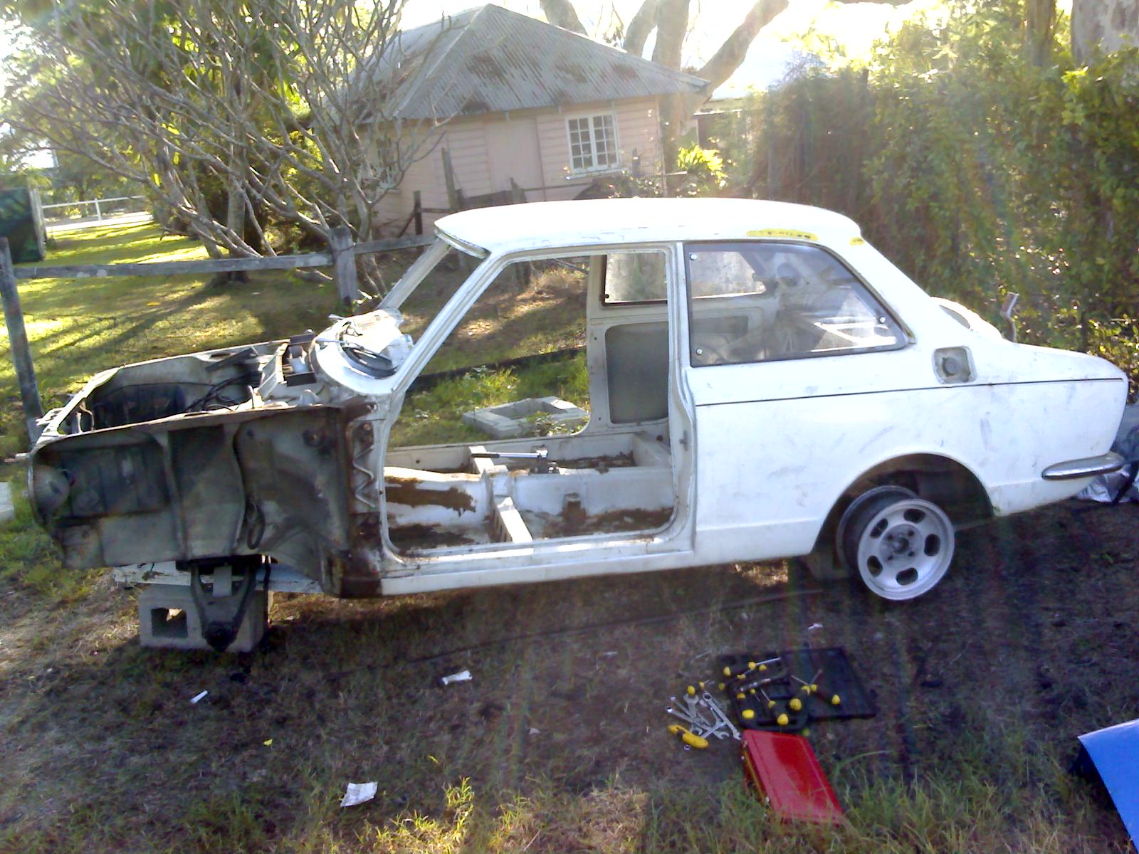

Des Posted June 15, 2007 Author Report Posted June 15, 2007 Spent about an hour outside today. I need longer studs. 13" alloy jelly beans Will be running these for a while. Grille. 18 rims and tires, 14 of them fit my Corona ;) Yup Inverted jellybeans = dish and loads of negative offset but not safe. I'm sure this isn't legal Quote
