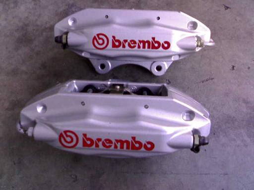

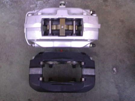

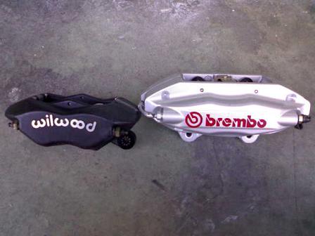

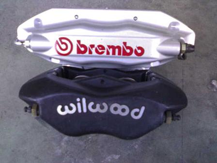

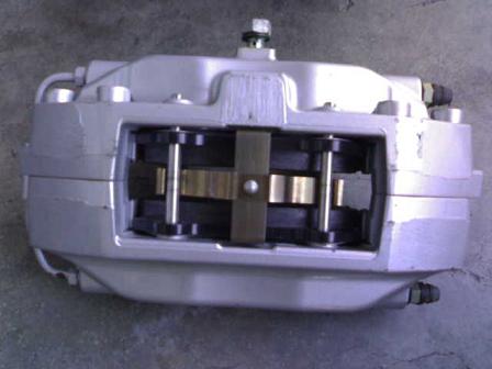

radrollaz Posted May 2, 2008 Author Report Posted May 2, 2008 Hi just a little update on my brake conversion which i am currently collecting parts for . I was going to use the wilwood 4 piston calipers on the rear and the more i thought about it the more i realised the amount of work and money involved in changeing my current R31 rear disk brake set up to 4 piston and internal hand brake wasn't justified so I'm now concentrating on the front brakes which are currently RA60 celica. My current brake set up stops reasonably well for what they are but lack in the looks department and if i ever get serious with the corolla and race it on the track like i want to i need big brakes on the front. So cause I'm not changing the rear i thought , hey i might aswell go for what i really want and sell up on the wilwood idea and go for some Brembo's . :cool: The only downfall with fitting these brakes is that i will no longer be able to fit my 15 chasers on the front and will be forced to fit aftermarket wheels, which will sadly do away with the whole sleeper theme. ;) Here are a few pics of the brakes . Quote

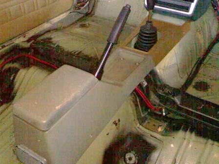

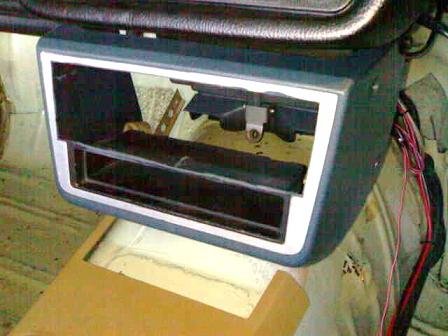

radrollaz Posted May 2, 2008 Author Report Posted May 2, 2008 (edited) I've also recently started fitting a Ke70 console as I'm sick of haveing no place to put my phone, wallet, etc. I had to chop a little off the centre section around the gear stick ass it didn't line up with mine as its further back, also ill be fitting s few gauges in the console under the fan control so it should turn out good, hopefully! Next on the cards is to spray it black and make a gearsick boot aswell as one for the hand brake and ill finally have a little storage space for those long cruses. ;) I also bought the corolla a little beanie to keep her brake fluid warm in winter :cool: I also hooked up a spare bonnet from marty k , which i will be using as my race bonnet and cutting some holes into to fit vents in to let all that nasty heat out, its even the same colour. :dance: Edited May 2, 2008 by radrollaz Quote
