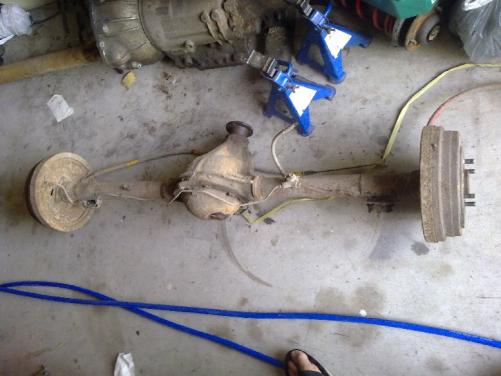

JiP Posted November 1, 2009 Author Report Posted November 1, 2009 Not much of an update but where we go anyway... Â Bushes came in... Â Been working on the diff. Before... After... Still need to work on the brake lines. Quote
camerondownunder88 Posted November 1, 2009 Report Posted November 1, 2009 Hard to tell by the photos but did you paint the inside off the diff the gears and all??? Â Tell me you didnt Quote
JiP Posted November 1, 2009 Author Report Posted November 1, 2009 I did no such thing dumb dumb. I don't do silly things like painting gears and gluing metal bits together :( Quote

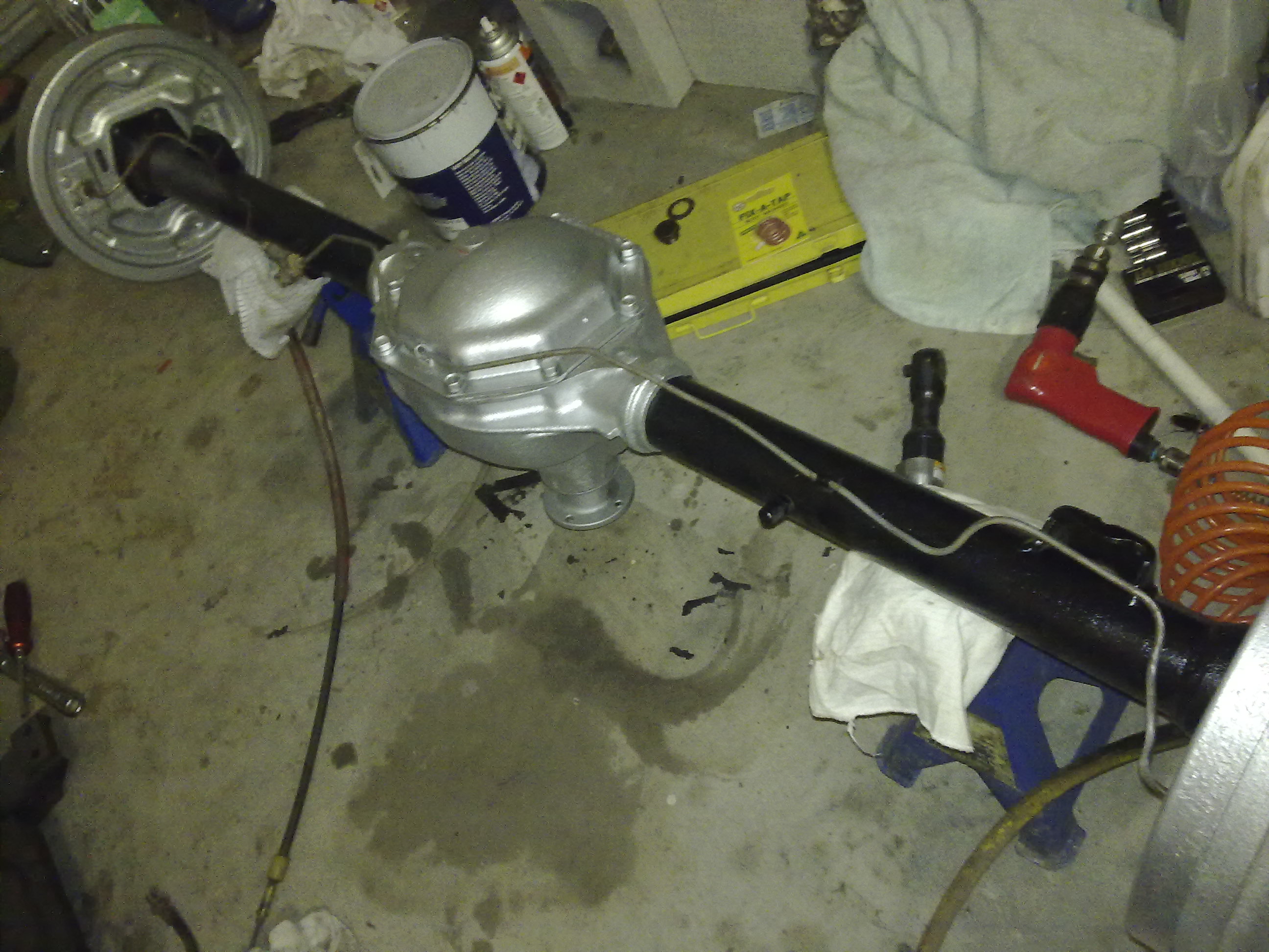

JiP Posted November 4, 2009 Author Report Posted November 4, 2009 Okay small update. Â I've had to go out and find a new washer for my filler plug. I wanted a new one anyway. Problem was I couldnt find any at all the major part stores as the bolt is too big. I had to instead go to Bunnings and grab this... I've decided to grab spring washers for the bolts that hold the backing plate one. I want to ho have extra strength as I've noticed these diffs always leak behind the gasket. I've also bought gasket glue that has a resistance to oil. And here is is now. Tonight or tomorrow I'll top up the oil then give one last coat of paint over the bolts to clean it up. Â Â Just need to clean up the brake line and re attach it now. Quote
love ke70 Posted November 4, 2009 Report Posted November 4, 2009 for future reference, an easier alternative to using silicon type sealant for those gaskets, is to use non-hardening aviation sealant, quicker cleaner and easier to apply, and probably works better, just brush it on, cause its liquidy, and it never leaks. keep an eye out for it :) Â good progress being made, good to see youve focused your efforts :) Â wish i was making progress haha Quote
JiP Posted November 4, 2009 Author Report Posted November 4, 2009 Well I've now topped it up and sprayed the bolts. Fingers crossed it works out well. I've also polished the brake line. Doesn't look too bad. I'll fit it tomorrow. Â I hope by Saturday I'll have the sound deadening complete under that section so I can re assemble the back end. I really don't feel comfortable with her ass up in the air and only bricks chocking up the front wheels considering the slope of the driveway/dirt. Quote

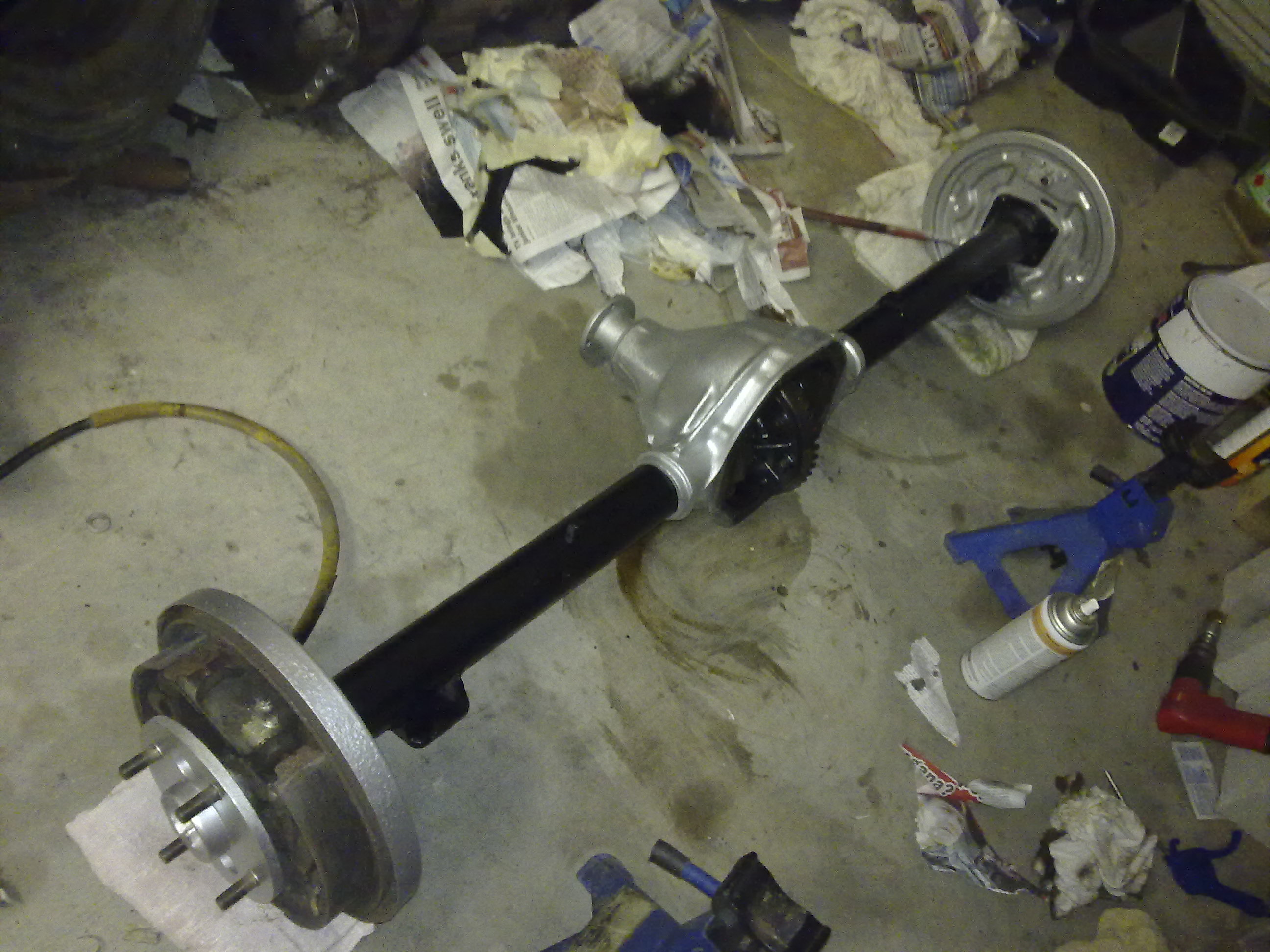

JiP Posted November 4, 2009 Author Report Posted November 4, 2009 Just fitted the brake line that I sanded the rust off and polished... Quote
