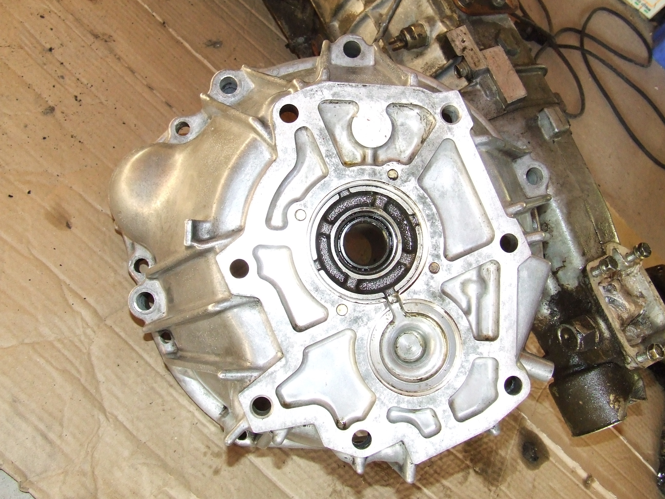

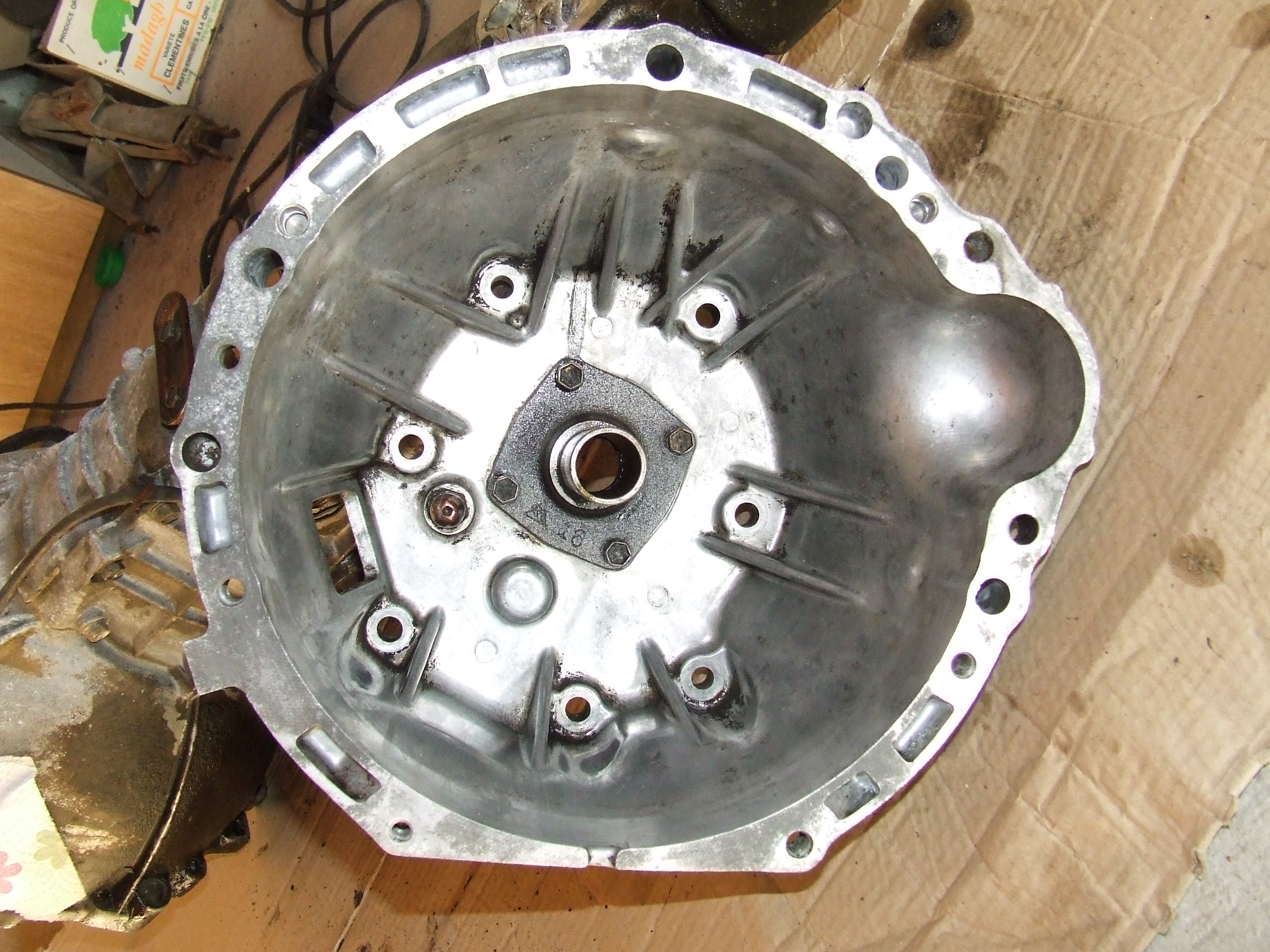

tojo2 Posted May 2, 2007 Report Posted May 2, 2007 (edited) K to T bellhousings from early ke35 ( pre mid76 ) t50 came with wire clutch. The one in the photo might be one of those, as it does not have a raised stand for the pivotball just inside the forkhole, like mine does . Also , the forkhole is in slightly different position and I don't have the sqare hole on the top. I belive mine is out of a ke74, but will never know for sure. Edited May 2, 2007 by tojo2 Quote
tojo2 Posted May 2, 2007 Report Posted May 2, 2007 Took a couple of photos of my k to t for comparing. Quote

madrolla68 Posted May 3, 2007 Report Posted May 3, 2007 Took a couple of photos of my k to t for comparing. Thats a hydraulic one ey!!!!!!!!!! Quote
tojo2 Posted May 3, 2007 Report Posted May 3, 2007 (edited) Thats a hydraulic one ey!!!!!!!!!! Yes. mine is a hydraulic one and suits the late big bearing t50 (ae86 ta60 ) One from a early ke35 would fit a early small bearing t50 ( ta22 ) http://www.toymods.net/forums/showthread.p...p;highlight=t50 Edited May 3, 2007 by tojo2 Quote
