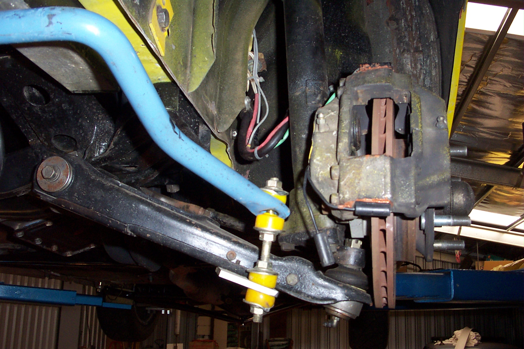

ancullen Posted May 2, 2007 Report Posted May 2, 2007 After having rear discs brakes on my 1989 Mitsubishi Galant which incorporated the handbrake, I've always been wary of disc handbrakes. I know someone with an FTO with the same problems, but I don't know if it's a disc handbrake thing or a Mitsubishi being a piece of shit thing. Quote
