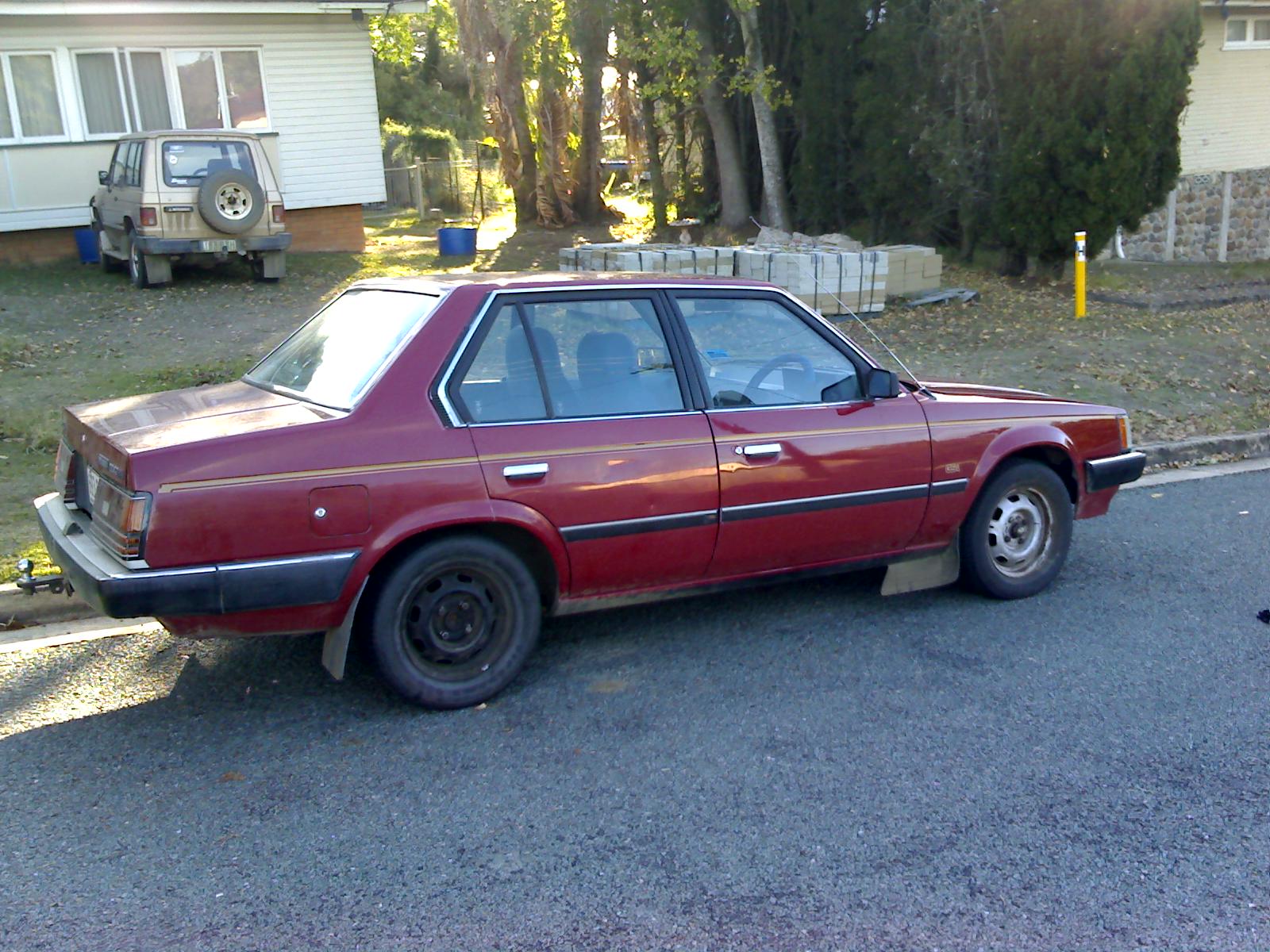

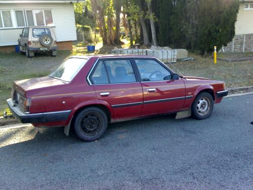

Des Posted July 8, 2007 Author Report Posted July 8, 2007 Well its been back on the road for a little while now on the stock heads etc. Got a set of spare VP heads to rebuild, Graphite Gaskets, VP inlet manifold for twins. The Corona's new look. Quote
