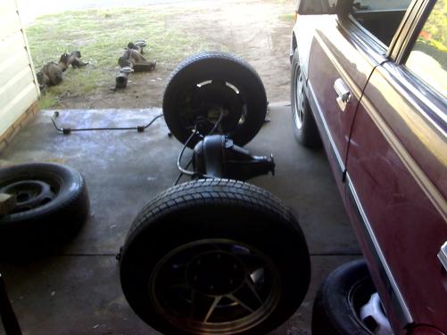

Des Posted June 21, 2007 Author Report Posted June 21, 2007 The Corona sounds awesome when its bouncing off the limiter :jamie: Ive picked up a spare pair of VP heads and I'm going to get them rebuilt which is about $600 with all new valves etc. Once that is done I'm going to get them shaved down to get about 10.0 or 10.5:1 Compression ratio. Since the heads will be shorter I'm wanting different ratio rockers to get a bit more lift out of the valves. Remove the balance shaft. I'm thinking about twin throttle bodies but they will be sticking through the bonnet with exposed filters in which i would need a bonnet scoop to be remotely legal, And of last but not least custom extractors. Get the T700 rebuilt with a 1500 - 2000 rpm stally, Shift kit between 1st, 2nd and 3rd as there is no point in kitting over drive as it wont go in over drive with the pedal to the metal anyway. see if they can remove the locker clutches as well coz they don't get used now and wont be used ever again so why not remove them if possible. Thinking of getting a VP diff shortened down etc and fitting a LSD, estimate price is about $1800 for that but i could get a hilux diff done for the same price if not cheaper. With those engine mods i would be happy with 260hp and at least 400nm of torque and still be street able and nice to cruise around in. Thoughts ? and if you say V6's are shit and i should go 1g or 1j or whatever well you know where you can stick your idea :o Des Quote

NickZ Posted June 23, 2007 Report Posted June 23, 2007 (edited) infact there is a F3000 open wheeler race cars that run the 3.8 commo motor in N/A form making over 300+ HP (Ive seen one advertised claming 370hp) Commo diff ratios start from a 2.78 to a 4.7, i don't know about strength but a commo diff will handle the max power youll ever make out of a V6, I would go the commo diff as all you have to do is shorten it, its already got disk brakes etc and the is no shortage of limited slip diffs, even mini spools are only $80-$90, stick with the 5 stud patern and youll have thousands of wheels to pick from, remember the hilix will need the studs converting too. don't go anything above a 3.7 ratio (eg 4.11,4.3) as the motor is a low down torque monster and its a lighter car than a commo youll be sitting on the rev limiter all the time and not going very fast, you need to load these motors up in our light cars, the commo it came from weight 1400-1550 kg. Edited June 23, 2007 by NickZ Quote
beerhead Posted June 23, 2007 Report Posted June 23, 2007 If you can avoid it, never shorten a diff, the axels are never as strong as factory, and its a waste of money that you could have otherwise spent on beer :P A hilux diff will have as many ratio choices, if not more than a commodore, and they're the correct width. A 2WD hilux will give you a 5 stud, but you're lucky!! You have a corona, just use some cressida 5 stud front hubs, use old school Ford low offset rims!! I can get 20K LSD centre's for hilux's for $500 - 600. You always have the option to go a MA61 factory/ aftermarket too. Quote
