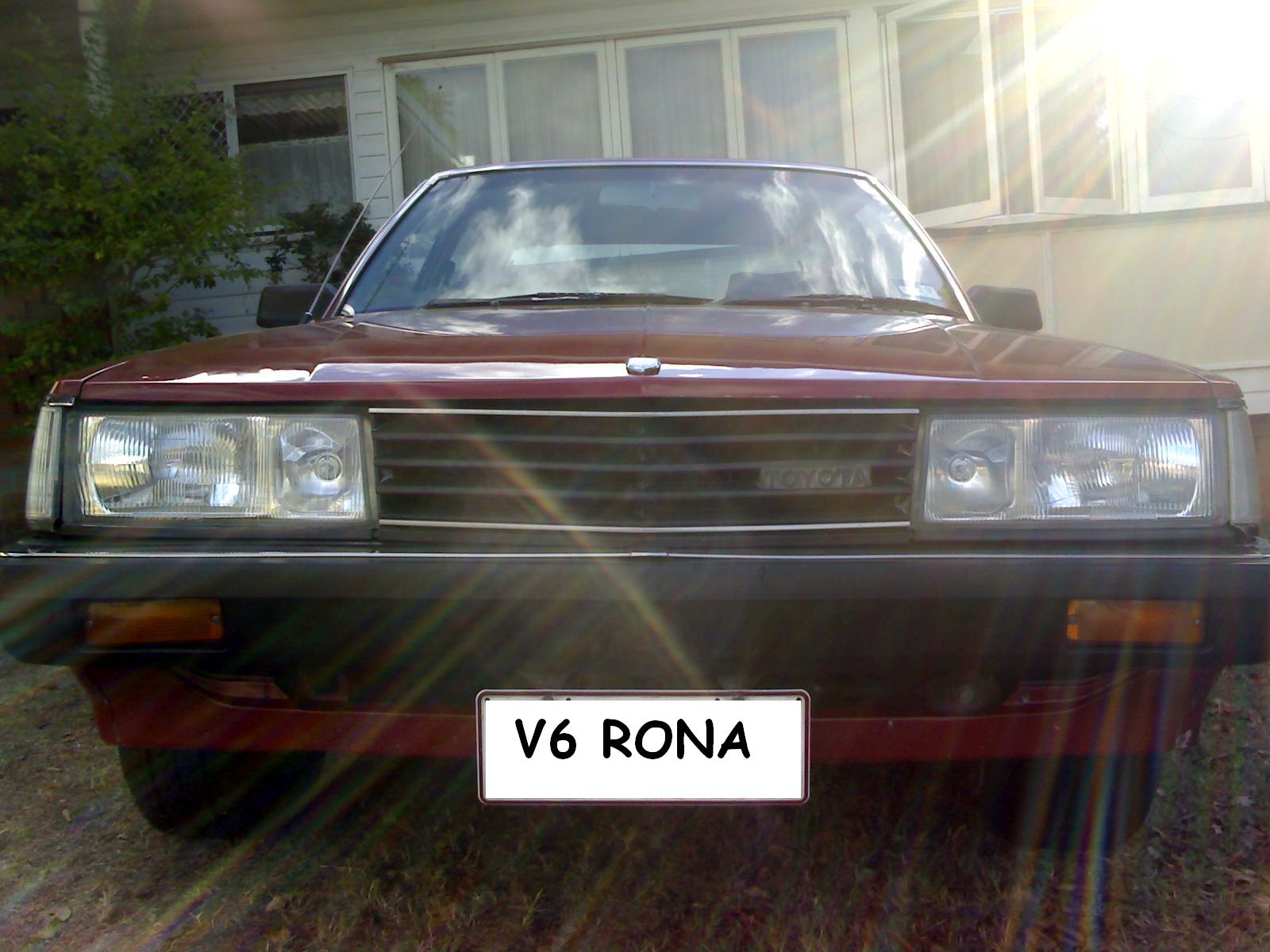

LittleRedSpirit Posted May 1, 2007 Report Posted May 1, 2007 Cool car des. Does it share engine mounts with the ecotec v6?... :jamie: Quote

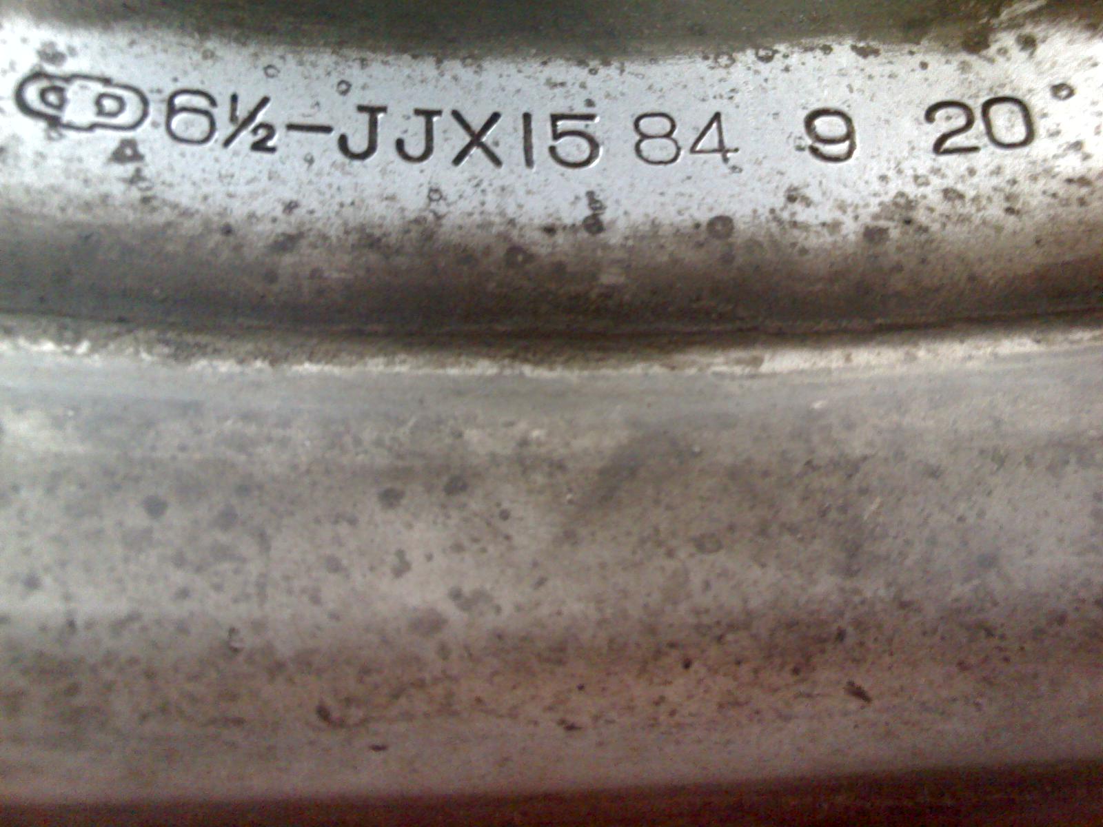

Des Posted May 1, 2007 Author Report Posted May 1, 2007 (edited) I think they do but I'm not 100% on that. I need tires with a lower profile for the fronts, 205/65/R15 is to big for a Corona. Neally takes the 1/4 panel off when ya turn. 205/55/R15 for the front is still reasonable. Edited May 1, 2007 by AE70 Quote
Trev Posted May 1, 2007 Report Posted May 1, 2007 (edited) Cool car des. Does it share engine mounts with the ecotec v6?... :jamie: No need, I have spare 3.8 v6's from Vn - Vp, From owning a vn and a vs i have found that the buick is alot more responsive than the ecotec, Ecotec is based in topend power, Buicks still lead the 1/4 mile times for the commodore v6's (holden stats, vs has more weight but more hp), I personally think the LEXONA has a 14 in it, Other's might say otherwise. Edited May 1, 2007 by Trev Quote

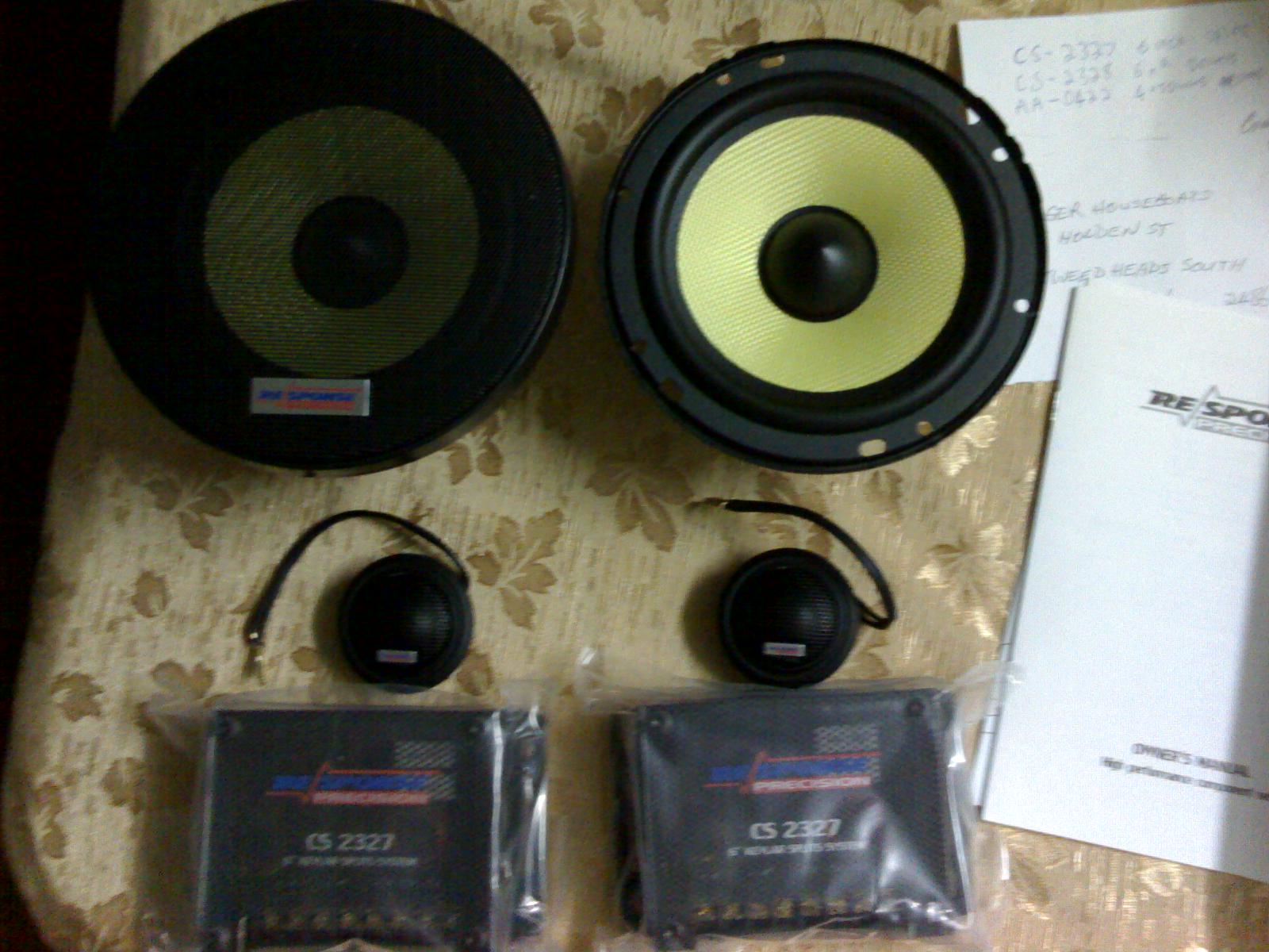

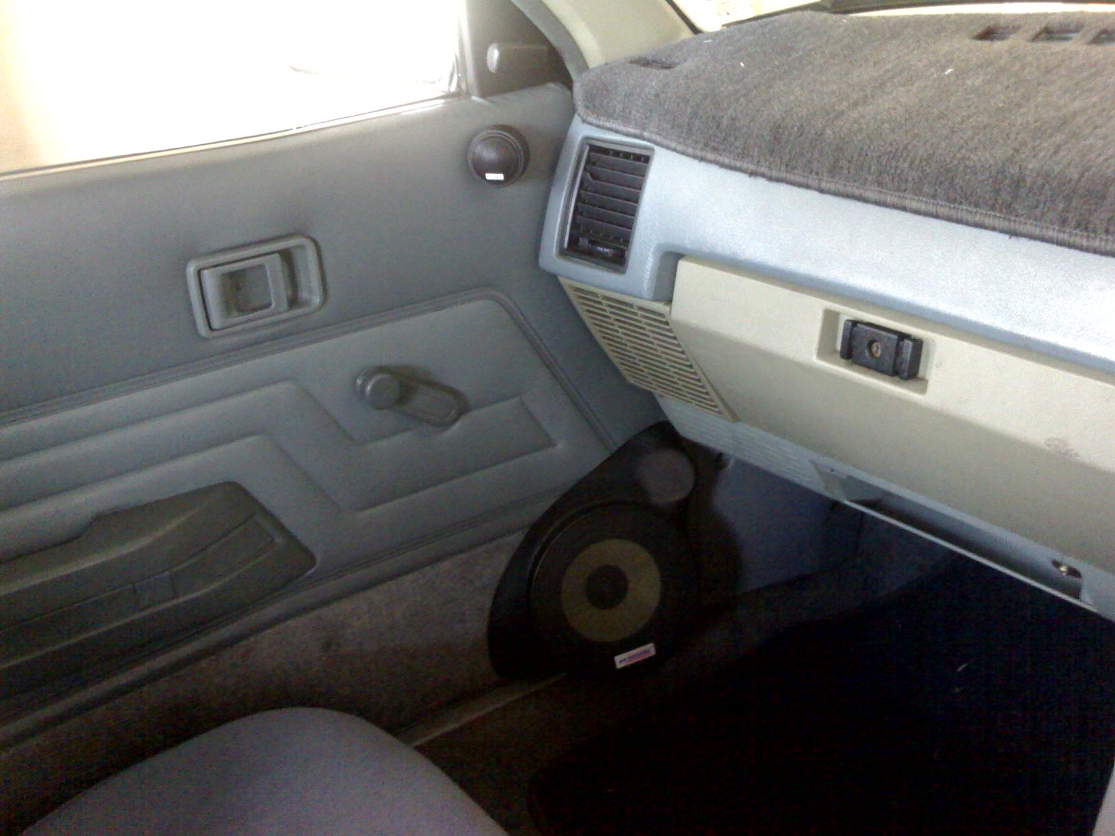

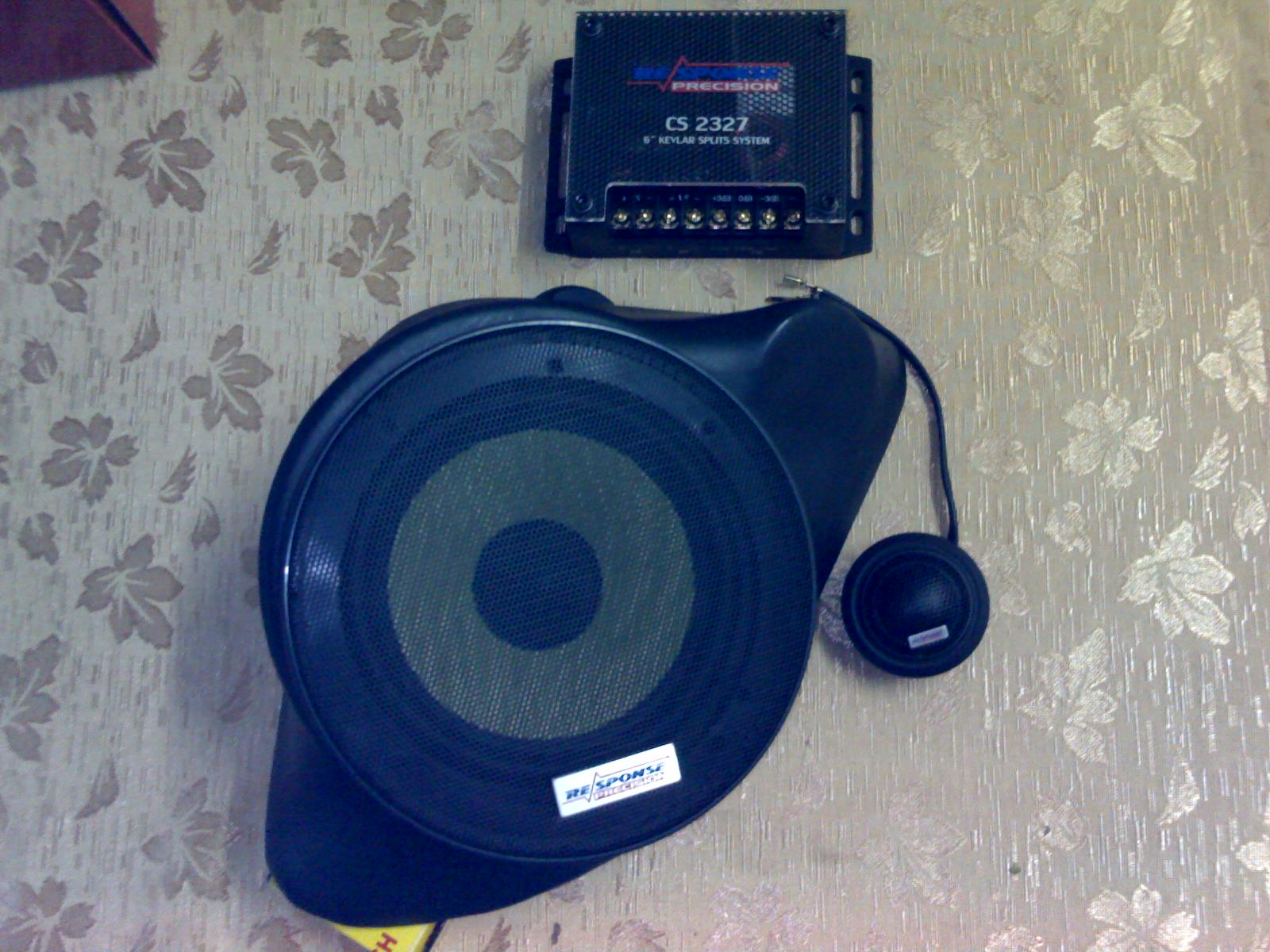

Des Posted May 9, 2007 Author Report Posted May 9, 2007 Bought some decent speakers early last week and some pods today, Fitment tomorrow. Jaycar 6 inch Kevlar splits. Might buy another pair for the rear and then get a 4x50wrms jaycar amp. Quote
Des Posted May 14, 2007 Author Report Posted May 14, 2007 Finished putting the speakers in the front doors and I'm very very happy with them even though they are running from the head unit not a amp. Found a steering lock in the shed aswell :yes: Quote

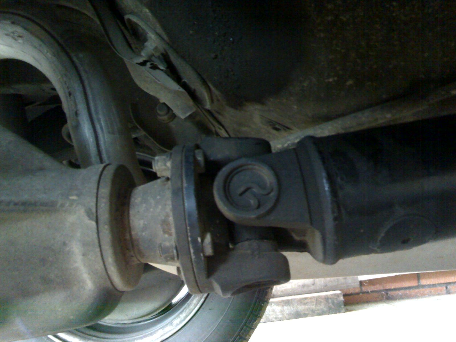

Des Posted May 28, 2007 Author Report Posted May 28, 2007 V8... or supercharged 6 atlest :D One day. Since my last update ive replaced the indercators and the inner driving lights with newer items. Also lined up the lights properly so I'm not Koala spotting now. Custom tail shaft. Melber rims. Quote
