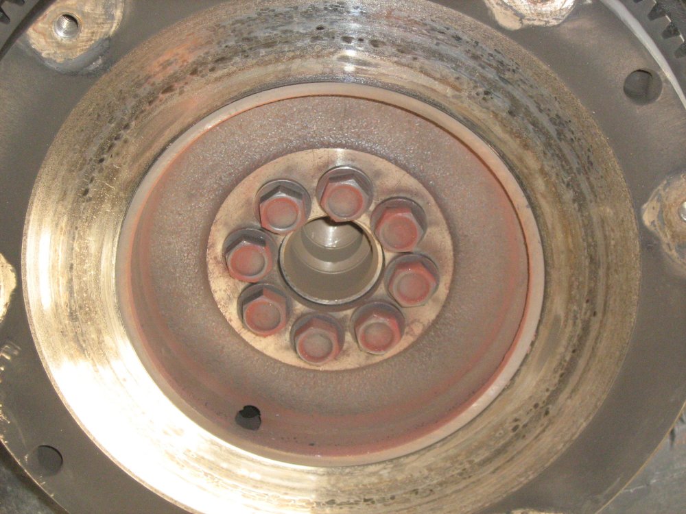

Felix Posted April 17, 2007 Report Posted April 17, 2007 Just a thought, maybe you could use the crank and rods from an earlier bigport 4age? They have the 18mm gudgeon pins like your 4ac. Should give you extra bottom end reliability. You might need to change the flywheel though, I'm not sure but the 4age crank may need an 8 bolt flywheel... Somebody else here who is into 4ages should know. Quote
Trev Posted April 17, 2007 Report Posted April 17, 2007 (edited) Just a thought, maybe you could use the crank and rods from an earlier bigport 4age? They have the 18mm gudgeon pins like your 4ac. Should give you extra bottom end reliability. You might need to change the flywheel though, I'm not sure but the 4age crank may need an 8 bolt flywheel... Somebody else here who is into 4ages should know. That is correct, 4AGE's have an 8 bolt crank, some of the really early JDM AE86's had a 6 bolt and appararently so did the AW11, I was led to believe that all the GEN 1 bigports were 6 bolt but i was wrong. A pic of 1 of my GEN 1 bigports: Edited April 17, 2007 by Trev Quote
tas_ae71 Posted April 18, 2007 Author Report Posted April 18, 2007 Retrospekt Posted Yesterday, 08:49 PM Its the best when people do something different and can't be swayed otherwise. I can't think of much else other than porting and enlarging valves, double valve springs should help you reach the revs you want. Good luck with it, 'agricultural' engines like this sound awesome when worked radically. yeah it is rather agricultural, thanks :y: but thats me, from the getto Just a thought, maybe you could use the crank and rods from an earlier bigport 4age? They have the 18mm gudgeon pins like your 4ac. Should give you extra bottom end reliability. You might need to change the flywheel though, I'm not sure but the 4age crank may need an 8 bolt flywheel... Somebody else here who is into 4ages should know. i am indeed using bigport rods. 4ac crank is heaps lighter so keeping that. less rotating mass=better That is correct, 4AGE's have an 8 bolt crank, some of the really early JDM AE86's had a 6 bolt and appararently so did the AW11, I was led to believe that all the GEN 1 bigports were 6 bolt but i was wrong. A pic of 1 of my GEN 1 bigports: another thing is valve clearence from the piston? the cam is claimed to have a extra .8mm of lift, with a shaved head and (most probaly a thin head gasket .8mm- .5mm) is there going to enough room there? don't want the valves to smash on the pistons and don't want to get them cut out or shit.. how do you do dobble valve springs? do you just put 2 standard springs on the one valve? thanks aaron Quote
