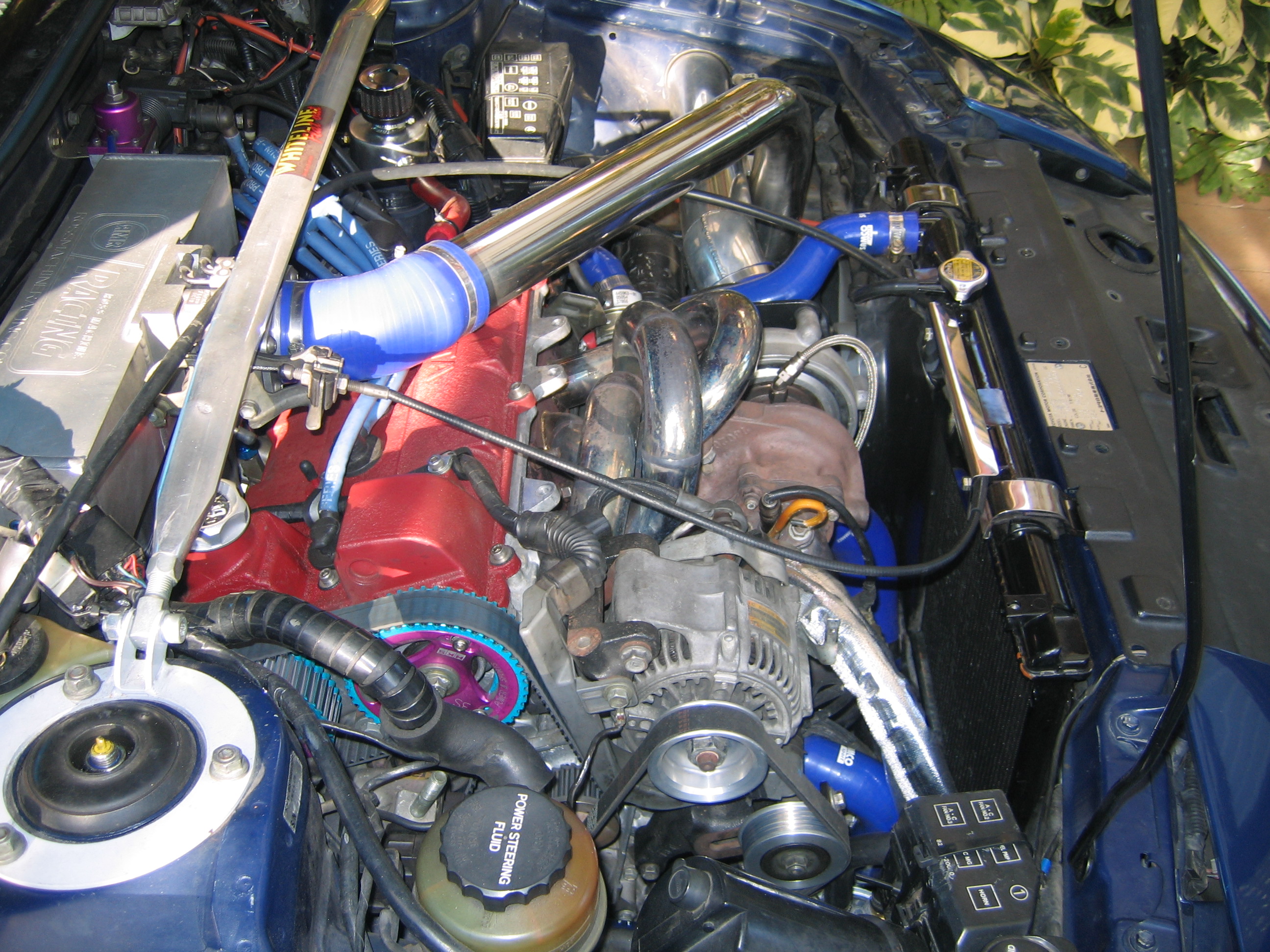

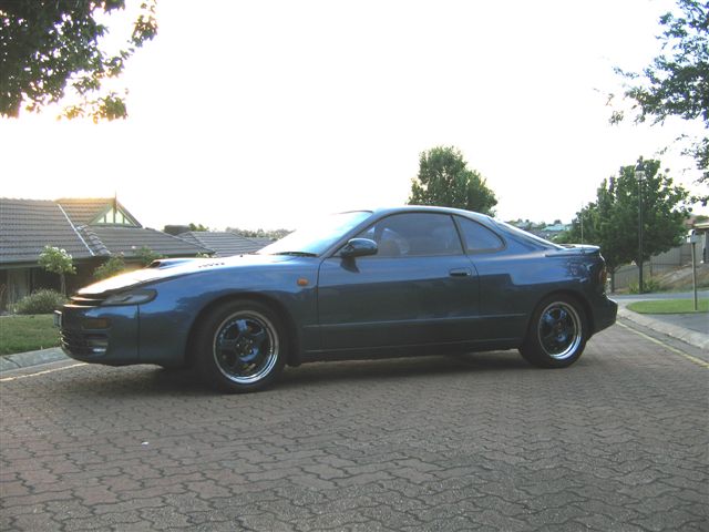

ToDa30/4 Posted March 17, 2007 Report Posted March 17, 2007 (edited) Originally Posted by ToDa30/4 This car has done 245 kmph, ive had the GT4 6 years ,started off with the usual mods we all do and got carried away,motor built by Chris Miltons in Adelaide ,fabrication ,install & dramas sorted by Mark Mills of MADAZ Motorsport ( Top Guy ) and myself remote oil filter simmons 16" F90's Toyo Gran Trampio 225/45's ARP fixings thru out braided brake lines HKS pistons HKS valve springs HKS 1.6mm head gasket HKS 264o cams both sides HKS adj. cam wheels JUN titanium retainers Ferera 1mm o/s s.steel necked valves Bronze guides TRD thermostat Unorthodox alloy crank pulley Fererra Alloy fly wheel Extreme 5 puc single plate clutch ,good so far maybe twin plate latter Speed Source braided clutch line & slave cylinder rod Speed source brass gear link bushes TWM short shifter Fensport alloy pullies RMR alloy bell mouth plenumrossmachineracing.com stock 55mm. t/body ,have a ford 70mm to go on Madaz custom duel feed fuel rail 800cc side feed inj. XS hi preasure Fuel reg. Walbro fuel pump Aussie headers Aussie 3" dump HPC treated modified for GT turbo outlet 3' straight thru exhaust ,with a cannon with 41/2"outlet 10mm Top gun leads Link plus ECU Crane ignition module HKS elec boost control White line full suspension kit with front strut brace Kings super low springs Koni adj. strut insrts DBA slotted discs x4 lucas pads , may need to upgrade here AH UK. Ltd FMIC 645 x 160 x 95 ,600hp rated Garrett GT35 600hp b/bearing turbo Tial 38mm. waste gate twin 12" elec fans custom 4" alloy turbo intake K& N 4' x 5" pod Velo rece seat cam lok 5 pt. harness GFB bovus maximus BOV cusco lower front brace custom rear strut brace , Ok thats about it plans are I'm stripping the car out to get as light as i can, will be using the car for ANDRA sports compact Sports AWD class , run it at mallala & the collingrove hill climb, i had to put the project aside but am now back into it ready for the track april 07 Edited March 17, 2007 by ToDa30/4 Quote

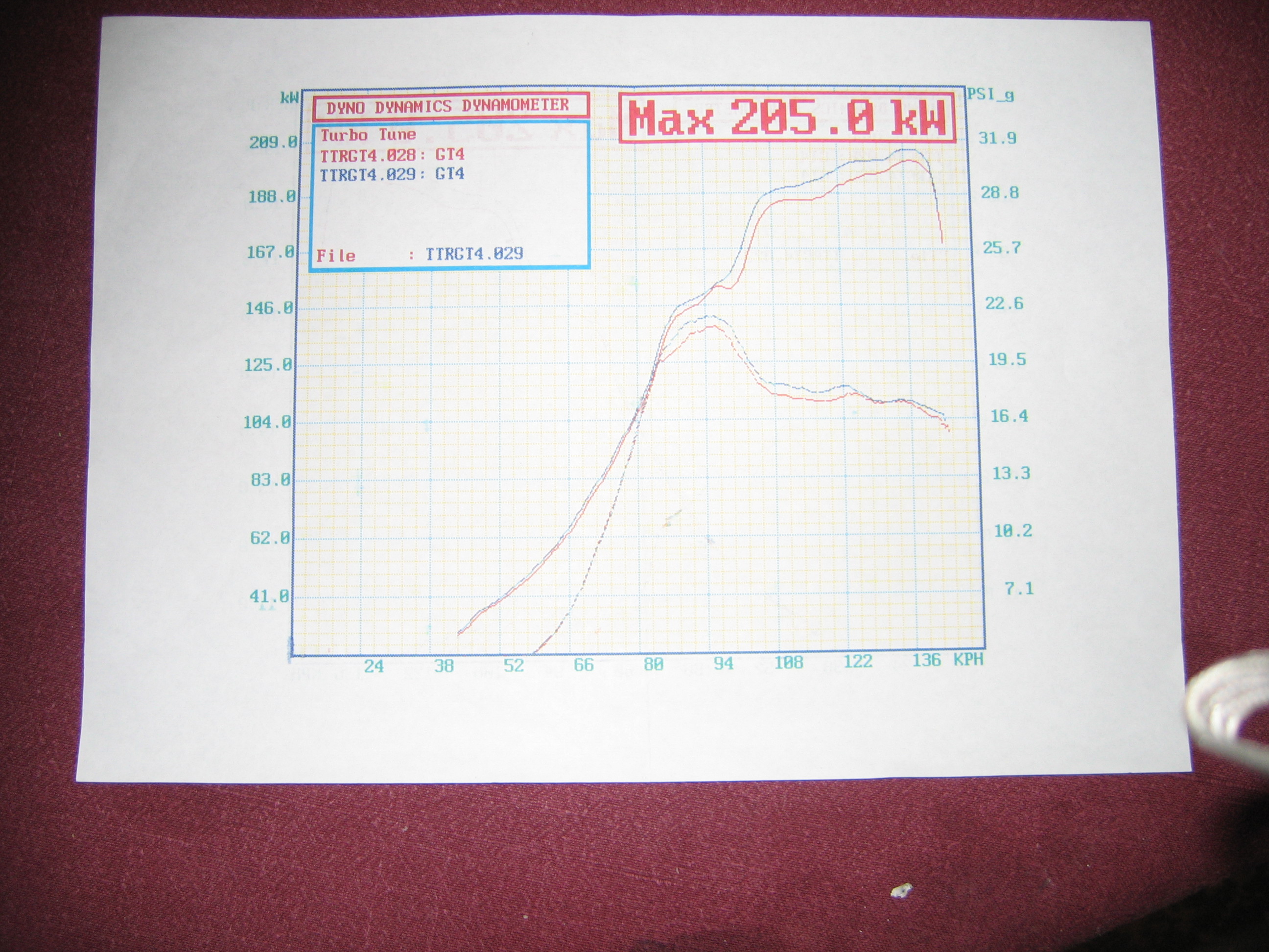

ToDa30/4 Posted March 17, 2007 Report Posted March 17, 2007 so how much power does it have? Sounds like a weapon. Tell us more. Whats going on with the rods? :P stock 2nd gen 3sgte rods & crank balanced , etc.& stress relieved by Chris Miltons good for 9500 rpm , best pull was 225 awkw @8000 rpm on a hybid CT26/ GT30R , ran on the street at 205 awkw had all sorts of dramas with the internal gate not holding preasure , so now have fitted the GT35R externaly gated , we hope to get around 300 awkw on the 264o cams if not i will swap out the cams for some 272o hks & do the shimless 1zze conversion so i don't loose the std bucket over shims with the higher lift . car is going thru a rebirth at the mo & will be back together , on the dyno & the track april 07 cheers dave Quote
