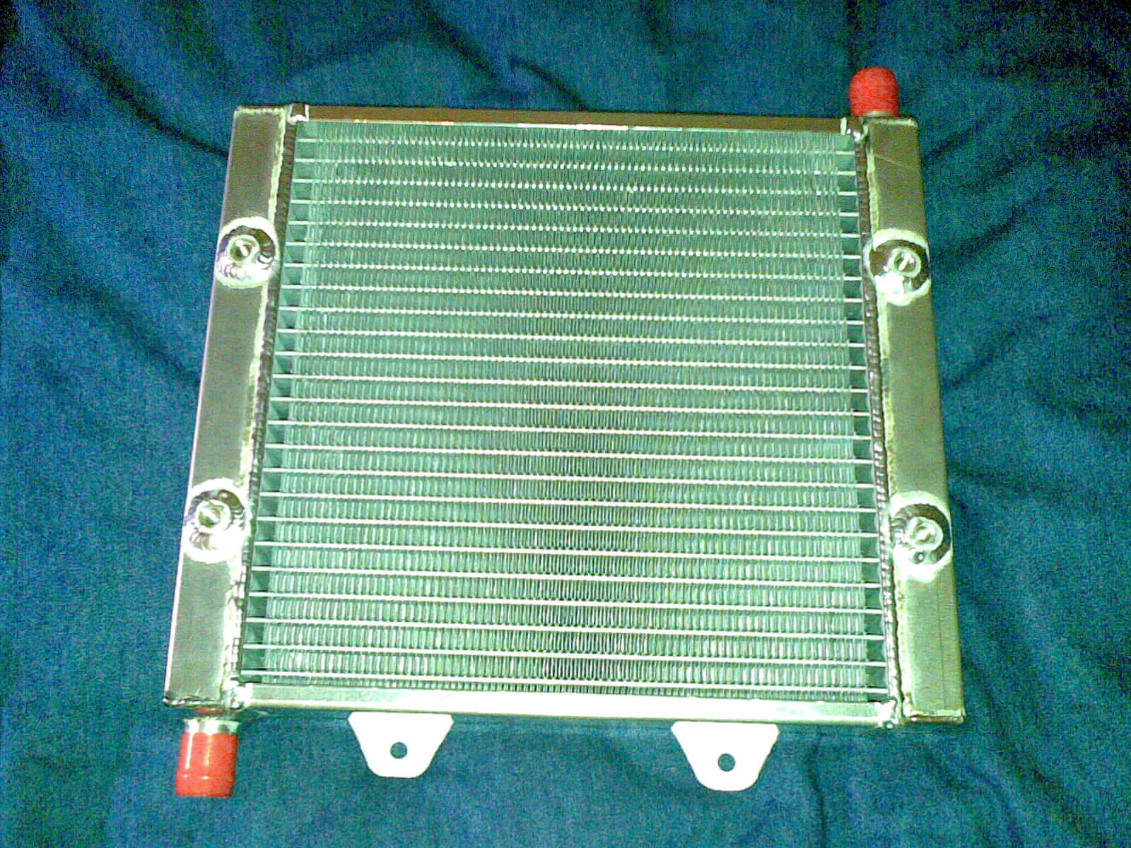

driftke70 Posted May 19, 2008 Author Report Posted May 19, 2008 new radiator for my water to air cooler courtesy of pwr. Quote
beerhead Posted May 19, 2008 Report Posted May 19, 2008 Sweet, those Gen3's boost so early in stock form, will definitely keep you up with the big boys for speed and wheelspin. What gearbox you thinking of running? If you haven't heard, you can get an R153 housing from a 4x4 prado 5VZ to use a supra R154 if you wanted something stronger than a W58. Quote

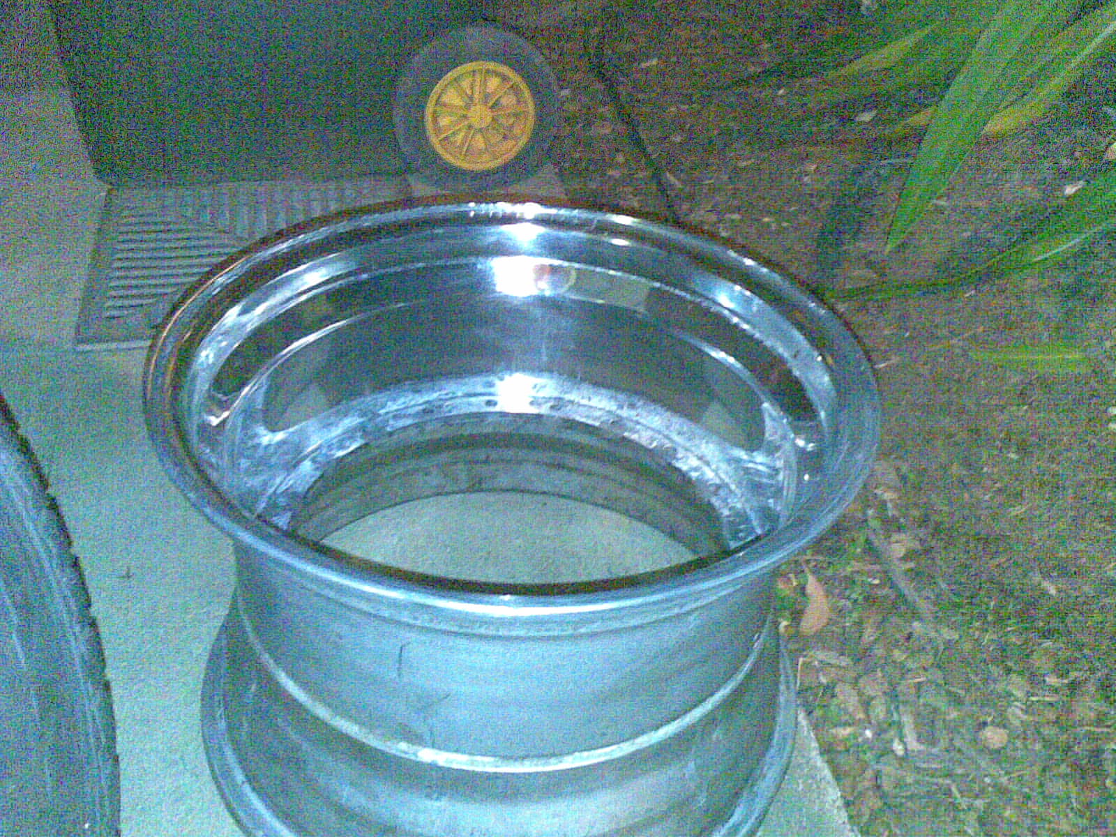

driftke70 Posted June 24, 2008 Author Report Posted June 24, 2008 bit of an update have a shed to work on my car now.. so its moving at a nice rate now d dropped a f series to me today which will be recieving a tomei 2 way for an altezza/supra, in the coming weeks, new mounts and most likely rear coil over conversion. got all my tubing for my roll cage, my brother and i are going halfs on a new tube bender and getting rid of the speedwerx one that works on a vertical plane with a bottle jack in exchange for one that works on a horizontal plane and is hydraulic, and you can set degrees better and stuff, both give un crimped or kinked bends, ones just way easier to use for large things such as main hoops in roll cages. So that shall be knocked up probably before i even start putting the engine in. Have played around almost got cross member sorted, might be able to work with the original sump more than i had planned Water to air cooler will be going where the batter WAS, which will now be behind the passenger seat in a nice little ally box. Drawn up a design for an inlet mani that will be made in the coming weeks. Similar to beau yates's getup 9's are all polished to a mirror finished and centers out awaiting paint, just gotta get some etch primer, got new nuts for the centers so they will looks pretty spiff when all together. With new f series diff which is a smidge wider than t, plus 35mm oversize bolt ons, the 9's will have some of the most uber fitment. Front will be flared by who ever wants to raise their hand for cash, when acompanied with a 5mm slip on front rear track will be perfecto. Even with rona arms, which are still being replaced by rose jointed adjustable jobies. But all in all on track for estimated build time...... for now, dooo dooooooo dooo touch wood Quote
