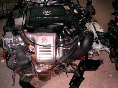

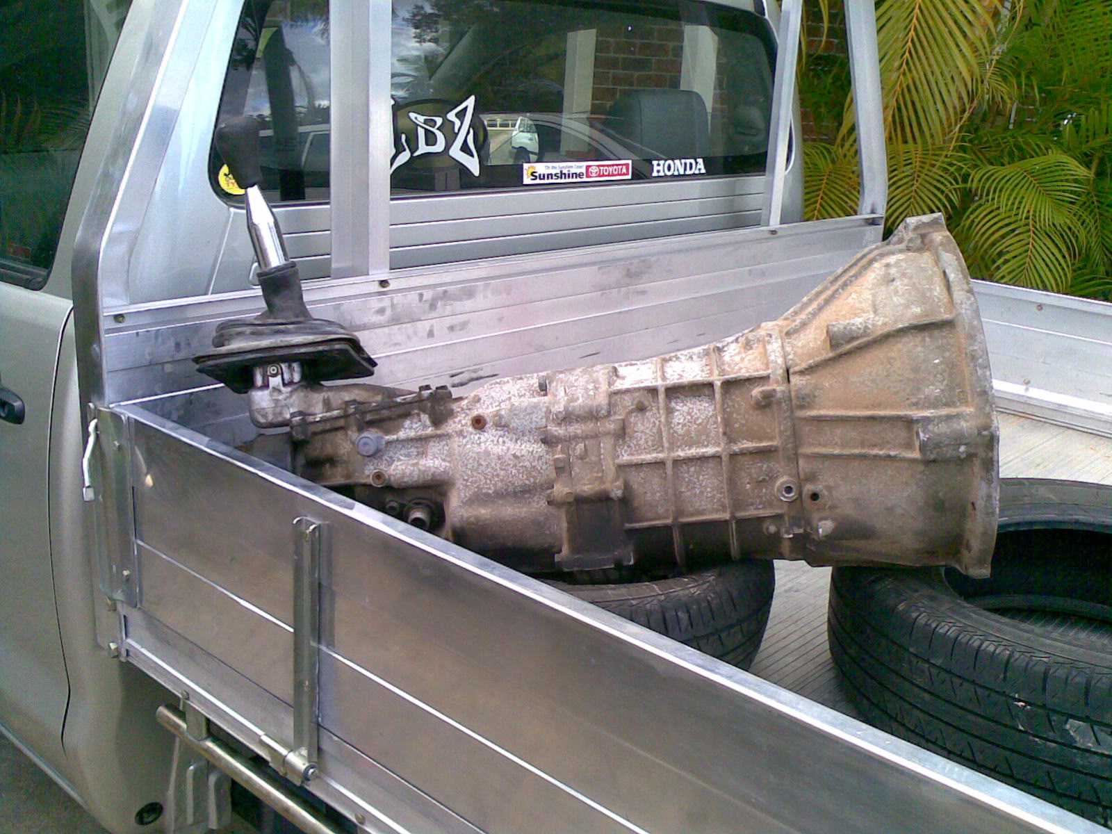

driftke70 Posted May 11, 2008 Author Report Posted May 11, 2008 (edited) well the car is being rebuilt at the moment some stuff to note gen 3 3sgte w box revamp of front coil overs and brakes, mazda fc calipers rear coil overs using custom mounts etc full cage spray job bucket seats rims with semi slicks up front average stuff out back for obvious reasons. rebuild of rear end tighten lsd using full st205 dash and cluster etc rims are 14x8 - 16 ssr front 14x9 -20 rays rear, tyres front are 195 45 14 s595 evo rear are various 195 50 14 bolt on guards pretty much have everything i need, just waiting on a sump from a fella in syd, and a clutch FORK for for a 2s bellhousing if anyone out there has one. piccie poo's Edited May 11, 2008 by driftke70 Quote
driftke70 Posted May 11, 2008 Author Report Posted May 11, 2008 they were all stupidly priced and rooted. gen 3 3sgte has more power much more torque, more reliable, easier conversion, keeps it in the family, power curve suits drift better, got a good price on it, doesnt use half a tank for one run, can trust it going un trailered to the track, keeps my engineer happy for what ever reason, etc etc etc Quote
