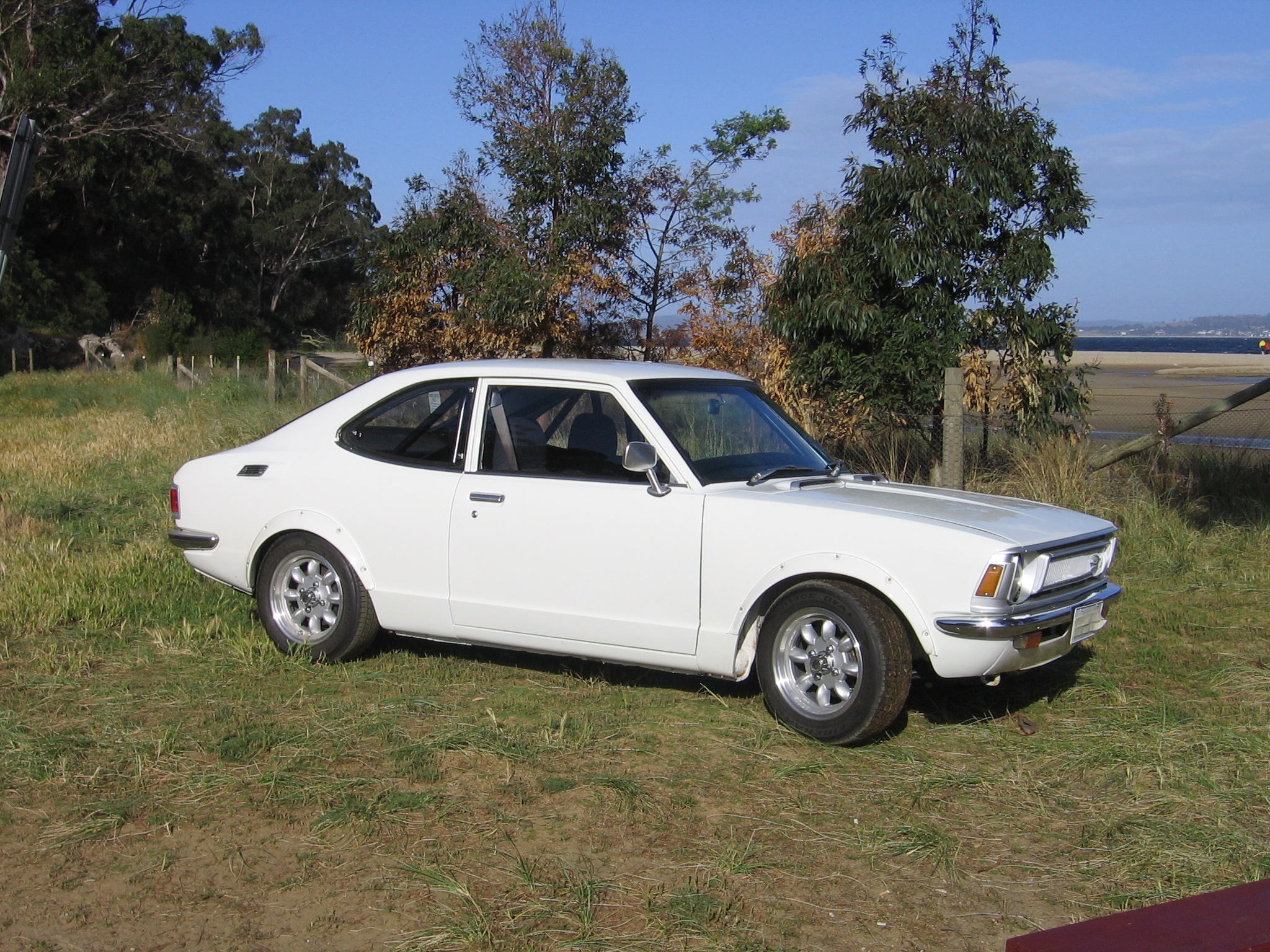

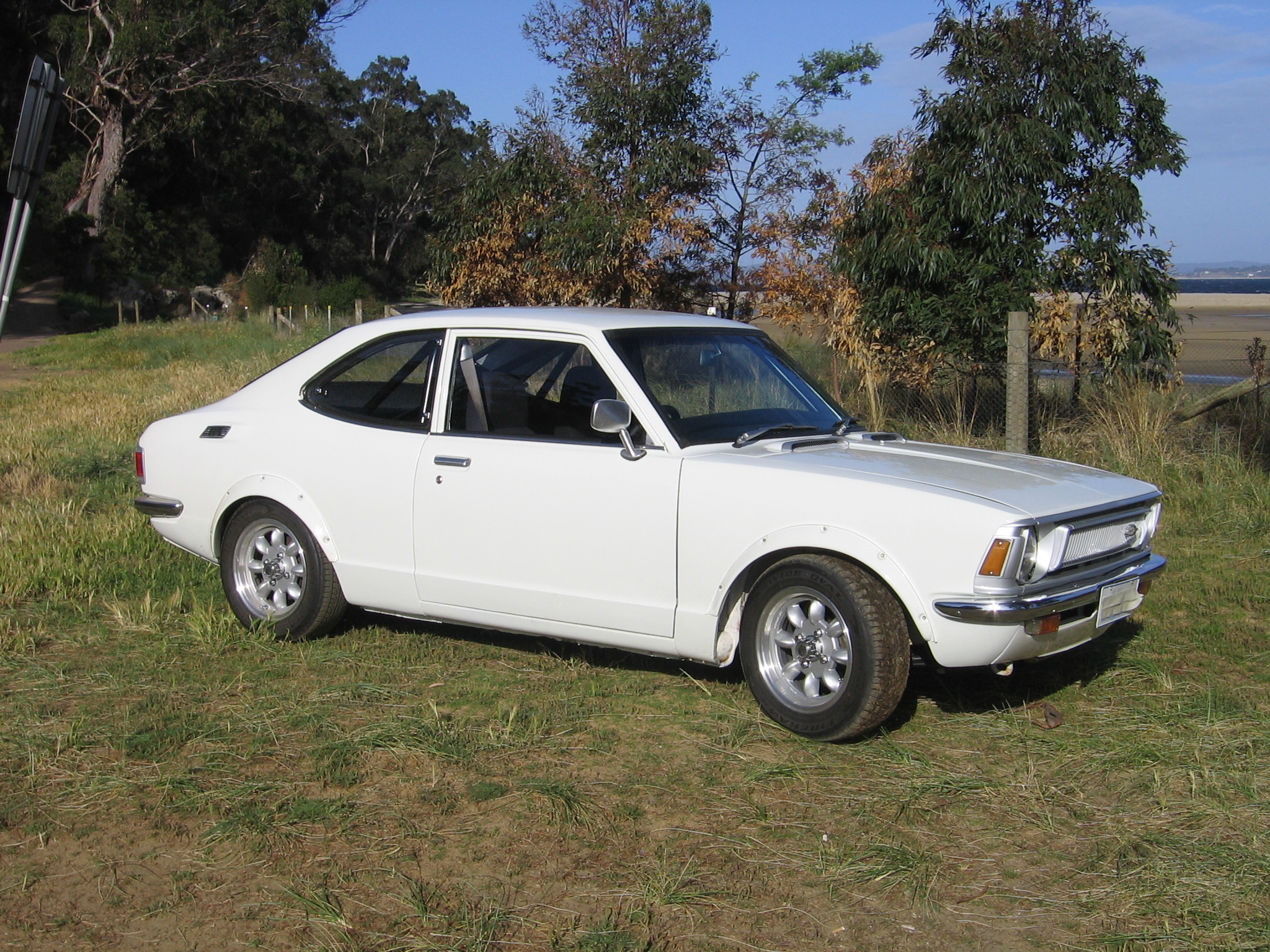

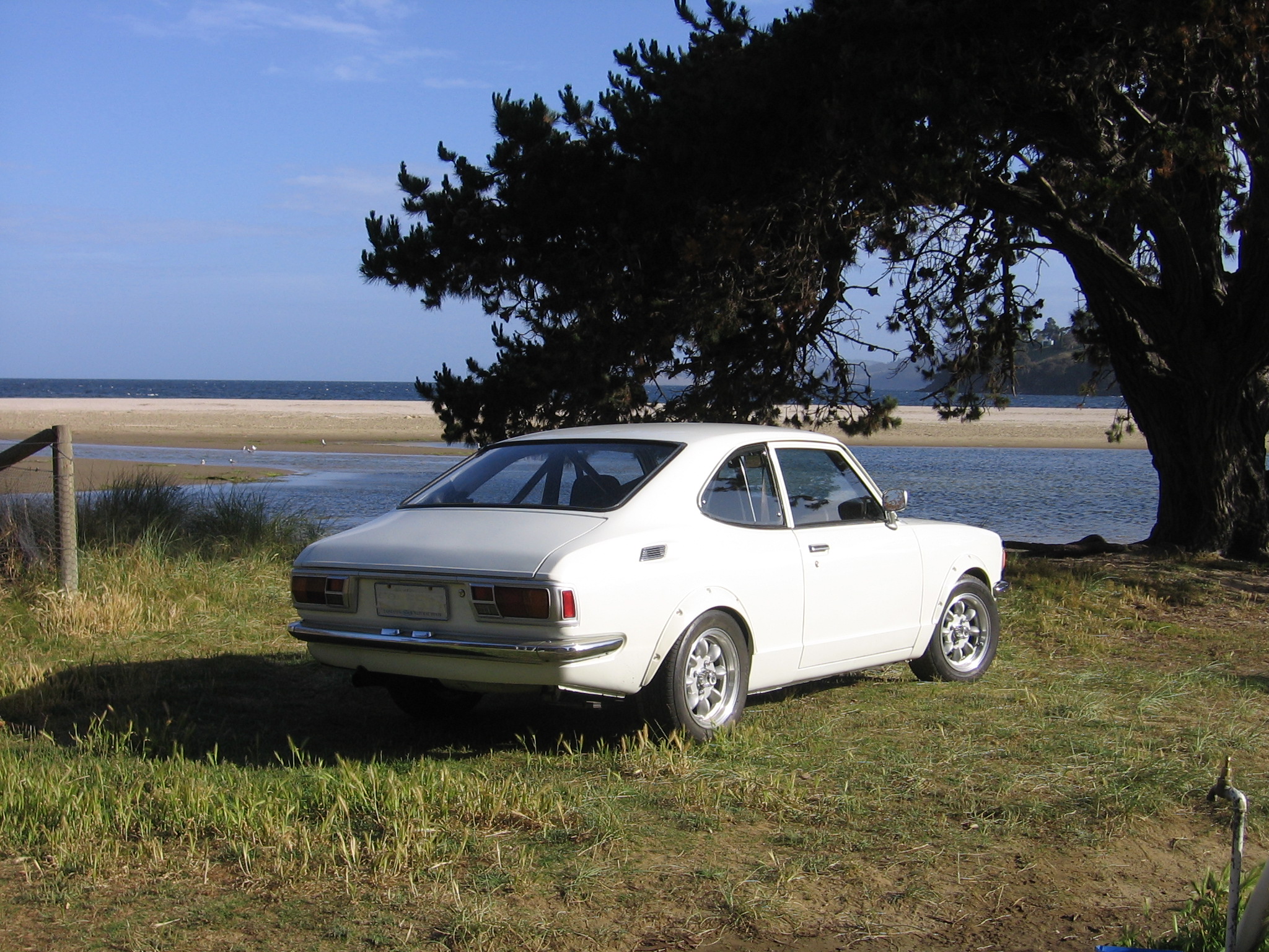

robj Posted November 13, 2007 Author Report Posted November 13, 2007 A few Pics of the 'rolla I took yesterday. Quote
