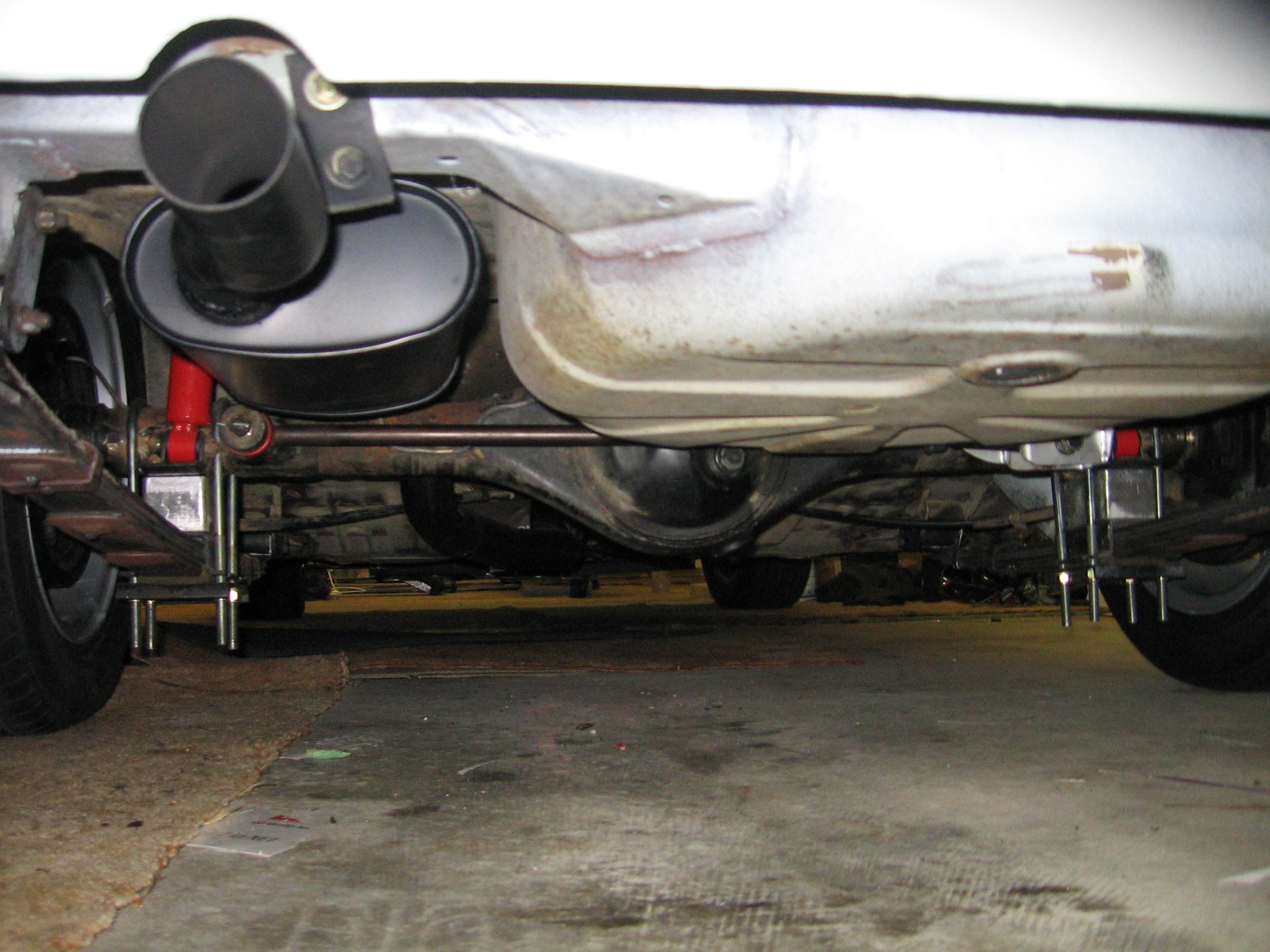

robj Posted May 21, 2007 Author Report Posted May 21, 2007 A few more pics, including a level Panhard rod. Thanks Aaron! Quote

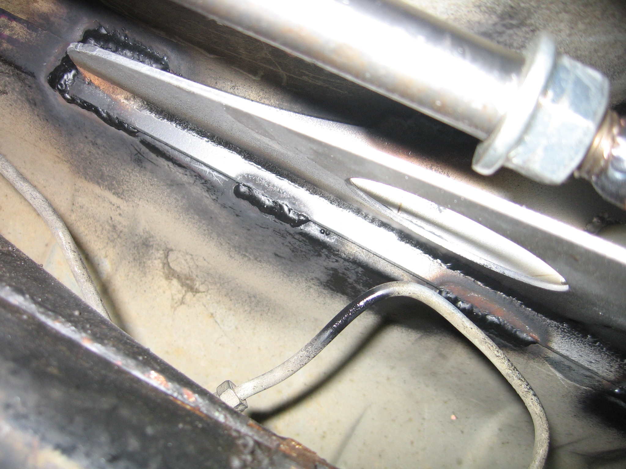

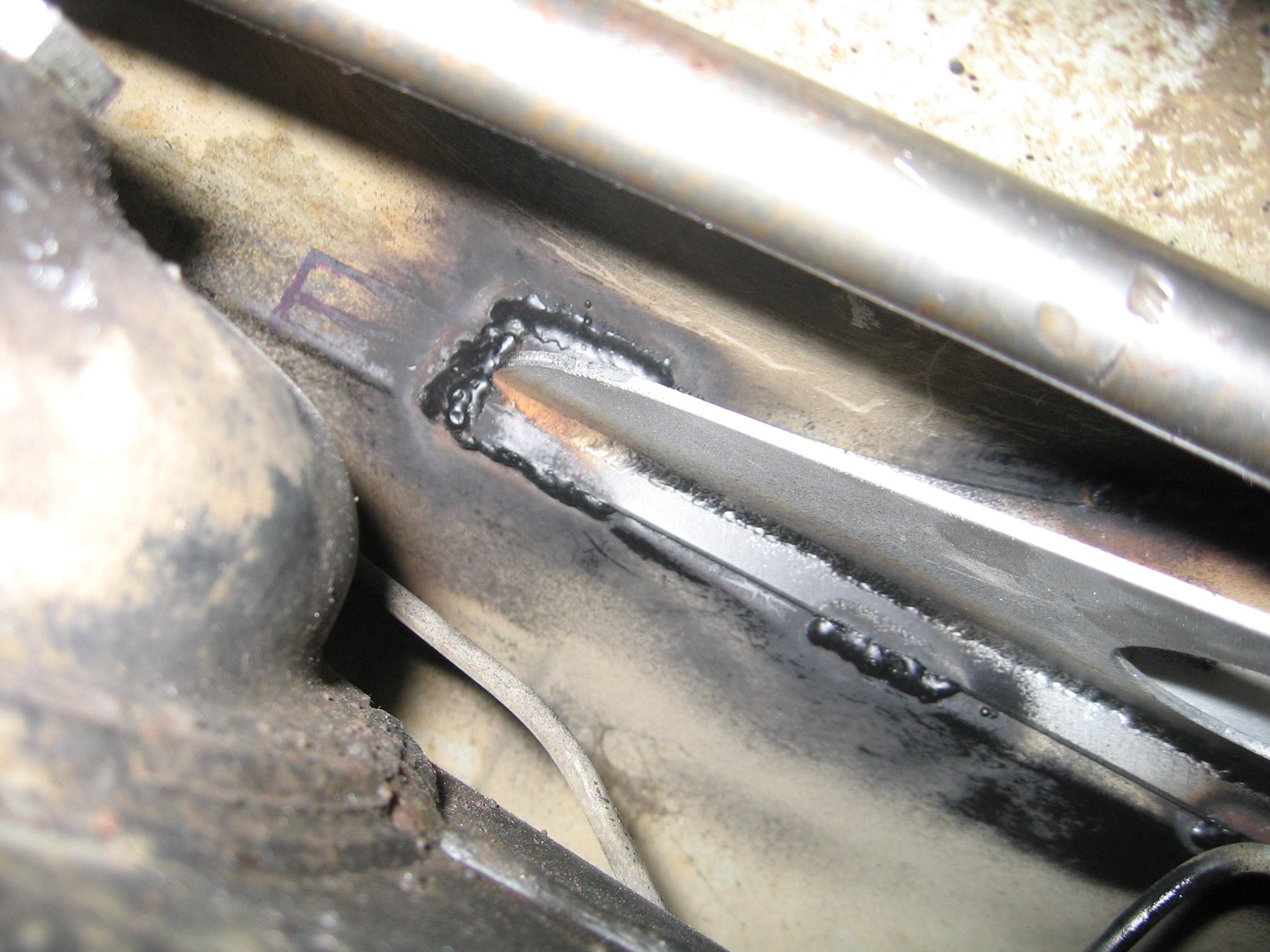

demuire Posted May 31, 2007 Report Posted May 31, 2007 I had the same problem with my LCA's (hitting the disc), spoke to my engineer and ended up shaving a few mm the lip off the outside of the LCA, and machining the hubs so that the discs sat further out. Now I have about 1-2mm clearance between the disc and the LCA, some people warned me that it might still touch, but in the 2.5 years the car has been competing, it hasn't happened. It did introduce another problem though - because the discs are now sitting further out, the calipers obviously also had to be spaced outwards. Finding rims to fit the car is a real PITA, the only ones I've managed to find are Hotwires (which are alright, I guess). Nice work with the car, I really like what you've done with the panhard rod. Any other photos of the setup, esp the chassis mount? Did you have to reinforce the floor area that it connects to etc? Since building the car I've considered putting a panhard rod in, but never actually gotten motivated enough... Quote

robj Posted June 18, 2007 Author Report Posted June 18, 2007 A few pics of the panhard rod mount, a bit hard to see though. It is braced about to the middle of the car, laterally speaking. Quote

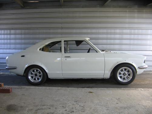

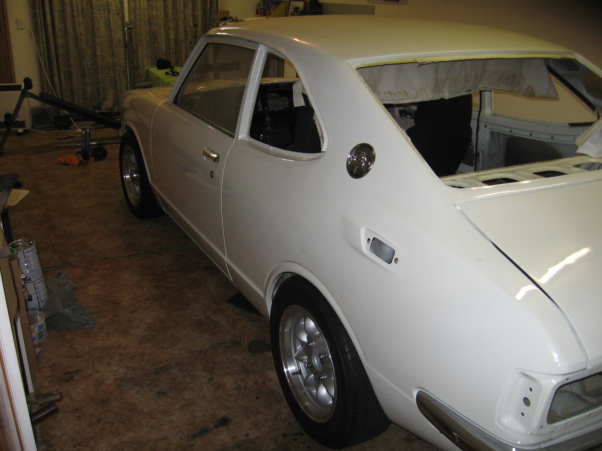

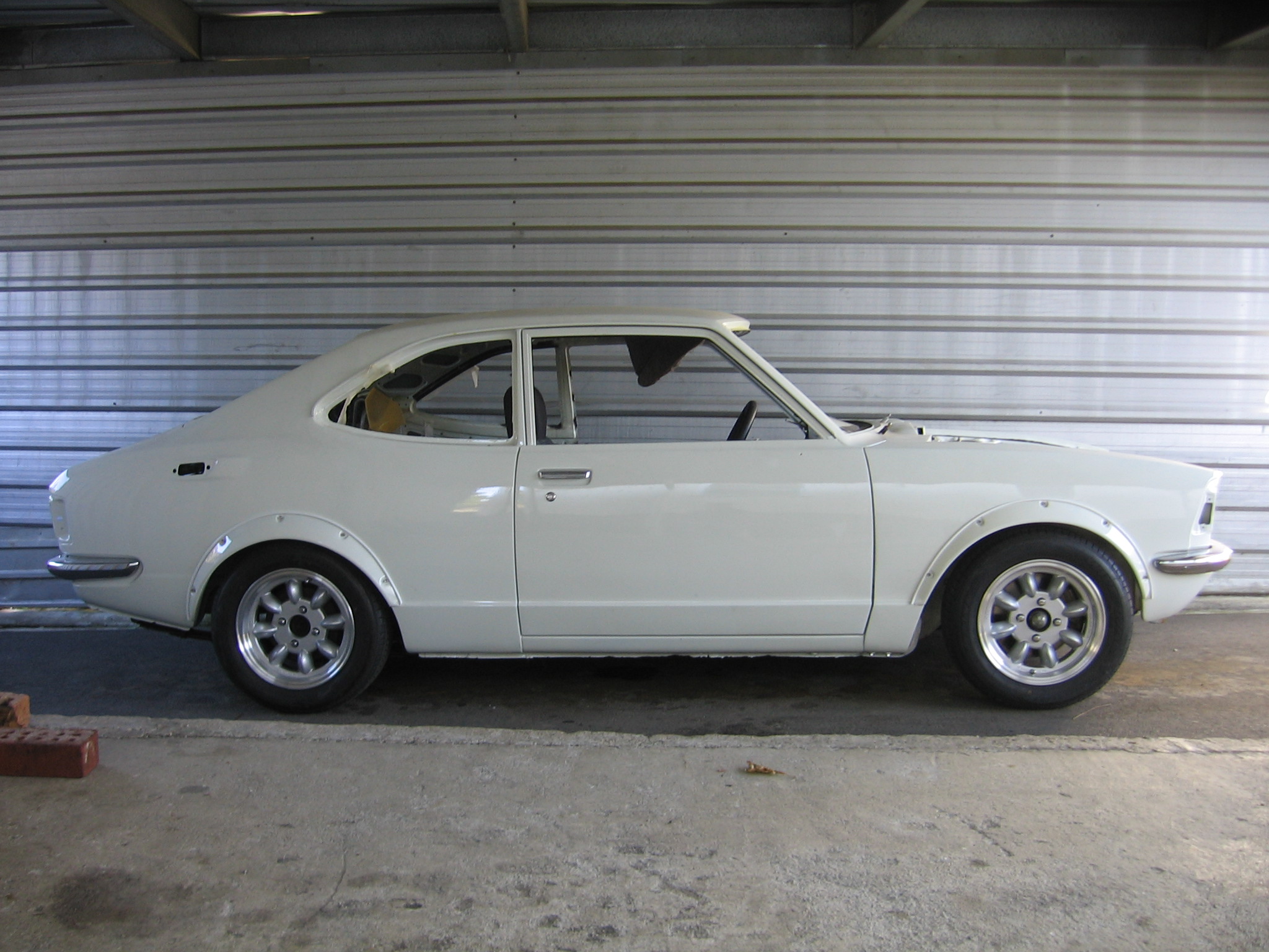

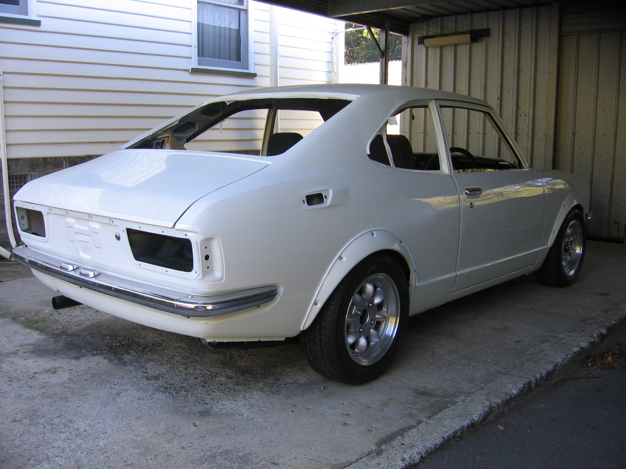

robj Posted June 18, 2007 Author Report Posted June 18, 2007 (edited) Now with TE27 flares, I'm happy with the result. it was hard to see the guards being cut though. :) Edited June 18, 2007 by robj Quote
demuire Posted June 18, 2007 Report Posted June 18, 2007 Thanks for the pics. The flares look great! Quote
