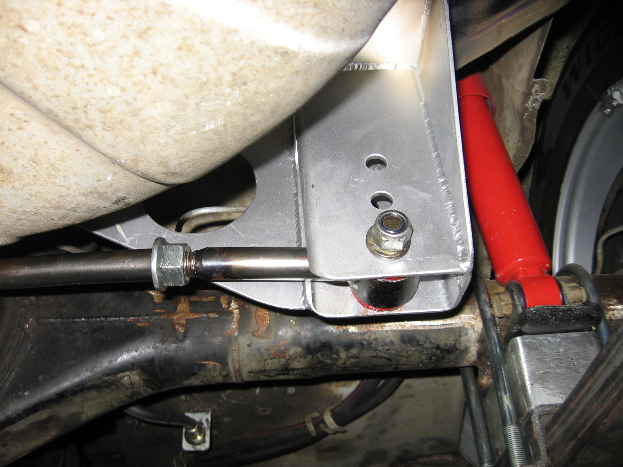

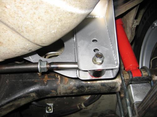

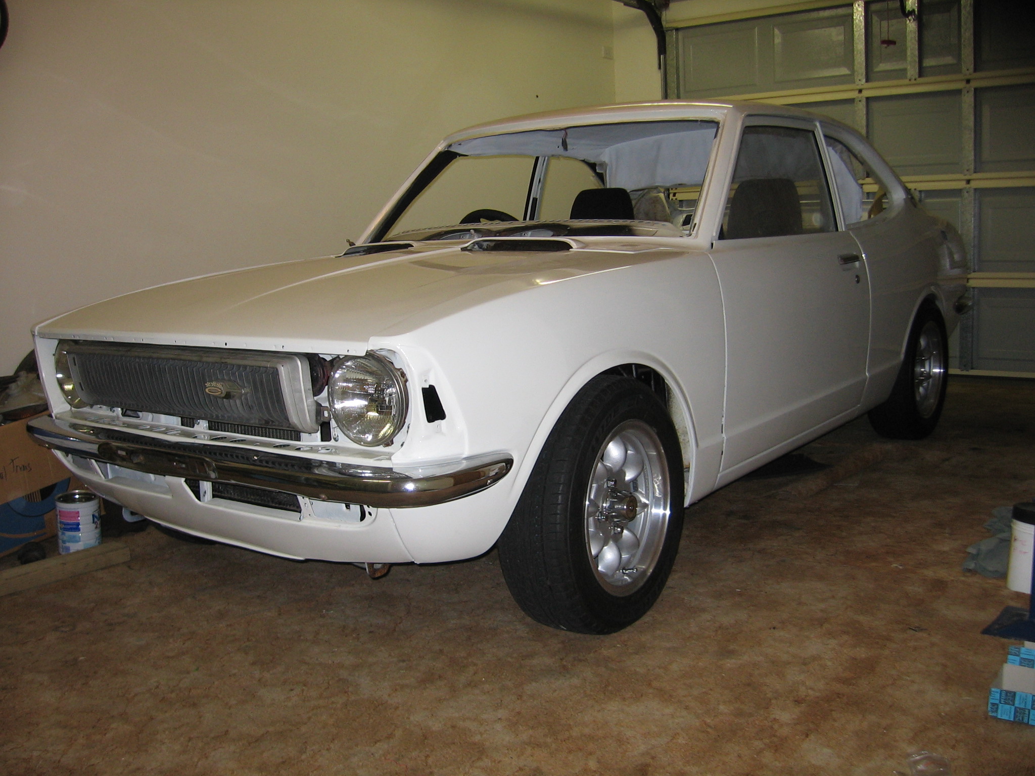

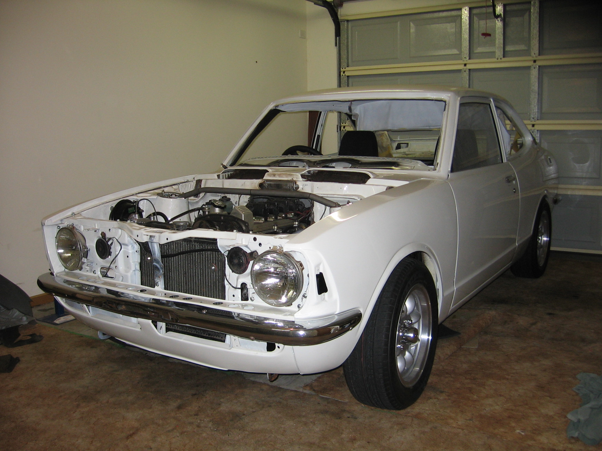

robj Posted May 20, 2007 Author Report Posted May 20, 2007 (edited) Well done a bit since last time, including a 1 1/2 way trd lsd, and a panhard rod. Currently working on a strut brace, and in the next month or so, a roll cage. The shell is seam welded, and with the cage, it should be reasonalby stiff. I dummy fitted the bonnet and grill, for the pics. All the wiring is sorted out now, even the heater works, with it's weird potion on the firewall. Edited May 20, 2007 by robj Quote
