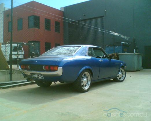

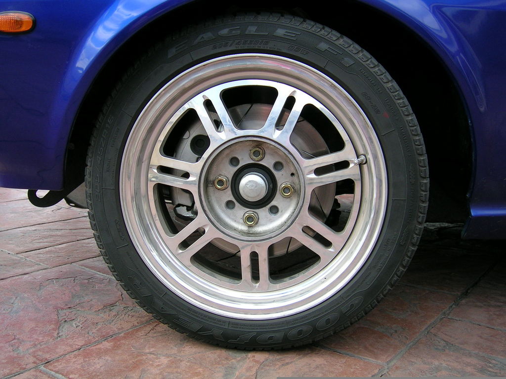

FatTony Posted February 12, 2007 Report Posted February 12, 2007 That kit was developed on my ra23 celica, now what they have not told you, is that your required to use a xt130 corona strut due to the fact that the stub axel in celica, and corolla just aint big enough to suit the bearings on the disc they install. I already had these struts in my car when they developed their kit, I told em what strut was in it, perhaps they have forgotten or the person you got in contact with just doesn't know. In a XA23 onwards celica it isnt a problem because the legnth of the XT130 strut is correct, in a TA22 and corolla there presents a problem, and in a corolla you also need to swap the LCA. This is what the setup looks like. Added a pic of the car to, God i miss that thing Quote
