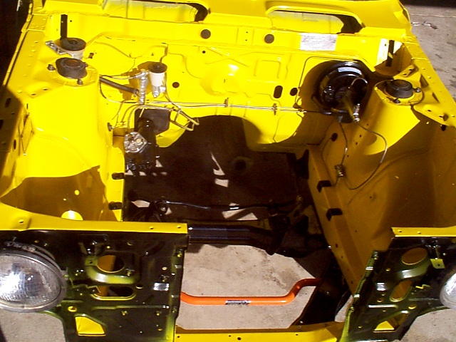

The option I am probably going with is using a PBR VH44 remote booster, that can be mounted on the other side of the engine bay,
or wherever it fits, then you can modify the brake lines/piping to suit.
A mechanic I know here in Wollongong also reckons I should get the master cylinder re-sleeved and buy all new brake lines and fluid...
I have tried to attach a pic from the net where a guy has done a similar mod, if it doesnt work, go to this link and check it out:
http://users.bigpond.net.au/lachlan/cars/k...img/ke25_12.jpg
Ill keep you posted on how mine is going..
