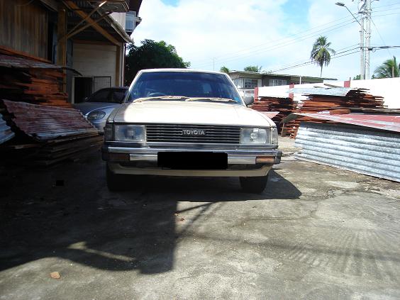

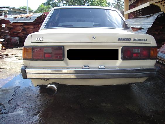

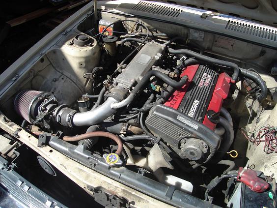

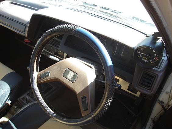

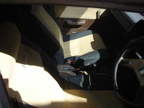

ca18de in a ke70 Posted January 13, 2007 Author Report Posted January 13, 2007 that sounds like a crazy fun but i agree with keeping a straight-4.....i took out some pics of my corolla...so check it out and let me know what u guys think...... Quote

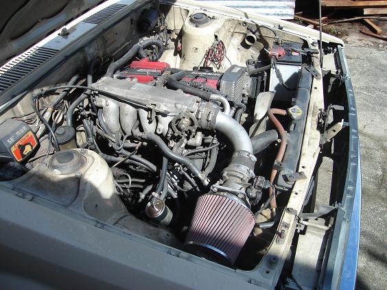

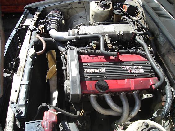

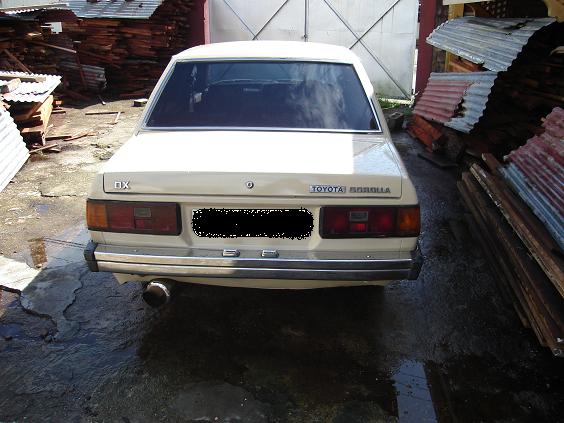

ca18de in a ke70 Posted January 13, 2007 Author Report Posted January 13, 2007 here are some more pics of my corolla..... Quote
7shades Posted January 13, 2007 Report Posted January 13, 2007 Hehehe thats cool... love the steering wheel cover :hmm: Engine is sitting on a very nasty angle.... even more than usual for a CA.... is your shifter still vertical? Also what radiator are you using? Did it come from the CA donor car like a bluebird or something? Quote
ca18de in a ke70 Posted January 13, 2007 Author Report Posted January 13, 2007 u are right 7shades cuz i remember someone saying that....but an SR should fit snug in the engine bay right??...the radiator came with the same engine..the person was kind-hearted to give it to me...u like the extractors though??.... Quote
