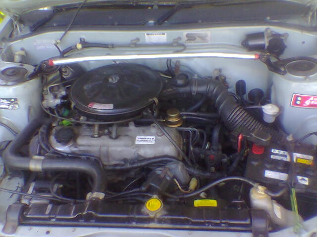

Trev Posted December 23, 2006 Report Posted December 23, 2006 (edited) After looking at those pics i have noticed something very odd, The E In any toyota engine stands for fuel injection which this engine is not (this was even the case in the 2T-GEU). Quote The 4A-E has an electronic distributor and makes more power than a 4A-C. I've seen the info on the net, so google it Every 4A-C i know has come with an Electronic Ignition and the 4A-E made 8HP more than the 4A-C. IMO someone has just stuck that cam cover on that engine or they have converted a once injected engine into carby when the conversion was done, thats if it is actually a 4A and still not the 3A. Just for a future reference: Quote BEFORE "-":the letters indicate the engine family, for example in 18R-G the engine family is R, in 2JZ-GTE the family is JZ. The number(s) at the beginning is the number of the are for a certain bottom end version (block, bore, stroke). The larger the number, the newer the bottom end version. It may seem like the larger the number, the larger the displacement but this is not always true. AFTER "-": G = twin cam (wide angle, 45 degrees or more between the intake and exhaust valves) F = "economical" twin cam (narrow angle, around 22 degrees) T = turbocharged Z = supercharged E = fuel injection i = single point fuel injection L = transverse mounted engine (seems to be an obsolete code) B = twin carbs (only used on non-twin cam engines, obsolete code) R = air injection S = swirl intake ports (only a few made in mid '80s) S = direct injection & swirl pot pistons (starting from '97/98) U = emission package (Japan) C = emission package (California) LPG = LPG fuel Edited December 23, 2006 by Trev Quote
Trev Posted December 23, 2006 Report Posted December 23, 2006 (edited) Here's a pic of the missus AE82 engine bay, 4A-C (electronic Ignition) Edited December 23, 2006 by Trev Quote
Robert Posted December 23, 2006 Report Posted December 23, 2006 AE71 4A-Cs have points AE82s don't :ninja: Quote
Trev Posted December 23, 2006 Report Posted December 23, 2006 (edited) Robert said: AE71 4A-Cs have points AE82s don't :ninja: Yes but i didnt say that the 4A-C didnt come with them, I said every 4A-C i know has EI, It not how you tell a 4A-E is all I'm saying. Edited December 23, 2006 by Trev Quote
BiGGy Posted December 23, 2006 Author Report Posted December 23, 2006 Well thanks for all the info, ill have another look at the engine and see if I can tell the difference. I didnt know those letters actually ment something what do ya know. I thought points with coil were the only way of doing it, but I'm prolly wrong. Quote
7shades Posted December 23, 2006 Report Posted December 23, 2006 I'd assume what has been done is someone has used the 4ae block, and attached the existing tercel manifolds to it. Quote
BiGGy Posted December 23, 2006 Author Report Posted December 23, 2006 7shades said: I'd assume what has been done is someone has used the 4ae block, and attached the existing tercel manifolds to it. I would say thats it, which makes it easier for me, following that other thread and all. Quote
Trev Posted December 23, 2006 Report Posted December 23, 2006 BiGGy said: I would say thats it, which makes it easier for me, following that other thread and all. Check the engine number just to make sure it is still a 4A tho. Quote
