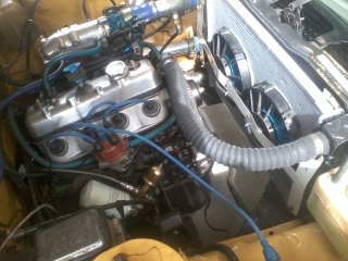

Taz_Rx Posted September 29, 2013 Author Report Posted September 29, 2013 Been doing the 200km treck between Launy and Hobart a bit lately. Highway fuel economy driving it easily is getting around 10Lt/100km...... but its way worse for city driving. Keeping an eye on the data on the hand controller reveals its under a lot less load at say 110kmh compared to 90-100kmh, so I'm thinking the trick to getting the best economy on the highway is to go as quick as legal. Â Picked the rug-rat up from daycare the other day only to find a green puddle under the front of the car...... at least it didn't happen on the midland highway. Swapped to dirt for a couple of days while I fixed it. Pressure tested it as I did a few months back - successfully fixed a small hole with "kneed-it". This time I couldn't exactly find the hole and by the size of the bubbles it seemed to be a big one. Decided that old rad had had its day and shopped around for a new one. Found some full alloy ones on ebay pretty cheap - $140-$200.... but had to get back to Hobart asap so I ended up getting one from Repco for $123!! I now know that what I had was a s1 VN rad, and I've replaced it with a s2 VN one. As the s2 has a cap on the rad itself I've also got rid of my fugly top hose....not that the flexi universal one looks all that better. Knocked up a dodgy quick thermo fan mount with a mate so I could get back on the road asap. Have had a rummage though my dads steel and alloy stash and will make a decent one next week hopefully. Used the twin 10" fans that I used to have on the RX4. Â Some piccies - New rad, fans and dodgy bracket...... Â This was my pressure testing facility from last time I fixed it..... Â And a couple of my apprentice mechanic..... Â Sorry about the shitty phone pics. Â In other news I blead the brakes for the first time since I've had this car. Ashamed to say that's been around 6 years. Don't know how long before that it had been done by the previous owner. They've always been pretty good, but now they're awesome......for stocko girlocks anyway. Â AND.....the exciting news - Off for dyno tuning in Hobart on Tuesday arvo. Going to Pro Automotive in Moonah. Guy there tunes a lot of local race cars so hopefully he'll do a good job. He's also happy for me to hang around while he's doing it which I'm happy with.....suppose I can get a vid or 2 of it on the rollers. Will update then. Will actually have a power figure this time. Anyone wanna make some guesses? Â Cheers, Si. Quote
