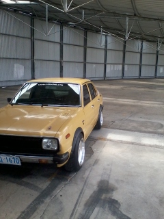

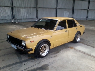

Taz_Rx Posted February 1, 2013 Author Report Posted February 1, 2013 New wheels fitted up. Teaser pics......... Quote
Toy-Yoda[RL] Posted February 1, 2013 Report Posted February 1, 2013 Second pic makes them look huge..... Quote
untubbed_20 Posted February 1, 2013 Report Posted February 1, 2013 that looks tuff.... cheers darren Quote
Oh-KE Posted February 1, 2013 Report Posted February 1, 2013 Looks good man, they 15s?? BETTER PICS PPLEEASE :popcorn: Quote

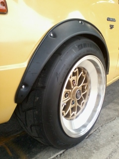

Taz_Rx Posted February 1, 2013 Author Report Posted February 1, 2013 Yeah mate...... 15x9 -10 Rota Alecias in Gold/polished I'm really happy with them....... now they're finally on the car. Wish I could say the same about the purchase process and reccomend rota wheels but to be honest I'd be more inclided to say look elsewhere....... But at the end of the day Wei did finally come through with the goods and do right by me so I won't bad mouth him. More piccies....... Rear fitment is what I would basically consider perfect with the flairs. Front could maybe even be zeros, but by the time I add a little more camber they should be perfect too. I'm not really a huge fan of the strectched look, I'm putting up with it as I had those tyresn (195) already...... plus they're nice and grippy. When it comes time to replace them I'll probably look at something like 205-215 on the front and 235-245 on the rear. Depends how deep my pockets are at the time I suppose. Also, here's my cam specs Darren. Was originally a Crow 600740 (cortina Bathurst grind) modified to 114 L/C at my request. .050" valve timing inlet opens: 1 B.T.D.C., closes: 47 A.B.D.C .050" Duration: 228 exhaust opens: 52 B.B.D.C. closes: 2 A.T.D.C. .050" Duration: 234 Advertised valve timing inlet opens: 27 B.T.D.C., closes: 73 A.B.D.C Advertised Duration: 280 exhaust opens: 78 B.B.D.C. closes: 28 A.T.D.C. Advertised Duration: 286 Inlet lobe lift at T.D.C. on overlap .055 inlet and exhaust lobe lift is .2671 and .4007 at the valve. Quote

Trev Posted February 1, 2013 Report Posted February 1, 2013 The colour it is with the black flares is the way this car needs to be, I love it. Quote
