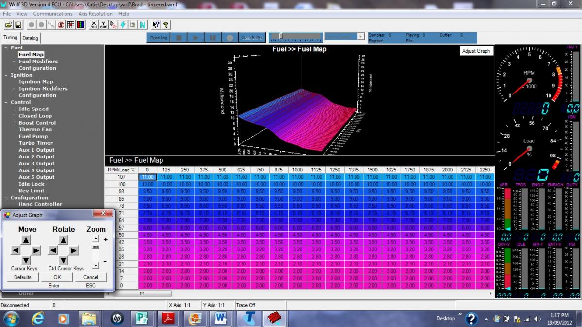

Taz_Rx Posted September 26, 2012 Author Report Posted September 26, 2012 ....yeah or not! Â Hmmm, do you think the fuel mapping needs some work? This was the tune done like 3 years ago now....... Â So my wolf 3d is effectively running a 2d fuel map. :rolls: Quote
kickn5k Posted September 28, 2012 Report Posted September 28, 2012 Wow, what are the mixtures like on cruise Si? Would probably explain your awesome fuel economy. Quote
Taz_Rx Posted October 2, 2012 Author Report Posted October 2, 2012 Hate to say I've never had my own o2 sensor, but I'm going to get one rather soon so I can do some more tuning myself.. I've always known it needed some more off boost, drive-ability tuning. Thats why its being road tuned this time,.... rather than getting a sheet with a number in the corner. Quote

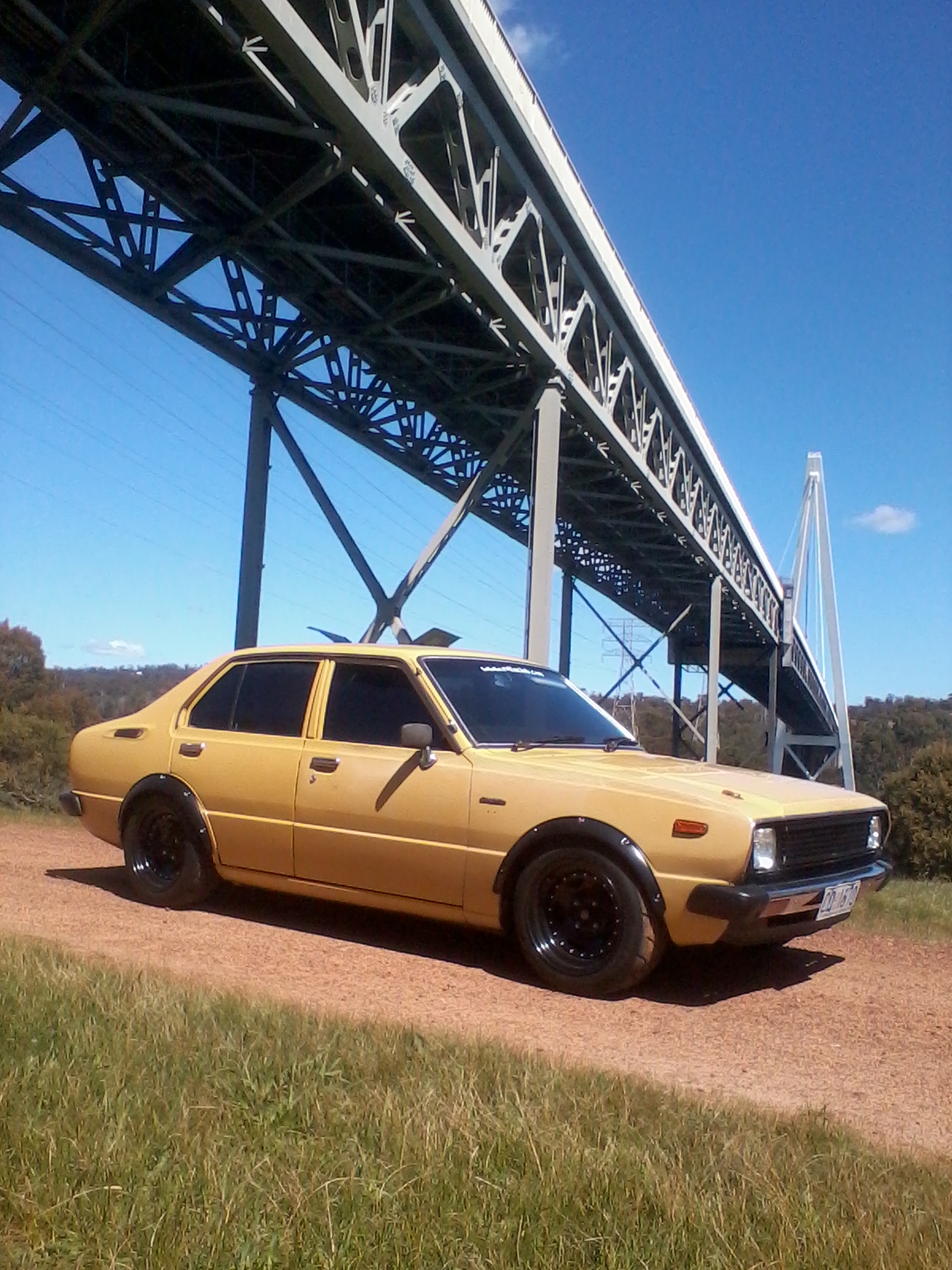

Taz_Rx Posted October 12, 2012 Author Report Posted October 12, 2012 So I've been doing a little road tuning lately. Have got it driving, and more importantly starting really well now. Â Went out for a little drive yesterday and got a couple of pics...... Â Â Â Now have around 450km on the motor. Its currntly getting the rear screen tinted today, I removed all of the side glass to get that done. Heaps better result as tyhe tint goes under all the rubber and flocking instaed of 1-2mm off the edge. Â Oh and here's a pic of Byron lapping my valves.... Quote

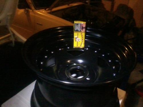

Jono.C Posted October 12, 2012 Report Posted October 12, 2012 (edited) Are those reverse mesh? It looks really tough on those!! Â *Edit, i see what they are now i'm not on phone!! Edited October 12, 2012 by Jono.C Quote
Taz_Rx Posted October 12, 2012 Author Report Posted October 12, 2012 Yeah some of those 15x8, 0 toyo industry things wearing Potenza semis.  I've also got a pair of 15x10 0's  Since it was last on the road some of the updates include:  Above new wheels Prepped & painted flares in satin black New stainless flare bolts Flare piping Tinted windows All new window flocking Central locking Passenger door swap with "Dirt"...... think it was the last perfectly straight panel on Dirt and Tar's had a slight dent. Dash fixed and repainted  I just had a few things that required the car to be off the road for a little while. Never planned for it to be around 12 months! :rolls: Quote
