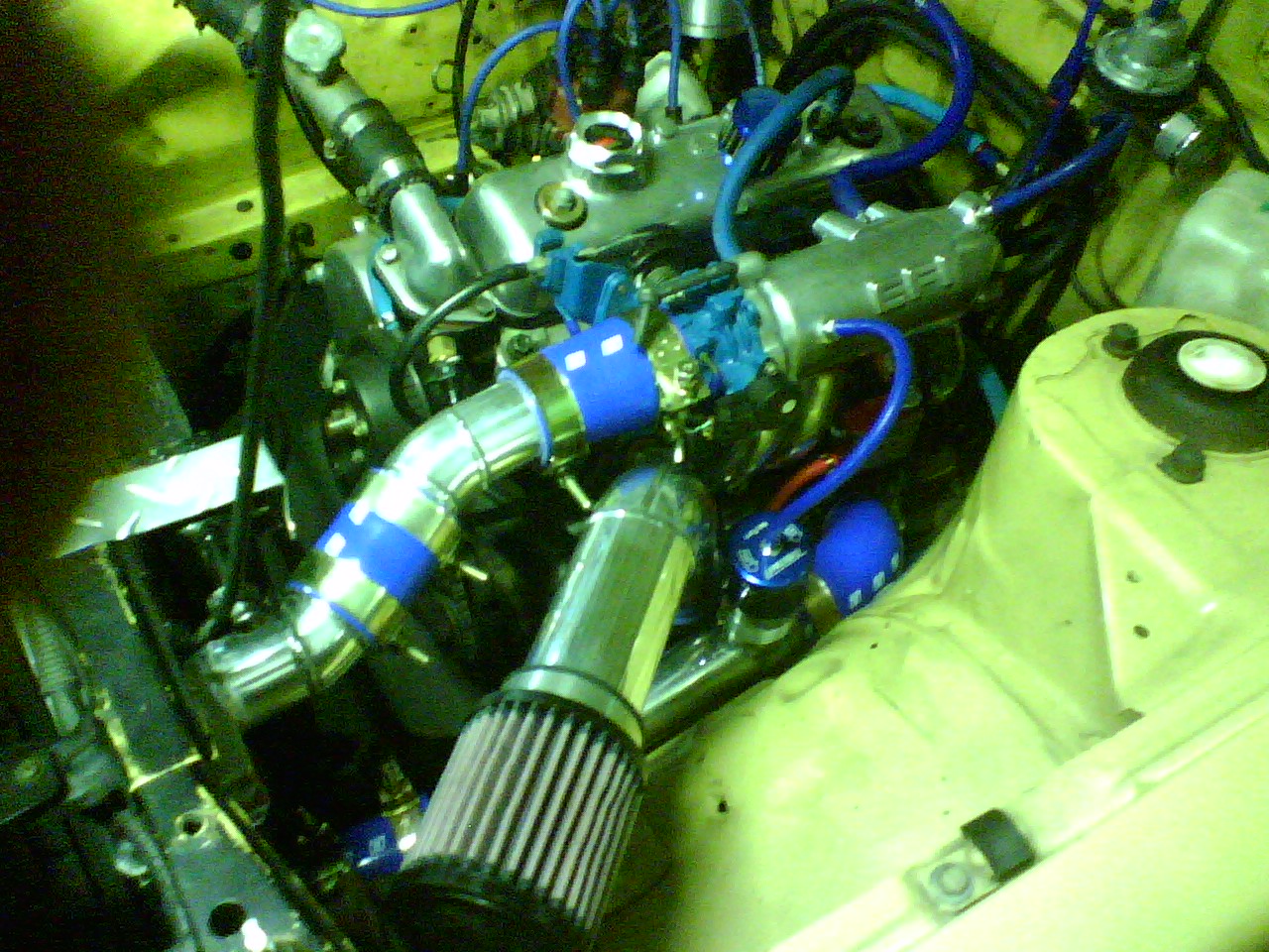

Taz_Rx Posted June 13, 2008 Author Report Posted June 13, 2008 here's a phone pic for now..... :lolcry: Quote
ae174agze Posted June 13, 2008 Report Posted June 13, 2008 thats awsorm i want to see the power this thing makes man should be quite impressive Quote
KE ping it real Posted June 13, 2008 Report Posted June 13, 2008 That is one sexy looking engine bay :lolcry: Quote
Taz_Rx Posted June 13, 2008 Author Report Posted June 13, 2008 thanks guys, I'll give the other bits a re-polish tomorrow maybe, as the new shiny pipes make them look really dull. Will take some decent pics when I do. Fouled another set of plugs! :lolcry: (thye were bp5es Matt) so there was no driving it tonight. Most of it would be because it is running so rich, but I'm thinking maybe I should buy a new coil and f@$k off the ballast resistor, and run 12v through them all the time. :y: Thoughts??? Quote

KE ping it real Posted June 13, 2008 Report Posted June 13, 2008 (edited) thanks guys, I'll give the other bits a re-polish tomorrow maybe, as the new shiny pipes make them look really dull. Will take some decent pics when I do. Fouled another set of plugs! :lolcry: (thye were bp5es Matt) so there was no driving it tonight. Most of it would be because it is running so rich, but I'm thinking maybe I should buy a new coil and f@$k off the ballast resistor, and run 12v through them all the time. :y: Thoughts??? Definatly change the coil to high energy! When i first put my engine in it had electronic ignition without a high energy coil and it wasn't running to it's full potential I just put the new coil on, bypassed the resistor and changed the plugs to the kind without resistors and it runs even smoother now with a power increase aswell I also had a plug fouling problem and it definatly helped that too :cool: Edited June 13, 2008 by KE ping it real Quote

untubbed_20 Posted June 14, 2008 Report Posted June 14, 2008 (edited) yep, but bear in mind that its probally the tune thats f@$ked them and theres only one way to fix that, plugs are f@$kers of things ,takes nothing to ruin them ,also this might be the prob: matt also runs a CDI ignition, if you are using his tune ,so its going to tolerate a much richer AFR and not soot the plugs up with his massive spark compared to your pissy one:) 12V ignition>CDI>water injection>25psi boost ha,ha cheers darren Edited June 14, 2008 by untubbed_20 Quote
Taz_Rx Posted June 14, 2008 Author Report Posted June 14, 2008 Yeah alright then, I'll invest in a 12v coil soon. Plan on rigging up some sort of dualpulse CAS and running 4x coil packs eventually. Just took it for a drive!!!! :lolcry: Didn't like 3rd too much once the boost built up a bit, but 2nd wasn't too bad. f@$k ALL LAG!! :y: Quote
