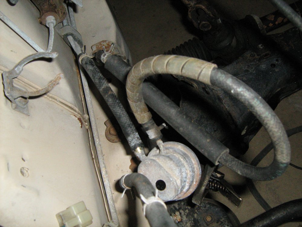

Trev Posted February 6, 2008 Report Posted February 6, 2008 If thats the case I honestly would not bother with one of those regs just for the return line out of it. Just run a holley red or carter green (either of those will give you adequate flow) and use a $30 speco carby reg (one of the 1-6psi adjustables) and you're good to go! If you wanna spend $90 odd on a reg, buy a Mallaroy!! ;) The return lines in carby ke's etc are more so just a "breather" than a return fuel line as such. All part of the pollution shite attached to the charcoal canister (but I probably don't need to tell you this!). When I set mine up, I didn't even entertain the idea of using it for a return as its like 3mm ID. Just used the normal fuel send as a return and ran new 3/8 send. Have recently noticed that Xe7X's have 3 alloy fuel lines, which are also bigger than 30-55 etc, so they may be more usable! [/rant] :bash: Nah mine actually has 3 lines, Fuel feed, Fuel return and canister vent, Heres a pic, I have the feed line with a short hose as i drained the tank a bit: Quote
