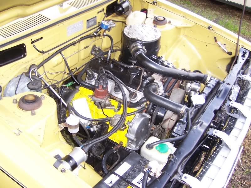

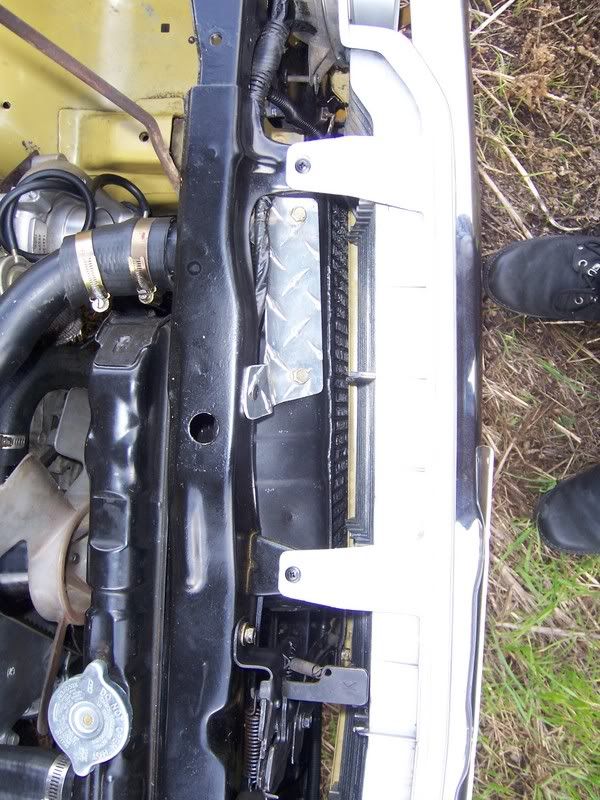

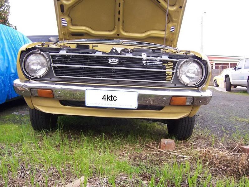

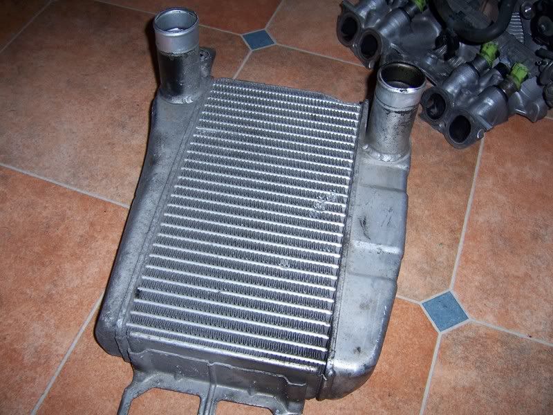

Taz_Rx Posted July 12, 2007 Author Report Posted July 12, 2007 Well last week end was d-day for the carby kit. Spend seriously all last weekend working on this car. :) The owner of the car was given a list of stuff to be done befor he bought the car to me, think about 5% of this list was done!! :) So I had to re-wire the WHOLE engine bay. Anyway, got there in the end, only thing to do is put the back half of the exhaust in, which I will do tonight. Got the cooler fitted in this car better than it ever has been in both of mine, just fits between the uncut grill and stock radiator with some creative angle grinding - ofcourse I had to do this too. ;) Here's a couple of pics of "Ned's" new home..... Quote

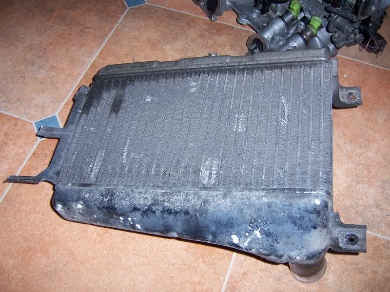

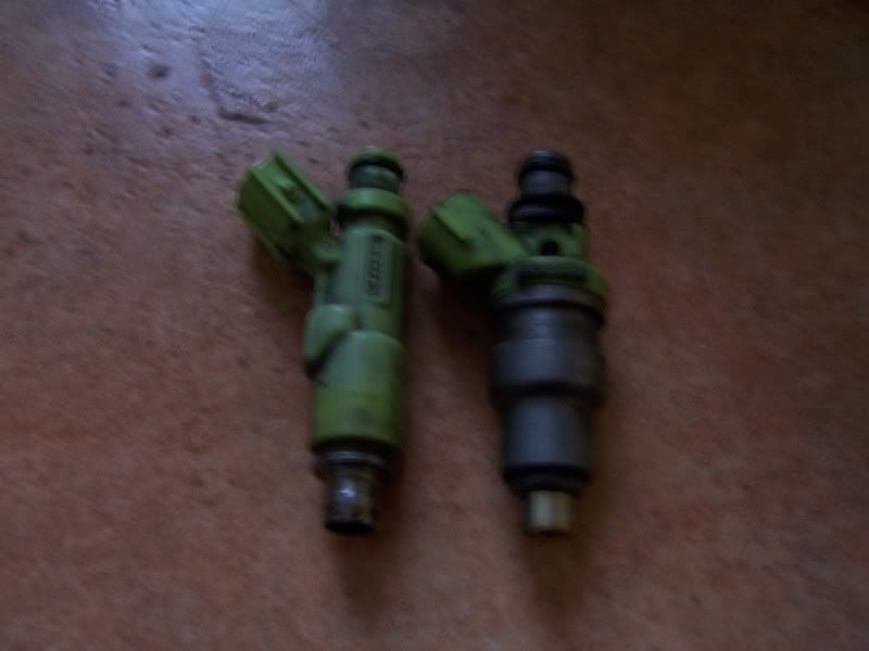

Taz_Rx Posted October 5, 2007 Author Report Posted October 5, 2007 Ok, now for the good car. Picked these up for the back of it... TRD 8-way adjustables!! :wink: Fitted them on the weekend and they're awesome. on 1, they're softer then what was in it, and on 8 they're soooo stiff. If you push on a back corner it'll pretty much lift the oposite front corner! :no: Got another MX6 cooler... 7MGE 315cc Injectors fitted... 7k on the left, 7M on the right...obviously! Quote

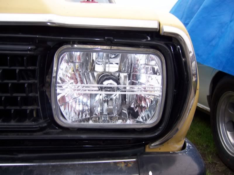

Taz_Rx Posted October 5, 2007 Author Report Posted October 5, 2007 New eyes... And I never got around to putting this up at the time. This was the 4k, not 5k on 8psi. Quote

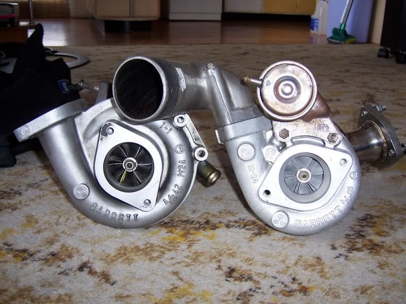

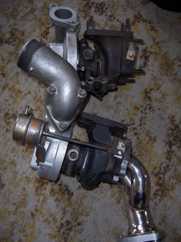

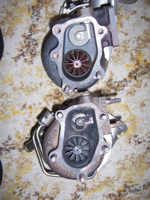

Taz_Rx Posted October 15, 2007 Author Report Posted October 15, 2007 Got a couple of turbos to choose from now! T25G on the right, R32 GTR on the left..... This pic show the difference in the dump pipe flanges between the 2. Have a GTR dump pipe on the way. T25G is the top one. Quote

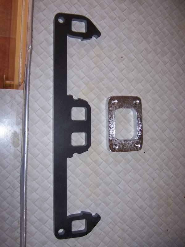

Taz_Rx Posted October 23, 2007 Author Report Posted October 23, 2007 PROGRESS!!!!...... My man with the welder is busy for the next 2 weeks, so its booked in for the 6th of Nov to have the manifold made. Quite happy with the manifold flange, turned out really well. Quote
madrolla68 Posted October 23, 2007 Report Posted October 23, 2007 Taz_Rx said: PROGRESS!!!!...... My man with the welder is busy for the next 2 weeks, so its booked in for the 6th of Nov to have the manifold made. Quite happy with the manifold flange, turned out really well. So are you gonna take the car down to him!!!!!!!!!!!! Quote
Taz_Rx Posted October 24, 2007 Author Report Posted October 24, 2007 Yeah I'll toe it down the day befor (public holiday). Just to make sure everything clears etc. I want it sitting behind the engine mount here. Quote
madrolla68 Posted October 24, 2007 Report Posted October 24, 2007 Taz_Rx said: Yeah I'll toe it down the day befor (public holiday). Just to make sure everything clears etc. I want it sitting behind the engine mount here. Ok ,are you going to have enough height to allow for the oil drain back,i had a small issue with mine and mine is higher than that. Quote
Taz_Rx Posted October 24, 2007 Author Report Posted October 24, 2007 yeah mate should be cool. The turbo is just sitting on the cross member in that pic, with a jack under the dump pipe, so it can actually come back up as far as the manifold will allow. My oil return is right up the front of the sump at the moment, so I'll put a new one in a different sump back up near the turbo. Might even get some wanky speedflow fittings. :) Quote
