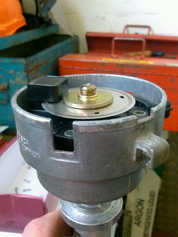

Taz_Rx Posted November 23, 2014 Author Report Posted November 23, 2014 Just tested custom cas mk2. Nice steady pulse from 47 rpm! Will get some pics of the new unit and another test vid up soon. Quote

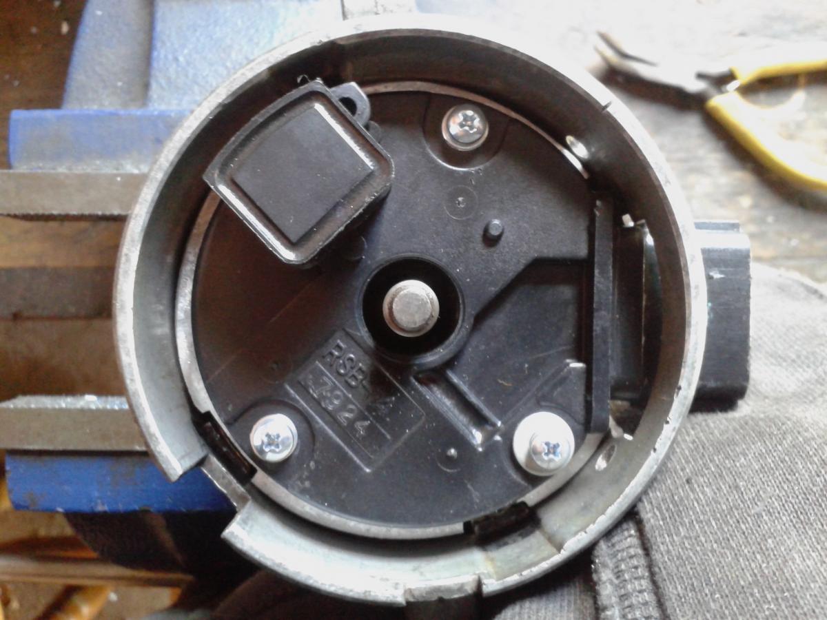

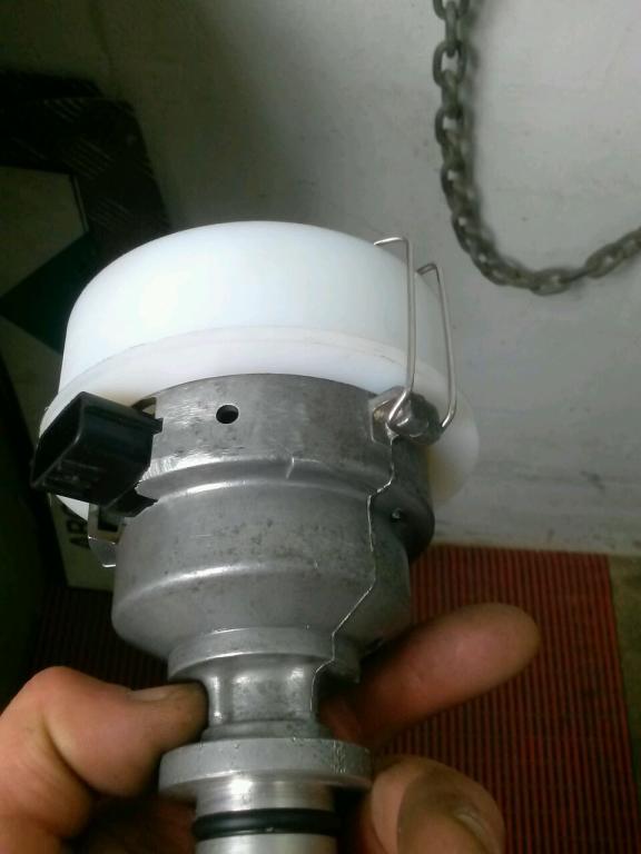

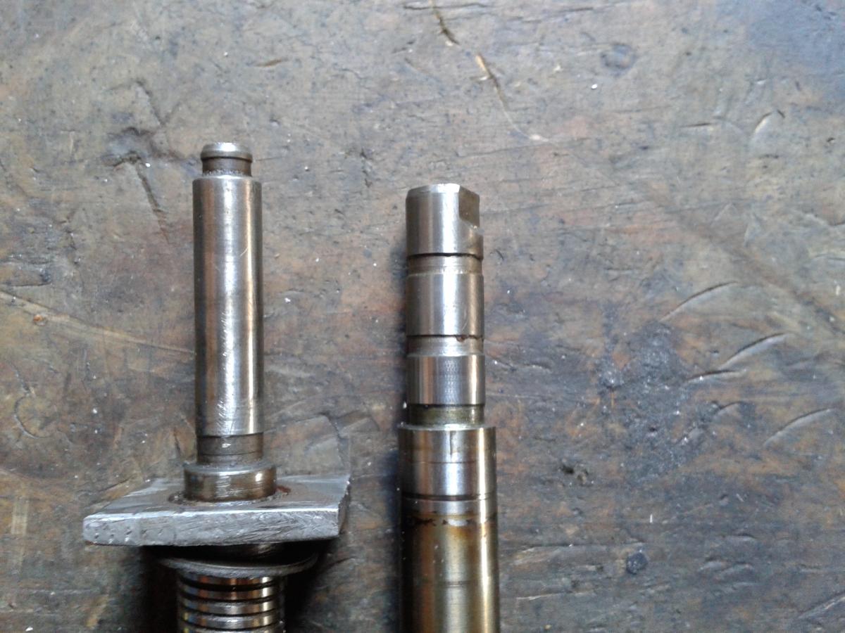

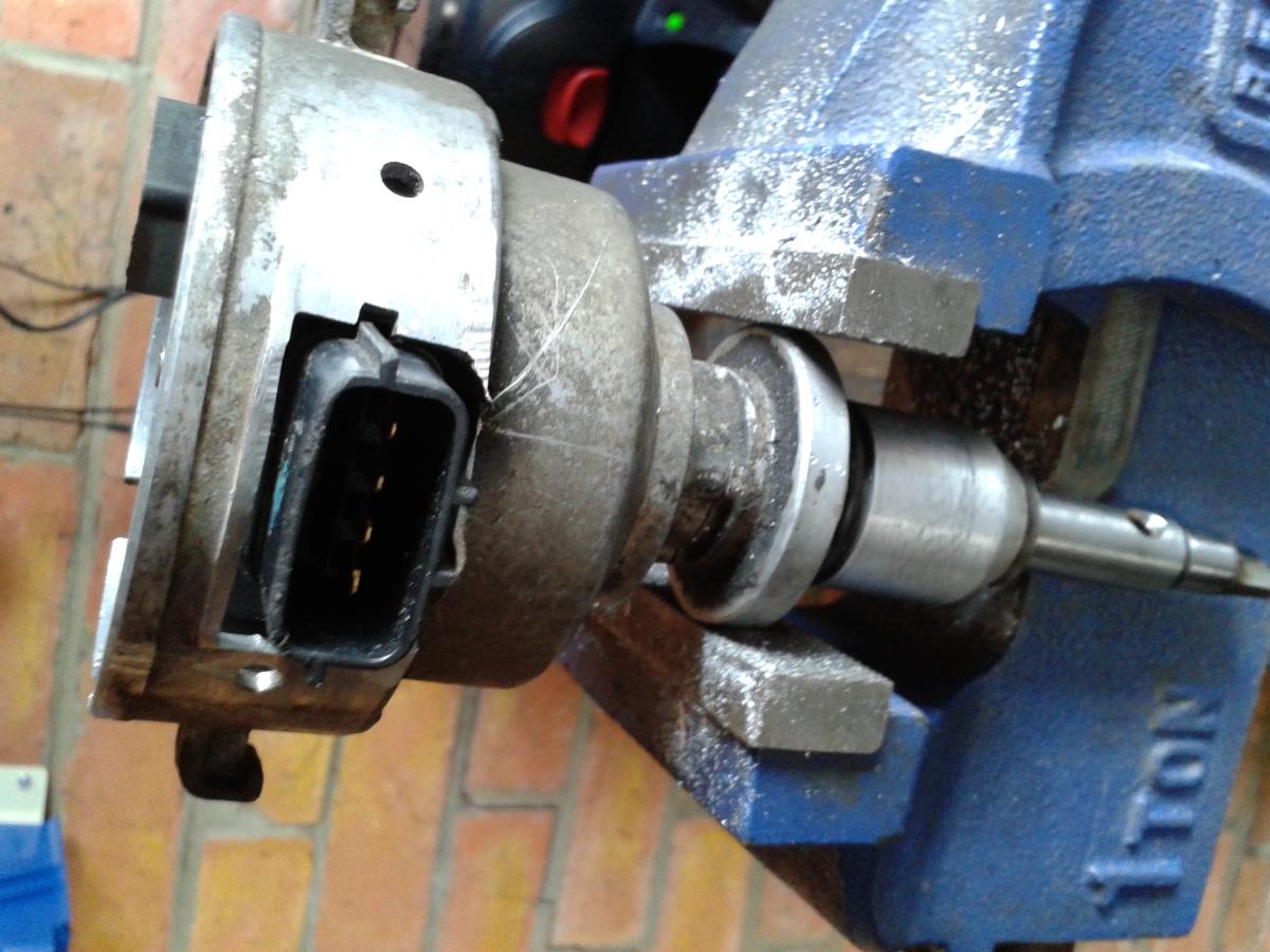

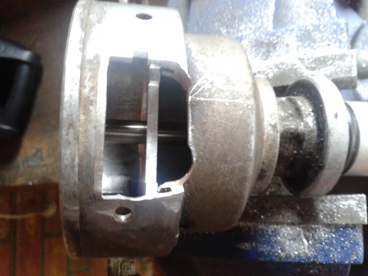

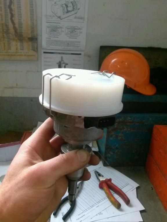

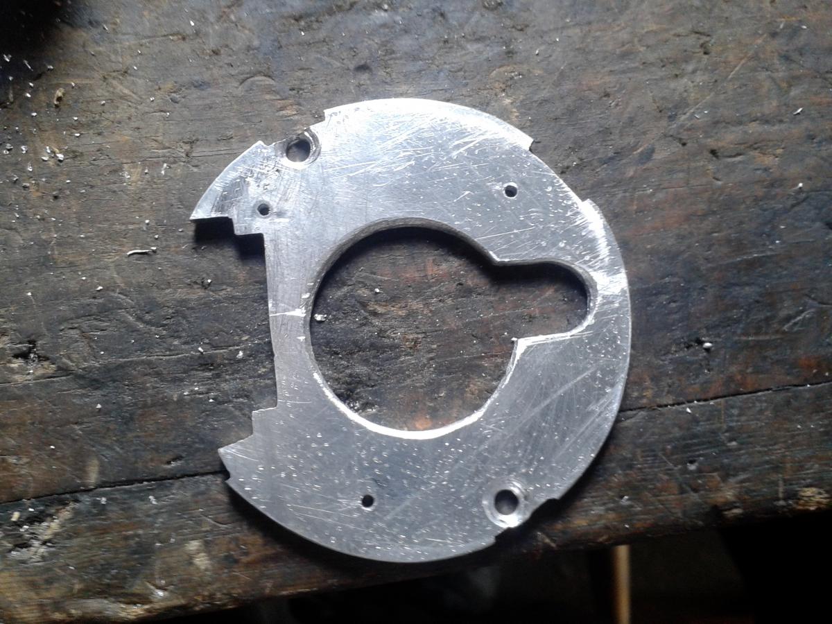

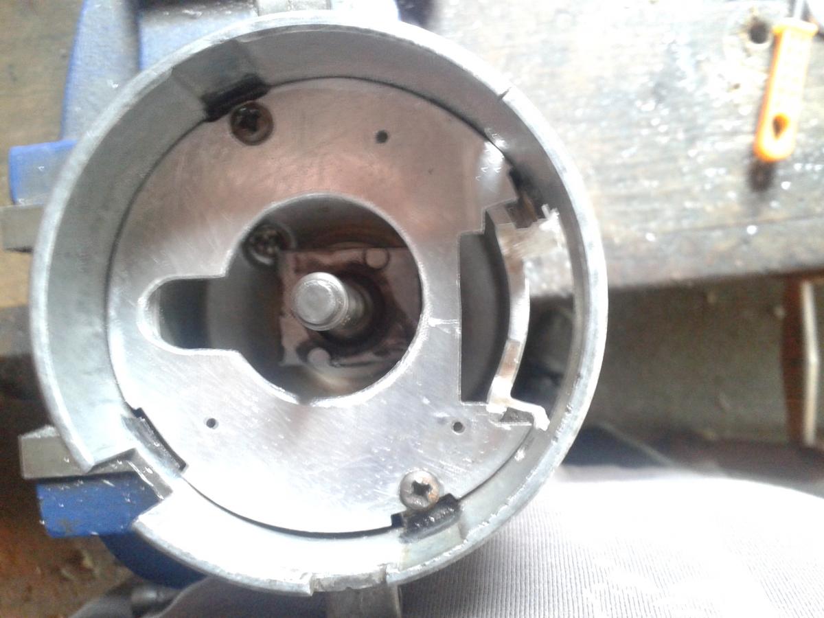

Taz_Rx Posted November 24, 2014 Author Report Posted November 24, 2014 So hacked a big hole where the vac advance diaphram attaches.... made up an adapter plate to mount the sr20 sensor... it screws into the holes for the vac advance plate... then gave it to a fellow rolla owning machiner who welded the top of the sr20 shaft to the k shaft at the right length..... he also machined up a teflon cap for it. i might paint it before final assembly..... Quote

Medicine_Man Posted November 24, 2014 Report Posted November 24, 2014 that is a pretty cool idea, looks like a perfect fit.. Quote
Taz_Rx Posted November 24, 2014 Author Report Posted November 24, 2014 that is a pretty cool idea, looks like a perfect fit.. Yeah when you look straight down into the top of it it almost looks like its supposed to be there. If I made another one (maybe when we make one for Leigh lol) there's a couple of things I'd do slightly differently which would make it a little tidier, but overall I'm pretty happy. Especially when all I really paid for it was $50 (for a complete sr20 cas) and a 6 pack for the machining! :D Quote
