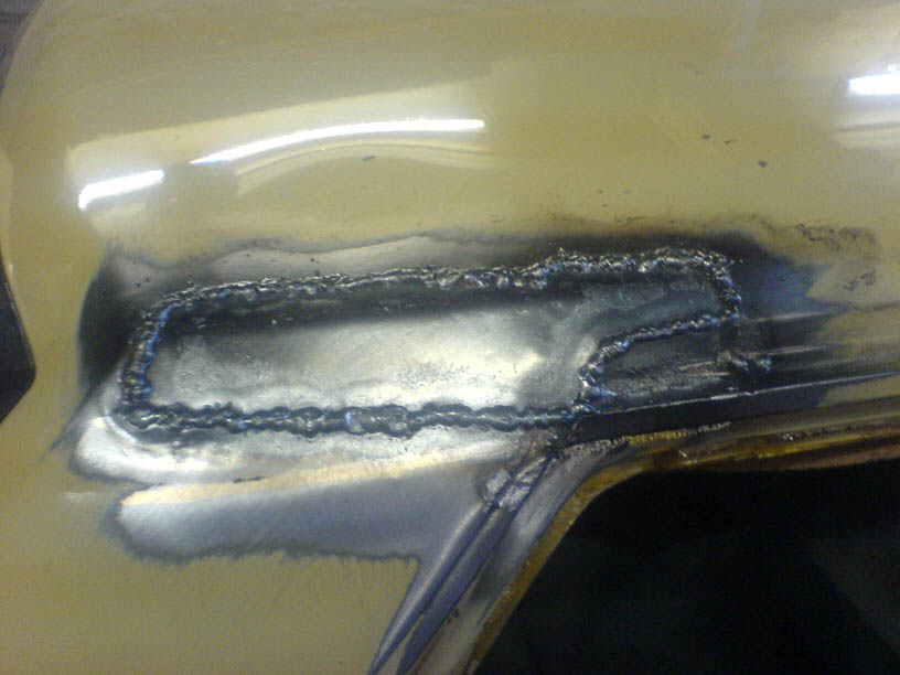

turbo_rolla Posted June 14, 2008 Author Report Posted June 14, 2008 Bit of work done since last post - the rust has now all been cut out and replaced and bogged - that was last weekend. Is currently sitting outside with the primer drying before i do a quick top coat, so thought i'd update the post while i had some time :cool: Probably better just to put it in pictures! This was the main bit and what she looked like after it was all cut out and taken back to bare metal :( First part of repair welded in: Full repair welded in: Neil cleaning it all up (not bare metal guards): All cleaned up: Bogged and sanded: Primered and drying, as of about 45 minutes ago: Also repaired a little bit around the bottom corner of the rear windscreen: Also did fuel filler cap (that area, but on the body in the corner), but no pics of that - a LITTLE rough, but will do the job. Also took the front guards back to bare metal and bogged again :y: Just giving it all a spray pack job at the moment until i've got a bit more time and then we'll do it properly (the front guards atleast, as the rest are only smallish spots and can probably get away with spray pack). Just wanted to get it all primered and painted for now so it doesnt rust more :y: Gotta give a HUUUUGE thanks to Neil and his dad, who really did the majority of the work - his dad did the welding, neil did the cleaning and tidying up of it all, and i mainly did the guards and some sanding (kept it to that as i didnt wanna f$#k up their good work :lolcry: ). Anyway, should be dry now so off to paint :cool: Quote
