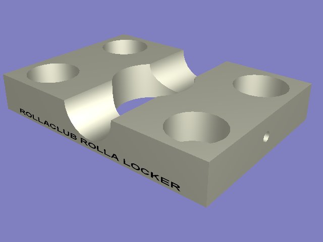

Ok didn't have a spare corolla diff this arvo but I had a spare 1929 chev diff center so I have drawn a locker to suit it to give everyone a rough idea of it.
This unit is 70mm long and 50mm wide and 11mm thick. The spring holes are 15mm diameter and the springs will locate into them tightly so will be drilled to exact same diameter of the spring. With two of these unit compressed into the diff center there will be a 2mm gap between both plates around the spider shaft.
Now or spring length. The holes are at a depth of 8mm So 8+8+2=18mm. This is how long the springs will be when compressed. As this part is pushing out on the spider gears so it wont go in so the 2mm gap is ample. But remember this part above you need 2 of and springs to make the locker and this one is for a chev 1929 diff so don't go out and get one made for a rolla WONT FIT. As that is a demo.
When ordering springs they want to know the tension at what length. So If I order springs 20mm long with 2mm compression I will need 70lbs. If I get 20mm springs I want the point where this unit will sit at close to there so assembly is easier and you not having to compress it say 10mm and springs are cheaper and there will be less chance of coil bind.
So if the corolla housing will allow for it the springs in a KE20 clutch will be the right length for the job :lol: So if I can get 2 piece of scrap metal and a screwed rolla clutch I think I could make one of these for free to say $20 for the prototype. As there 23mm uncompressed so if I can get one in a vice and they compress say 5mm before bind I can use them as with a 2mm compression in my design they will be miles away from bind.
If this is possible to avoid making them with out buying springs I could make the blocks and buyer gets own springs or if they want really hard springs for racing i can put them in the direction of the maker for some one offs.
Also for assembly in my design I have placed holes in the blocks to slide in bolts and over the bolts place some flat bar. So you can load springs clamp in vice slip metal over bolts to hold the unit shut slide whole unit into diff and then pop off metal and remove pins locker will release and presto easy install ;)
Also if you don't remove the pin or bolt from the hole if you assemble this way your diff will blow and jam if pin falls out so remember to remove it!!!
Cameron
