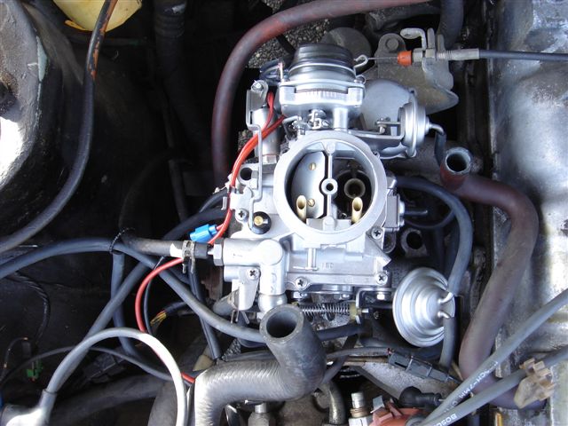

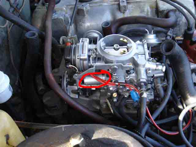

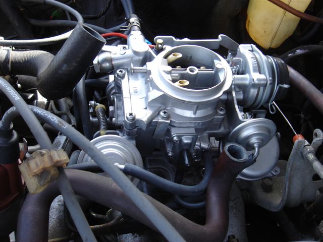

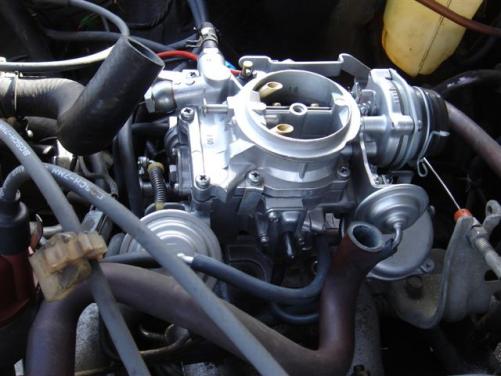

jovan Posted November 5, 2006 Author Report Posted November 5, 2006 have you got a pic of the car/carby?does it have all those vacuum hoses and emissions shit? coz it could be one of those.... shame your so far away, can't come n have a look :jamie: I'll get a good pic of it today. Yeah, it's got tons of vaccum lines, but no real emissions to it. Its an Aisan model 26353 (2BBL). I'm picking up the intake gasket today, and I'm just going to try and start from scratch again. So many vacuum lines though! Quote
jovan Posted November 5, 2006 Author Report Posted November 5, 2006 Here's a couple pics of the carb and one of the car Quote
love ke70 Posted November 6, 2006 Report Posted November 6, 2006 do you have a diagram for the vacuum lines? if not your not gonna get very far, may have to try track one down... i don't think my one for my 4k ke70 is gonna be the same.... is the carby tuned properly? also another thing to try is there may be some shit stuck in the jets that makes it run like shite. try revving the motor up and then jamming your hand over the throat of the carby to create massive vacuum and draw the shit out...its worth a try... Quote

jovan Posted November 6, 2006 Author Report Posted November 6, 2006 have you tried the fuel shut off valve, make sure you have 12V to it & when you disconnect it the engine will run really bad or not at all (under 2000rpm) yeah, I actually replaced it when the car first started to run like crap. The one in the pic is brand new. It's my factory carb in the pic, but I just got it back from getting it professionally rebuilt/tuned/and cleaned. I'm about to head outside right now to replace a few gaskets. I'll check to make sure I'm even getting 12v it. Quote
jovan Posted November 6, 2006 Author Report Posted November 6, 2006 also another thing to try is there may be some shit stuck in the jets that makes it run like shite. try revving the motor up and then jamming your hand over the throat of the carby to create massive vacuum and draw the shit out...its worth a try... I can barely make out the diagram from the sticker under the hood (but it's crappy...and VERY confusing) For some damn reason it isn't in the factory manual!! I was hoping someone would read this and happen to have a good vacuum diagram for a 2TC... The carb is supposed to be properly tuned. The rebuild company I just got it back from tests them on before they send them out..and mine did smell a bit like gas when I got it back, so I'm assuming that it's tuned in pretty close (or at least close enough to start). I'm about to go work on it right now. If I can get it running, I'll try your idea about cleaning the carb out. Thanks! Quote
