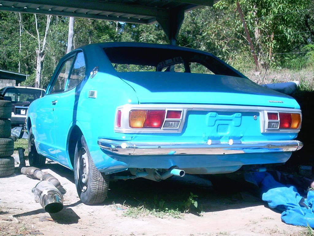

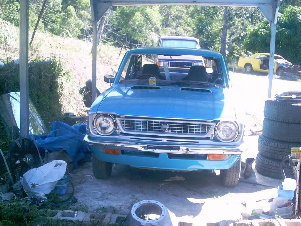

oh what a nissan feeling! Posted May 4, 2007 Author Report Posted May 4, 2007 Its been a long time since i started this, but with the ke30 lunching itself, i got delayed a fair bit, now the ke30 is going strong again, the little blue beast is nearly finished! :cool: http://i161.photobucket.com/albums/t235/sr...me/PICT0636.jpg http://i161.photobucket.com/albums/t235/sr...me/PICT0635.jpg http://i161.photobucket.com/albums/t235/sr...me/PICT0634.jpg http://i161.photobucket.com/albums/t235/sr...me/PICT0633.jpg http://i161.photobucket.com/albums/t235/sr...me/PICT0632.jpg Just waiting to get the new hood lining to get back, and i can put the glass back in and drive it! :S I still havnt ordered my venitian yet, but i have some mazda rims with trim rings and centre caps, just have to get the white walls on them. and it should look pretty nice. :hmm: Quote

st.nick Posted May 6, 2007 Report Posted May 6, 2007 Top marks for the colour!! Looks damn awesome!! Quote
Jono Posted May 6, 2007 Report Posted May 6, 2007 i was going to go BMW Laguna Seca blue eventually, like the e46 m3 colour, but this is way similar. How much was this per litre? Quote
HEKTIC Posted May 6, 2007 Report Posted May 6, 2007 hey, just out of curiosity how much paint stripper did it take to do the whole car? and Does it dissolve bog aswell? Quote
Corolla_Kid Posted May 6, 2007 Report Posted May 6, 2007 nice colour very similar to mine. Light blues look great on ke2*s Quote
radrollaz Posted June 8, 2007 Report Posted June 8, 2007 Mate that looks great, that blue suits it perfectly , theirs nothing like doing it all yourself well done. Go the KE25's :wink: Quote
oh what a nissan feeling! Posted June 9, 2007 Author Report Posted June 9, 2007 Wowsers, i never saw these replys last month, probably a bit late now, but the colour was $85 per litre and i used 3, plus 4 litres of clear, it is all 2pac clear over base, because i am set up for 2pac. It was a phase 4 colour on the charts because of how much green pearl it has in it. hey, just out of curiosity how much paint stripper did it take to do the whole car? and Does it dissolve bog aswell?I used 3 litres of paint stripper, this can vary heaps though depending on how many coats of paint the car has on it, i did a celica once and it took 8litres! nice colour mate! is that zorst laying next to it going on? looks pretty massive though... lol nah, thats off the green one, it 3" so yeh it is a bit massive for the 1300. Quote
