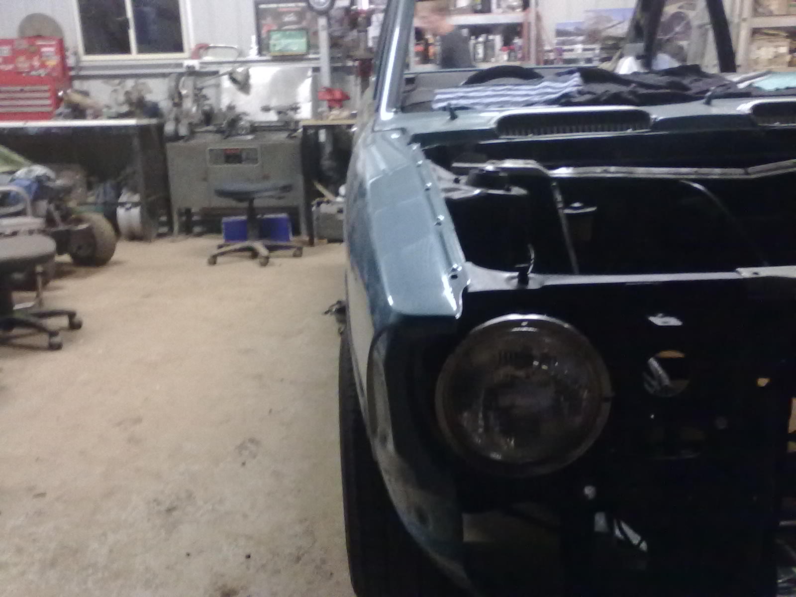

  11. Fly wheel all cleaned up. Not lightened. Keeping the low end torque. New spigot bush. Interesting way of removing it thanks to dad. Pump the hollow behind the bearing full of grease and use a punch the same diameter as the internal bearing diameter. Wack it good. Made the punch on the lathe and it doubled as a makeshift clutch locator. New throw out bearing in the gearbox. Got it all together thanks to Nick bro. Removed and redrilled the gearbox crossmember to suit the ke70 5 speed. Dropped the donk and gearbox in, Fitted the started motor, hooked up the clutch.... needs a new clutch cable. There isn't a great deal of clearance between the harmonic balancer and the sway bar. The back end is still in question. Looks like it'll be a total fabrication job. I've got the ke20 wheel bearings for the 70 hubs so I should have the front wheels and brakes sorted out shortly. Here's some picatures.

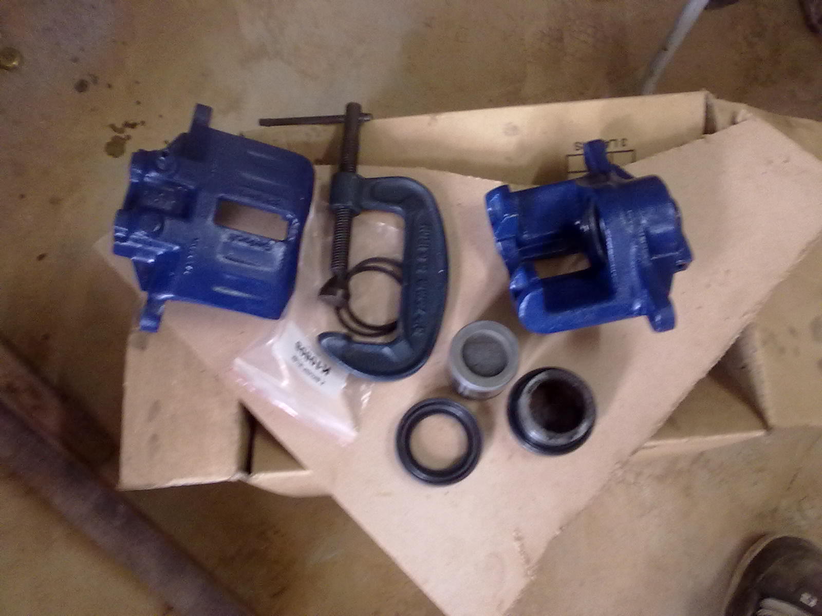

    My Ke20!
