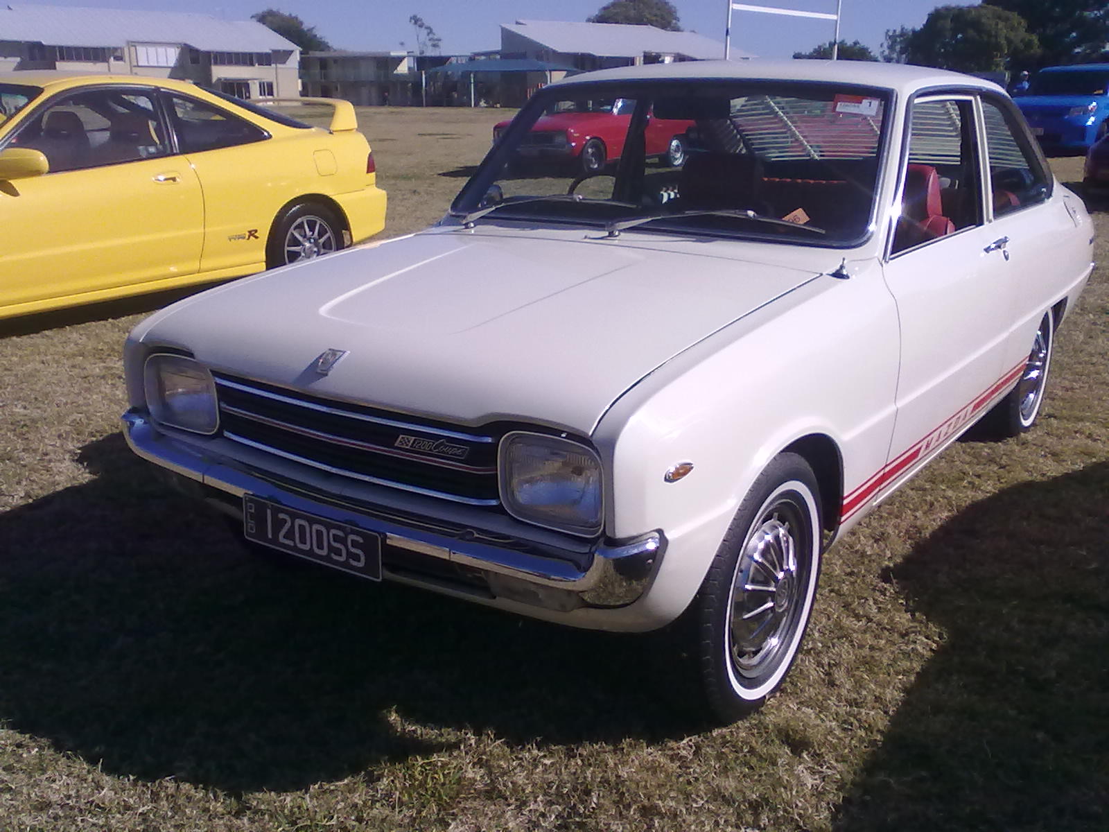

  5. Very good turnout I thought, considering this was my first ever visit. Just a couple of lazy snaps I got today, not all Toyotas. The sun was bright and there was not a cloud in the sky. so my camera phone didn't perform to well. Some you may recognise. Feel free to add your own pics. :happy:
