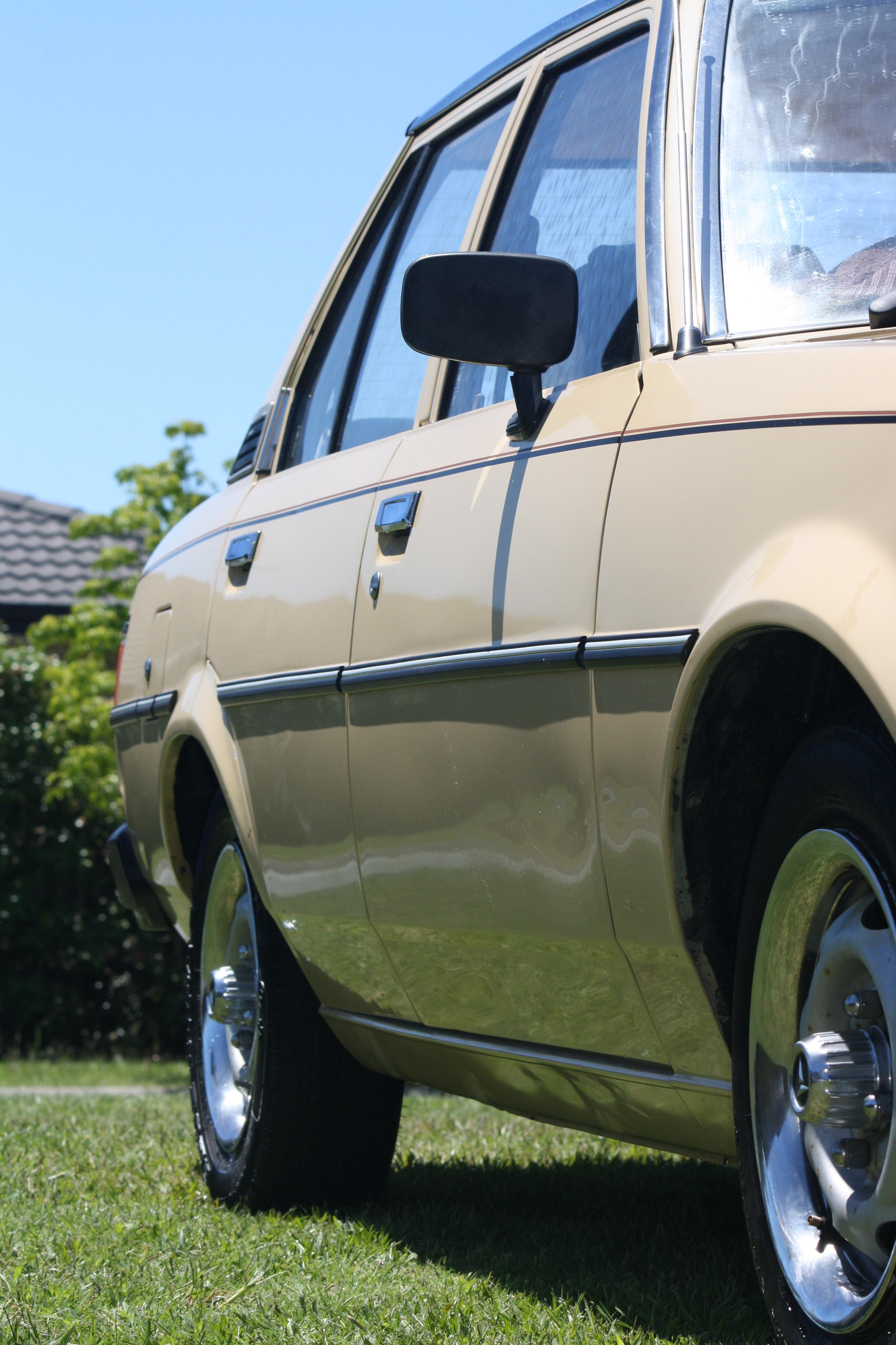

  22. hey guys heres some pics after putting king springs in and all new shocks just bout a new product to give it a clean and came up a treat got it from these guys http://www.fullnoise.net.au/featured-products/lucas-slick-mist-speed-wax-710-ml-interior-detailer-710ml-tyre-and-trim-shine-710ml-spray-bottles-kit-of-3.html just bought a second motor to rebuild and put my twin su's on and maybe supercharge it
