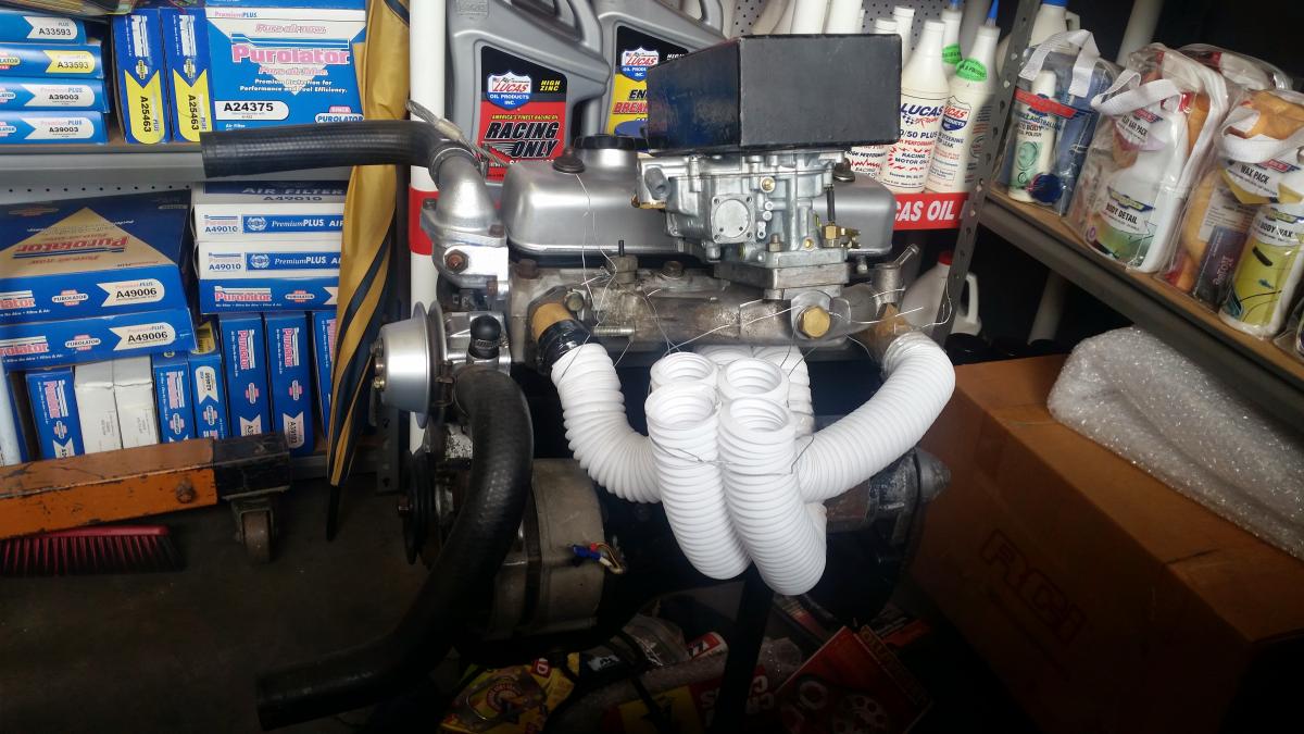

  1. Cheers mate yeah that will be the plan. I also tried fitting to the car and the turbo hits the strut I need to move it further forward and up a little higher that is today's task :)
  2. Ok I have done the other 2 pipes now. and made a bracket to hold the turbo (for mounting reasons only) I will now take the turbo and bracket to the car with engine still in there to make sure it fits. I have a feeling looking at it however it wont fit and will have to make adjustments but that is ok. I have also drilled and tapped in the oil return line into the timing chain cover. I think this will work nicely.
  3. Ok I know I haven't made any update for a while now have had a bit going on. I will get this up to date soon. Today i stared to mock up the exhaust manifold pipes to the turbo. now before you all laugh yes its plastic pipes and cardboard once I have it where i want I will take it to the exhaust shop and get them to make it up for me.
  4. At this stage nothing to the carb thats why I bought a new one so it should seal quite well. I will be using a stock exhaust manifold and making a Jpipe off that which i kinda have half done already just need to check the mounting position before finalising. Yeah i will keep the photos coming as i do things to the car mate.

  9. on the weekend i got a few bits installed. Cam new cam chain and gears new double springs. its coming together now. next step is to get the j pipe finished and make up the oil and water lines for the turbo with a custom return plate for the oil where the original fuel pump came from. any one has any suggestions please share as I am only fumbling my way through. :)

  13. Hi all thought I would start a bit of a thread here with my rolla. I bought the rolla about 5 years ago now and had been driving as a daily until i had a work car so started to do some work on her. I pulled the motor out and did a rebuild myself (lots of learning). Tried various combinations of carbs from stock to weber also tried twin SU's worked great but my cam was to lumpy so did not work so well at idle. Anyway moved to Sydney and the car stayed here in QLD and unfortunately had to be stored outside and very quickly grew rust and was not quite the same. However I have now moved back to QLD and have decided to get it back on the road and make a project out of it. I am going to keep the k motor but make it a turbo blow through set up.
