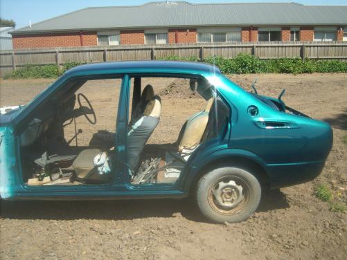

So i finally bit the bullet and bought some paint, its the mystic green pearl off the new falcon. This is the first car i've painted so i just took my time and it come out pretty nice! It looks awesome in the sun
