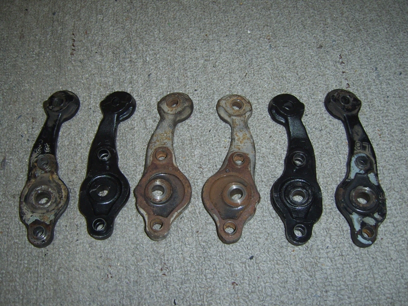

  7. After some steering arm dramas as some people will know, I have finally got the new suspension in. Quite a bit lower than it was before, Still need to get the exhaust raised a bit as its the lowest point on the car since lowering it.. Took it for a test drive and it feels miles better, was partially to clean out the oil the f@$kstick mechanic put in the exhaust for shits and giggles..
  8. Good to hear that this is running :P
  9. He's actually taking the piss out of teddy as teddy wanted to take it down there last year but nothing went right at the last moment..
  10. if i got a photo with teddys stock ae86 steering arms beside them you would see the difference..
  11. i somehow magically have shorter arms that fit a ke70 now though... :cool:
  12. Inner ones are AE86 P/S arms (L8, R8), Outers are standard KE70 (L6, R2) , Middle are the unknowns (L1, R1)...
  13. Outers are KE70 standard items off my car, went to put my ae86 struts on with the inners that are supposidly ae86 p/s arms but they don't fit the ae86 struts. they bolt up to the ke70 standard struts fine though and are shorter.. anyone come across this before?
