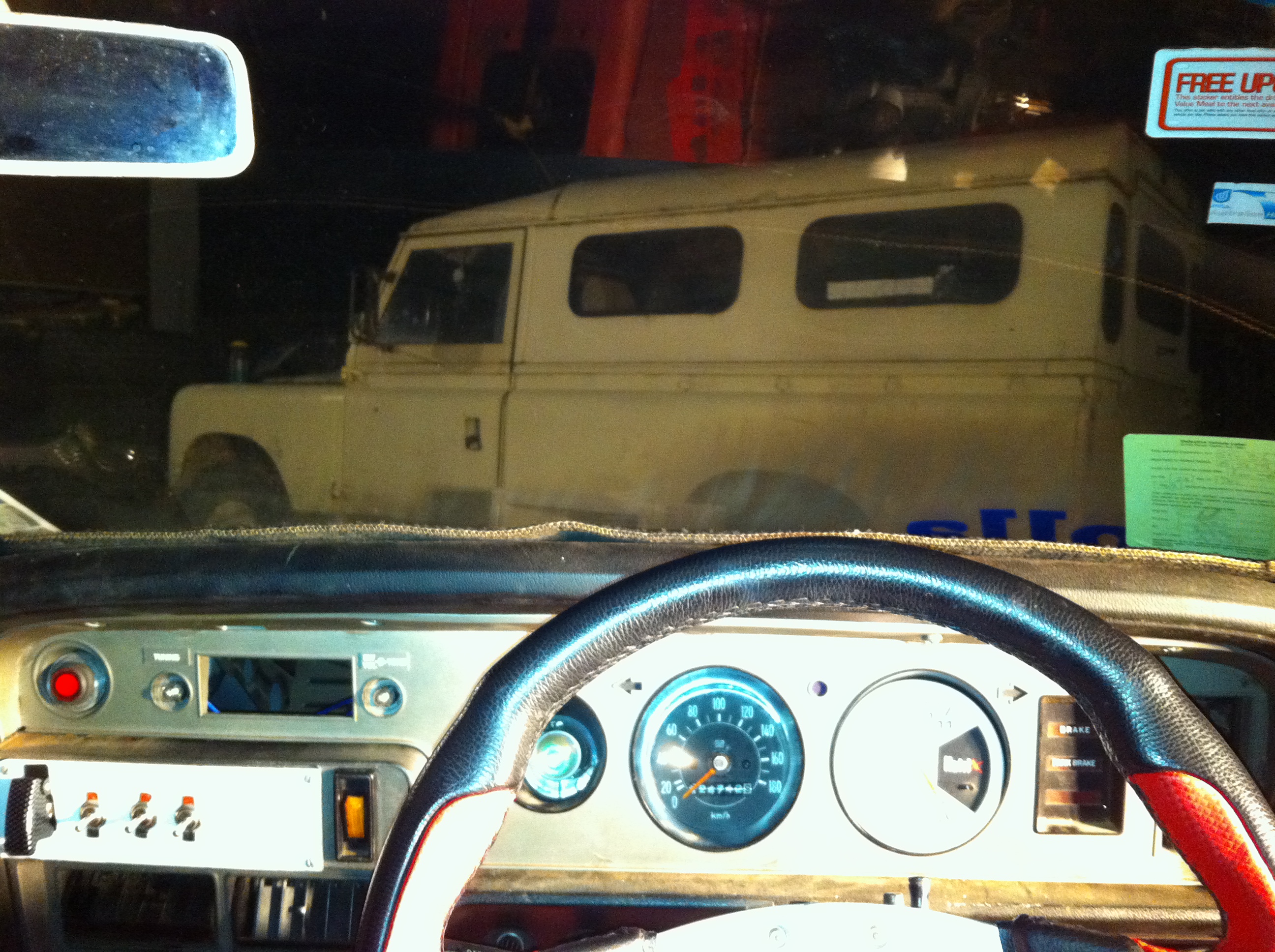

Here is mine and a mates project rally car. Weve only just started the build but would appreciate comments and advise and hopefully we can provide some useful information. Hope you all enjoy following us on this build. Started with: 1980 Ke55 Two Door Coupe 4K 5 speed manual Hope to end up with: 1980 Ke55 Two Door Coupe 4AGE 5 Speed maunal Roll Cage Conditioned for rally events Its a long way to go but here it is as it stands......... Body is coming along slowly but surely, planning on re-spraying origional colour. Interior is coming along nicely. Rewiring well on its way, Push button start, Dash modified to incorporate tacho and shift light. Engine swap havn't started but we are picking up the 4AGE & T50 tomorrow thanks to junior#02. Hope you like what you see, much much more to come.
