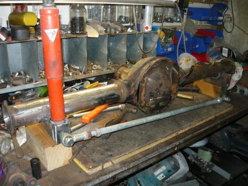

  11. Seeing as this will be my wife's new car, it makes sense that she is hands on with the build. Fitting the Mini Spool. Then fitted the center into the housing. Tension up the carrier bolts. Then added a mount for the Panhard rod.
  12. Ok so today we continued on the diff upgrade. We are using a Borg Warner 28 spline diff out of an R31 skyline. We used an auto one as they are lower ratio. 3.9 : 1. Finished off the mounts. And then checked the alignment. And then on to assembling the center.
