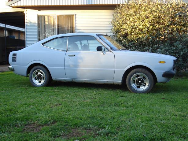

  18. I Did a bit here and there this morning, replaced the wheel cylinders and fully bled out the brakes. I can now lock the ke up with ease, it pulls up very nicely, have a heap less pedal travel also. Upon pulling the old cylinders apart I found they were pitted and rusted. Also I replace4d the rubber fuel line under the car, it was split and weeping, did not realise that pulling the line off would syphon the tank! so I also had to disconnect it inside at the tank as well. Pics of it on the lawn, looking heaps better!
