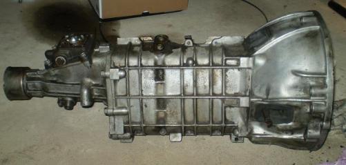

Xany - Its going into a 73 KE-20, yeh if you have any info for it it would be awsome, cheers tojo2 - i've been told i can use th original cross member and just move it back to some pre-set provision holes. i'll find out when i give it a go this week, haha. all i'm now hunting for is a shifter, so hopefully i can get one somewhere without buy th whole bloody box. can't get hold of th guy i got the box/engine off tho, but i start hunting down th TA-22's at wreckers, hopefully i get lucky! cheers -

yeh looks like i hit a little bit of a jackpot with this one. bet th young guy who sold it to me would be spewing if he found out what he was acturly selling, he sounds like me, no idea until now, haha. i did get it all for pretty dirt cheap! gota have a win occationaly! thanks heaps for the info guys, really appreciate! now i know why i was having trouble hunting down mounts to match when i was looking for k-50 stuff cheers again -
hey all i was sold this gear box saying it was a k-50, however after having a few mates look at it, no one can really tell me what it is! it looks like a T-50 with a bell houseing K-T the gear box bolts up fine to th K-5 engine, and the drivetrain from the auto that was in the car also fits the output shaft of the so called k-50. could someone please confirm what this box is, and if it is a t-50 or k-50 what do they come out of, since i have to chase down a shifter and box mount any help would be much appreciated thanks heaps Steve
