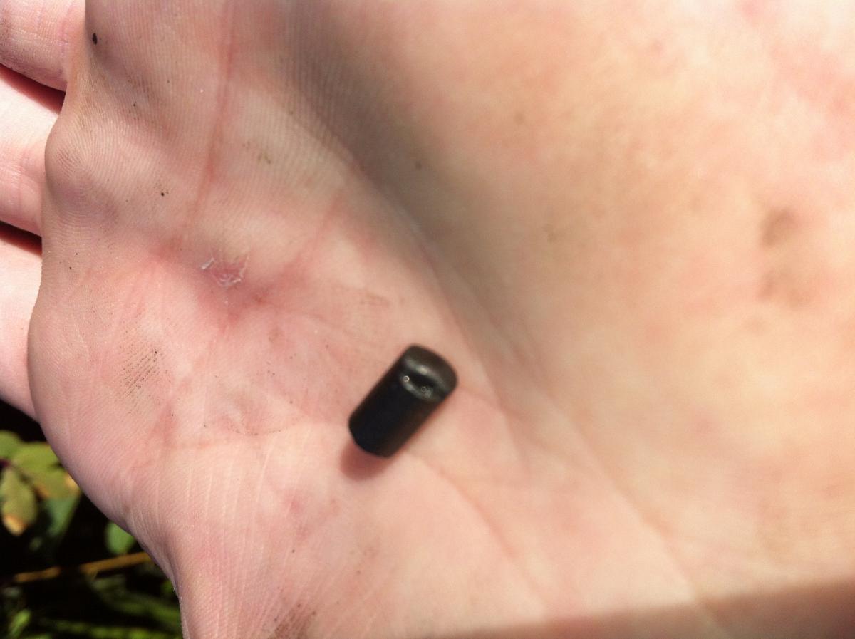

any idea what the black thing is in the pic? it was under the condenser, it was essentially just floating around in there i think...one end (end you can see in pic) has a specific extrusion on it while the other appears to have a rougher surface giving the impression its snapped off of something
Excellent thanks mate, always a great help! :thumbsup:
