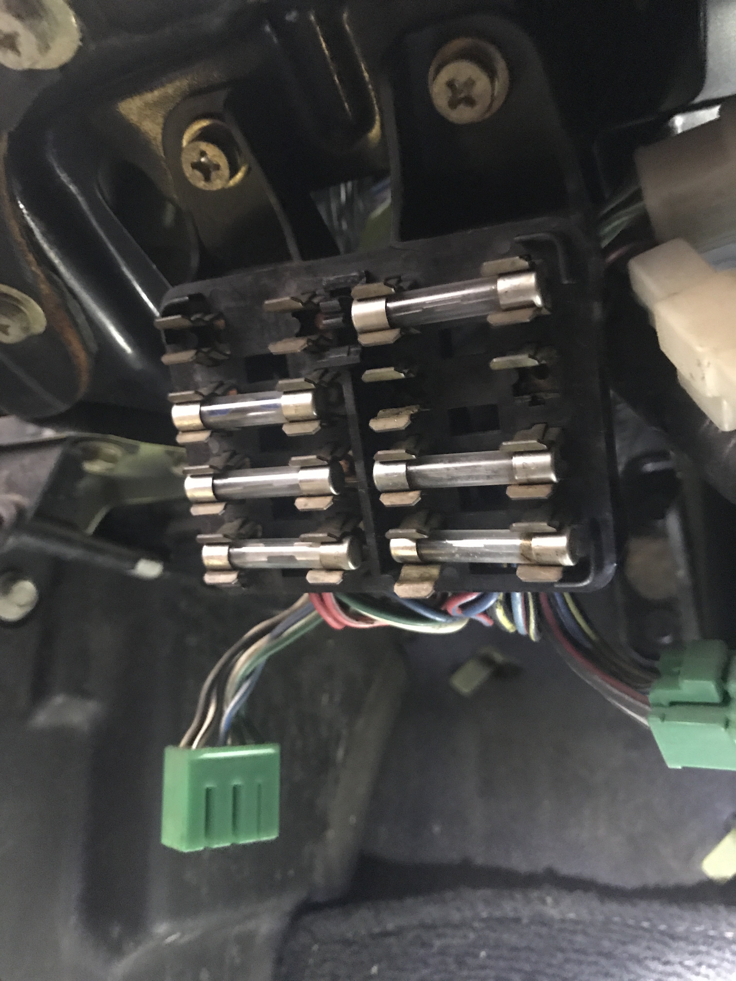

  5. Not as nice as the one in the picture but yes just like it. Found the switxh just need to find whwre where to buy it.
  6. Not as nice as the one in the picture but yes just like it.
  7. Found the neutral switch. Haven't messed with yet, though.
