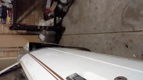

  6. So today I removed the spare tyre holder and put a new sheet of steel in there ready for the boot mounted radiator and fuel cell and also cut more of the body away so the rear diffuser can fit in
  7. I chucked the fender back on the car and I thought lol that looks random as f*#k but any way it will look cool once its much lower and bigger rims ....... I hope lol
