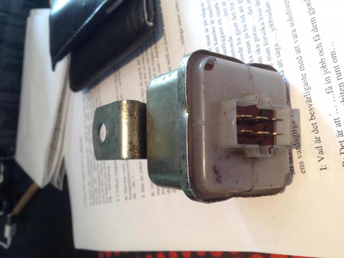

  13. Well the mark is polished away but if someone can recognise what it is on the picture we can solve that. But I guess what ever it is I still need to get it to someone who can test it more then I can with a multimeter?
  14. Thanks for the answer! I think it most be the Bosch one, its connected with 4 cables, 3 of them together in a socket. And can't se any parts placed on it on the outside. Sounds like a plan, Will take it to a mechanic later today. Will be back with more info.
