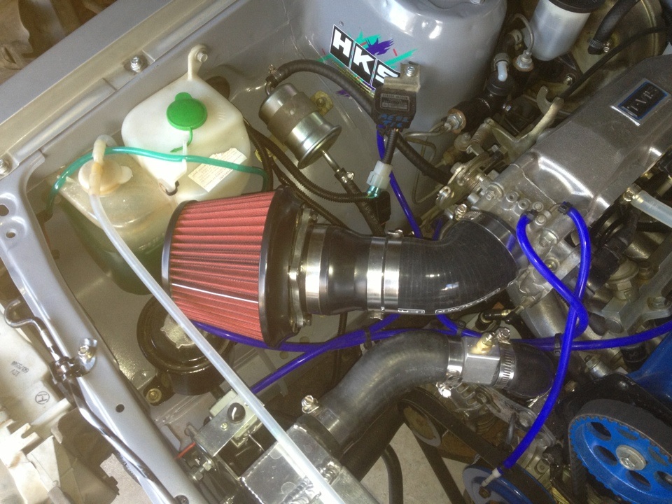

  18. So as the title says my car won't idol it starts then stalls, but a before I go into full detail ill give you all a bit more info on my car Ke70 with 16v 4age Motor and loom from ae82 corolla bigport first gen with map sensor I had installed the motor and had the engine running at the start of the year I even drove the car up the drive way but I had put the car in the shed and hadn't started it for a few months as I was fixing rust and working on my other car, But the other week I went to start it and It wouldn't start it would idol then stall! I have fuel at the injectors and fuel pump works fine it's a vn commodore in tank pump that I have modified to fit the ke70 tank I have checked all plugs! I have power at the coil! I have 12.63 v at the battery Then I replaced the ignition leads I replaced the dizzy cap I replaced the rotor arm I replaced the coil w/igniter module from a confirmed working car I have checked all wiring and plugs for loose terminals etc etc! I have two grounds from the battery one to the engine the other to the body of the car! I took the cam covers off to see how the cams were and there fine nothing has broken! So after all that and still nothing I thought the timing may have been out! so I set the cams to there timing marks I pulled the cam gears off to see if the pins were in the right place Intake cam pin was at 12 o clock Exhaust cam pin was at 5 o clock I set the no 1 piston to TDC And lined the crank pulley up with its mark then reinstalled everything and harmonic balancer mark lines up with the 0 on the lower timing cover I also removed the distributor and re lined up all marks on that and put that back in But nothing has changed it's still doing the same thing! It starts idols for a few seconds then stalls! If anyone has any ideas as to what is wrong with my car would be great or better yet if someone can come have a look at it would be even better its got me completely stumped! As to why it was running fine and then now it won't even idol!

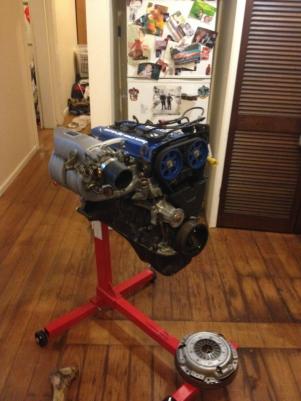

  19. Oh thanks guys, yeah I'm pretty proud of it, um as for suspension it's got pedders shocks and king springs, it feels good to drive but I'm now In the process of looking into suspension set ups for it, any ideas tips or thoughts on a good set up for street / drift would be great thanks
