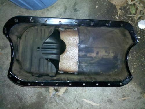

  8. my daily might not be so daily now.... twin 40DCOE webers 290/295 cam with .453 lift comp cams regrind. spool H beam forged rods ARP rod bolts 20" over bore pistons 11.63 compression dual valve springs roll master timing chain and sprockets special modded sump. the original flywheel has gone from 7.25kg to 5.5kg. 3k head with valve stem seal update full bottom end balanced block decked and honed exedy heavy duty clutch. crane cams xr3000 electronic optical ignition conversion, using 7M coil. regraphed distributor shimmed oil pump extractors redline dual carbie intake manifold redline filter socks (to be replaced with twin oval filters) rev's to eight...but only because any higher and the i risk cracking the block, if i have to rebuild again one day I will partial grout fill it, and it might need a bigger muffler. I thought the fact it only makes 70hp at the wheels would be a bad thing but it's one of the most fun cars i have ever owned. things on the do to list : new filters new exhaust. retune this video was of the old 5k that was in it, i was test fitting the carbie's and the electronic ignition. more vids to come along with pics
